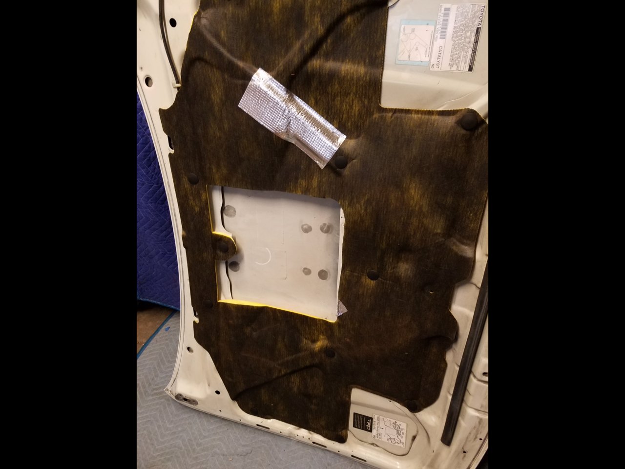

    Also got a new hood blanket and cut out the center section for the hood scoop.

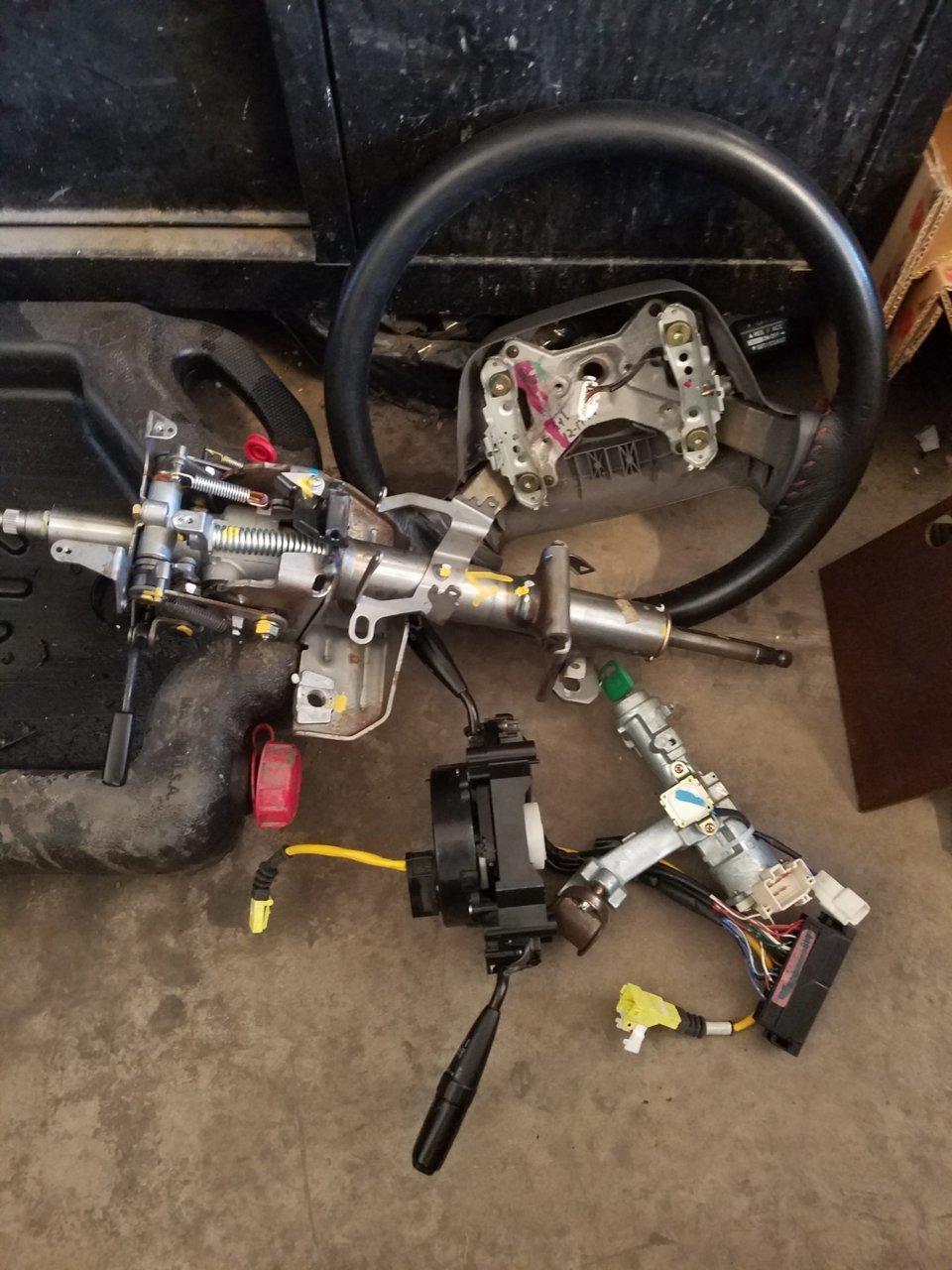

    Replace the complete steering column because the tilting mechanism was worn out and there was 1/2” of play north to south.

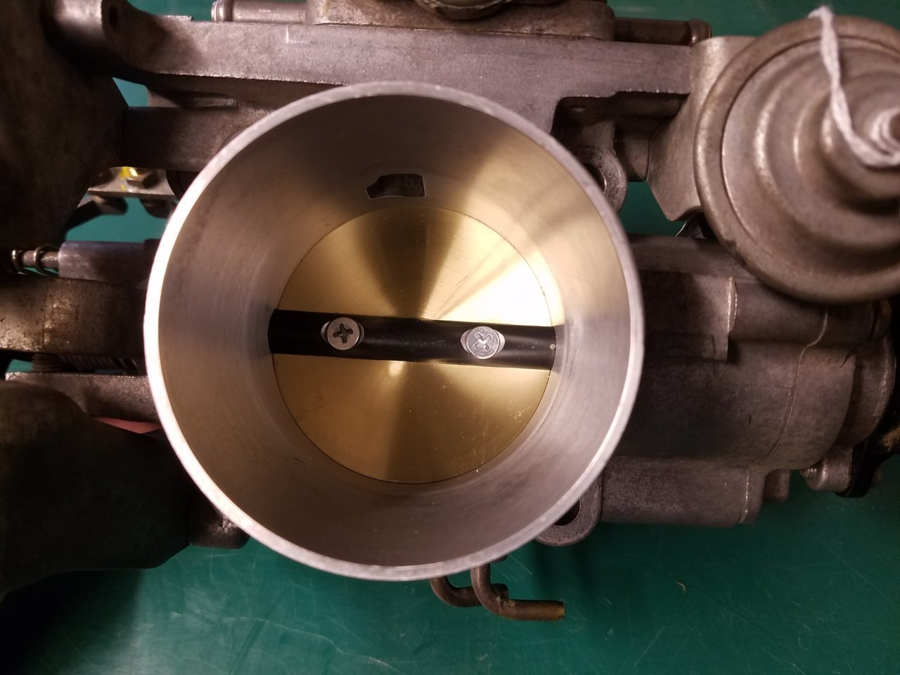

    Got the throttle body bored out by maxbore and a new butterfly.
    No gaps alone the walls anymore

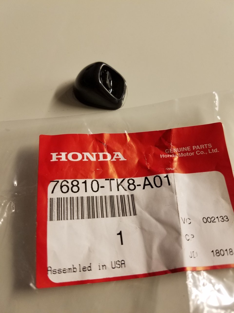

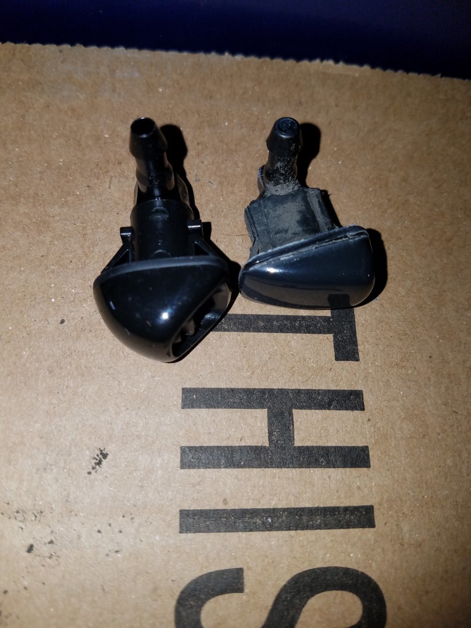

    Added these Honda nozzles last year for a nice spray pattern instead of a jet stream.
    They work fantastic, plug and play,

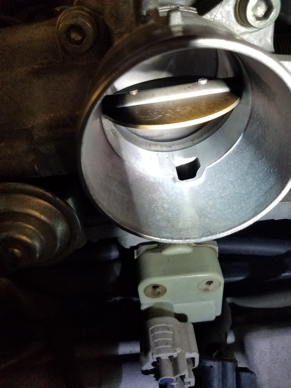

    Not sure about the ethanol.
    The methonal on the other hand raises the octane to 100-110 and cleans the inside of the motor and throttle body.
    No gummy stuff.
    Here is my throttle body before I had it rebuilt with no carbon and the valves with no carbon.
    Methonal removes all that carbon.
