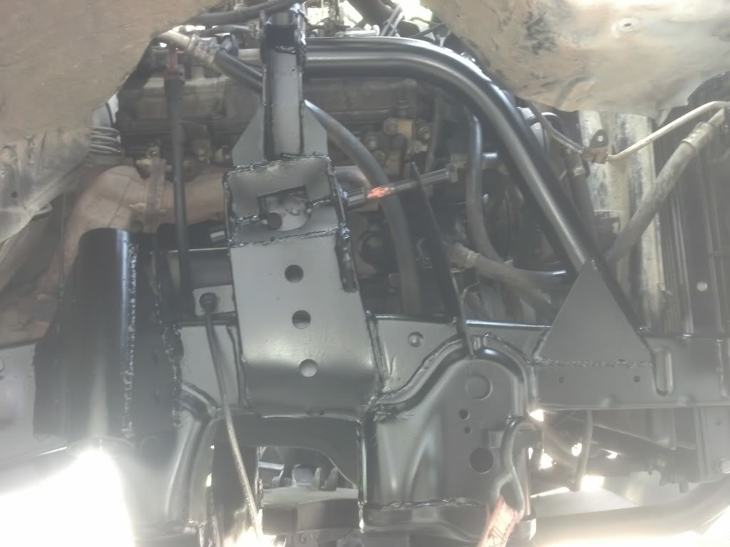

    call up TC. if my memory serves me well it's not that easy... pretty sure the upper arm is a slightly different design with the heims instead of bushings

    And yeah Anthony I agree we will be boxing the frame mounts at the same time. Thanks for the help dudes :thumbsup:

    Good luck welding upside down on the mounts haha.

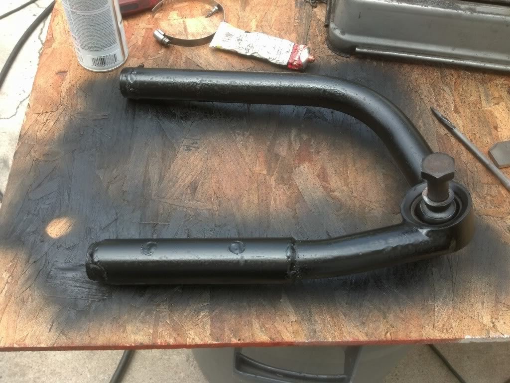

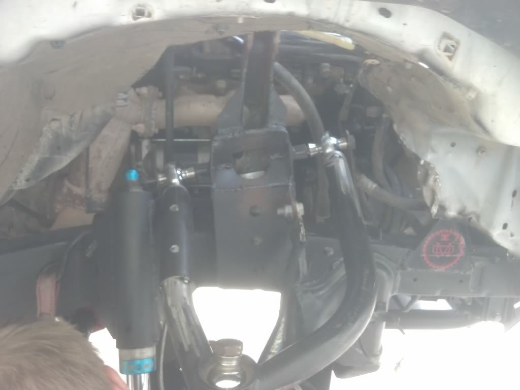

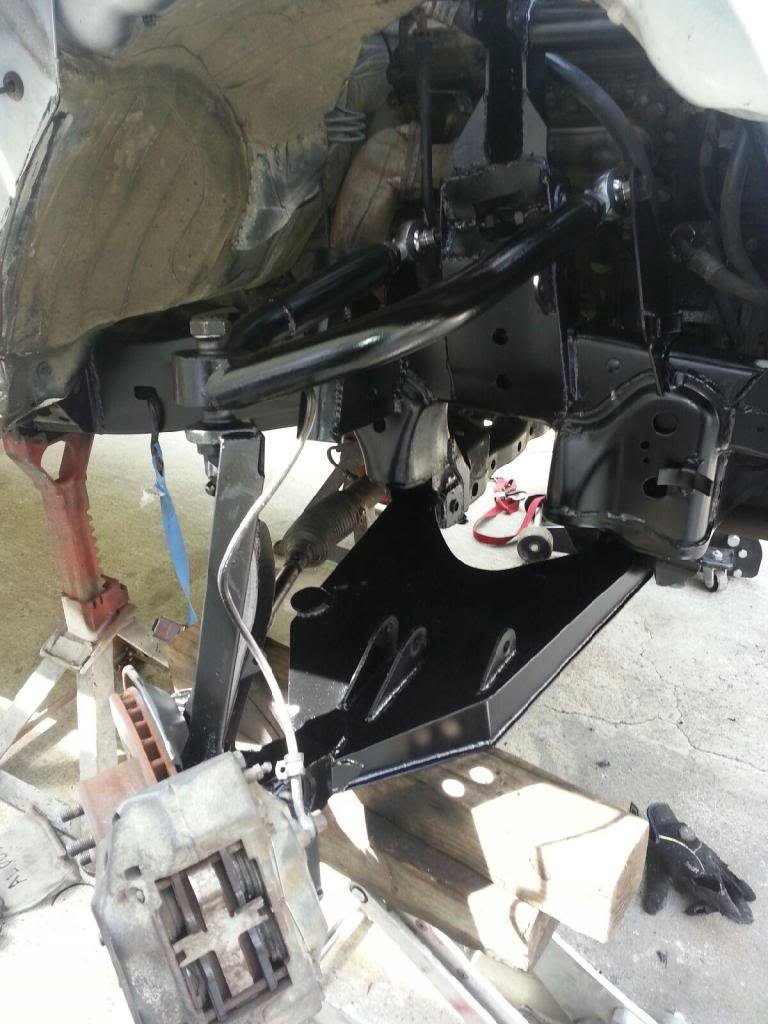

    Damn, that thing looks wide! But i like it! What exactly is point of heiming the inner uca joints though? There shouldn't really be any forward motion there.

    To solid mount the lowers, and for added adjustment

    I am happy with the width haven't had any issues fitting through any trails.
    Exactly :thumbsup:

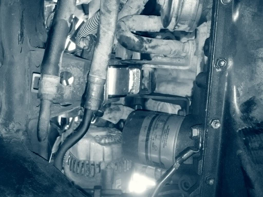

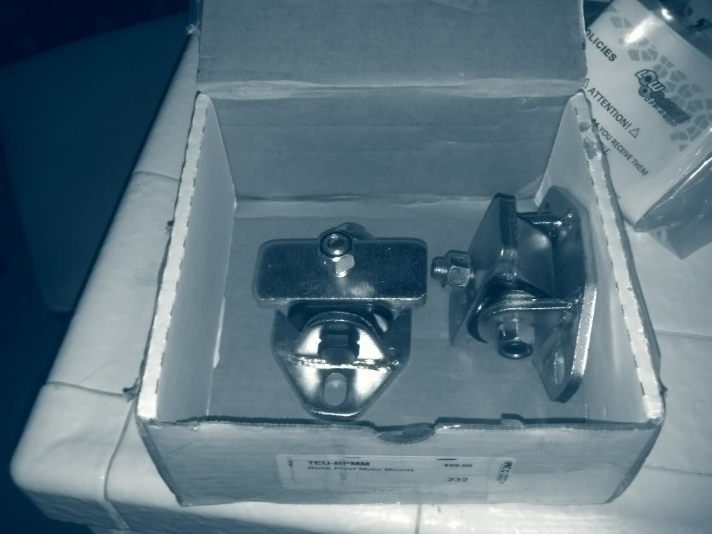

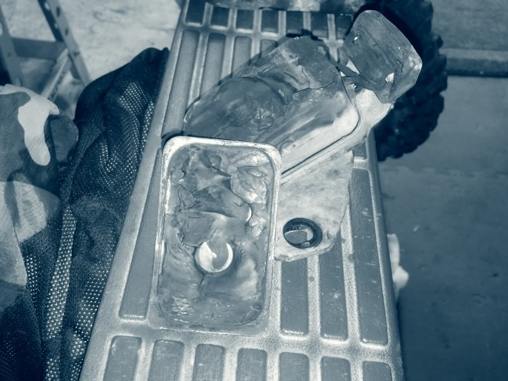

    Old motor mount
    New motor mounts
