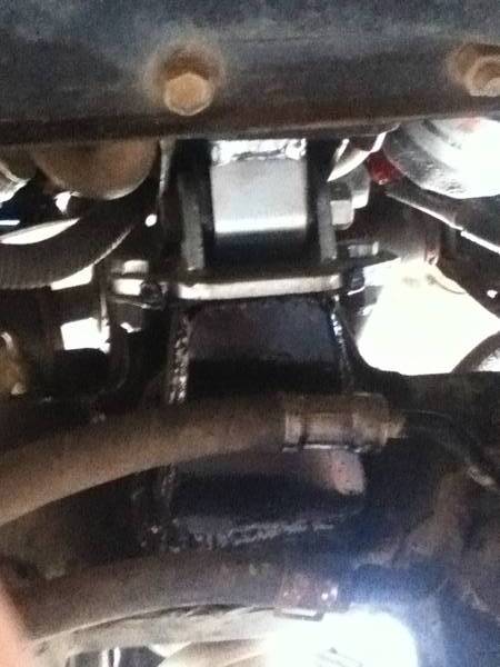

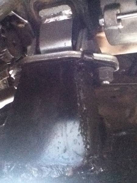

    :thumbsup: Took the truck on some dirt today and all I can say is if any of you are thinking about doing solid mounts, do it now. It does vibrate considerably only when stopped in gear but the positives highly outweigh the negatives. The front end is noticeably more rigid and it works even better.

    exactly wat i did, i Even built my own frame perchs out of 1/4in plate steel so that shit wouldnt snap again. then some bomp proof mounts like yours. Does vibrate alot at a stop in gear, but its not to bad, and u get pretty use to it after a while. Make sure u solid mount that Tranny up asap!! i stacked 2 super fat washers in between the tranny mount.. (in the gap were my fingers are) [​IMG] Works great and the tranny never slips out of gear or even wiggles at all anymore when offroad. no pics of after i put the washers in but u get the idea

    Awesome thanks for the suggestion. I will be getting on that quick and also boxing in those stock frame mounts.

    ya do it! before they completely explode like mine did! :eek: had to pull my whole motor, fabricate my own mounts, align/weld them up, and drop the motor back in all in one weekend... 28 hours of hell total in one weekend:frusty: but never gonna have that problem again :D

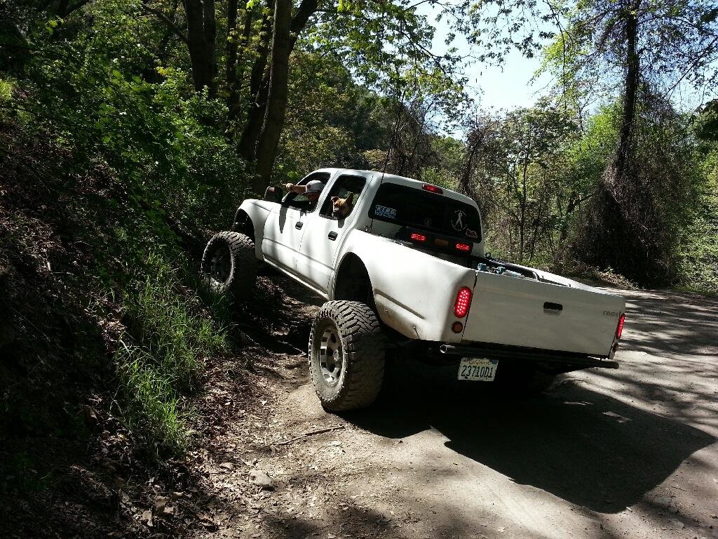

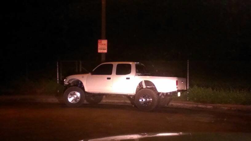

    Got spotted freshly clay-barred and waxed.

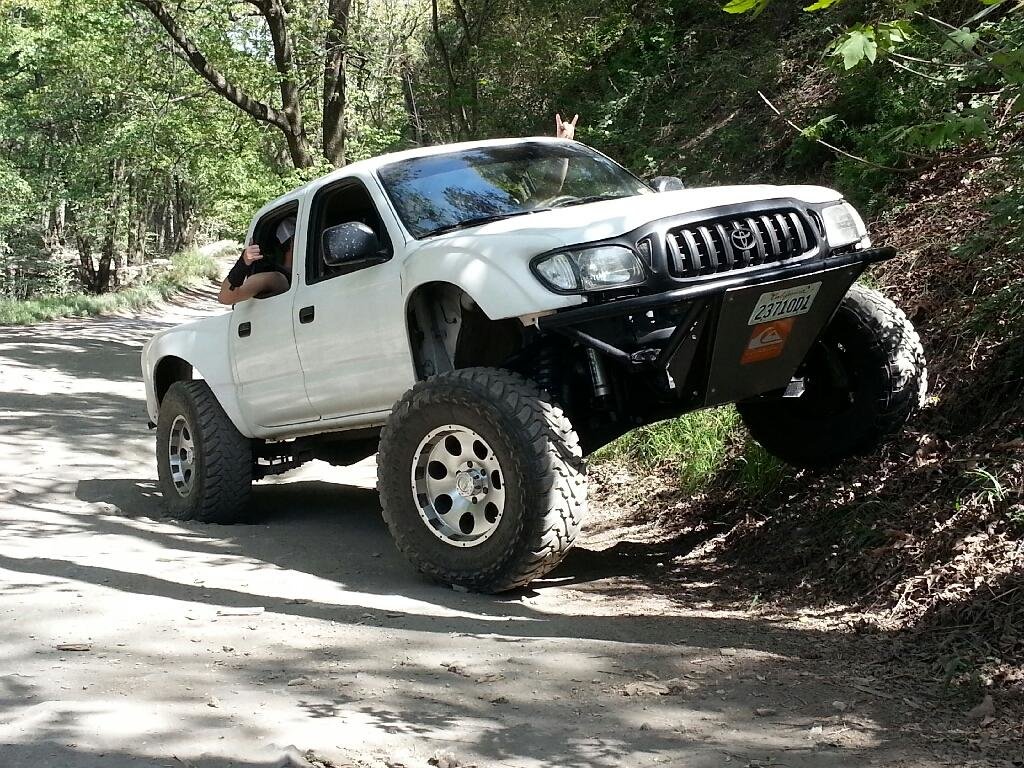

    Stopped in Barstow on the way to Vegas and hit a little roller. Didnt want to huck it on the way and not make it to Vegas. Not too exciting but I will post it anyway haha
