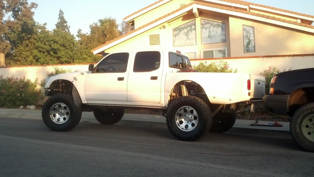

    hey do you have any more photos of your rear axle setup? like how the shocks are mounted??

    Here's a few.

    NICE! i like that! thanks man.

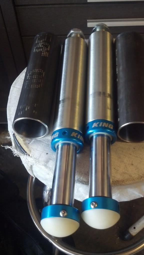

    Swapmeet Score!

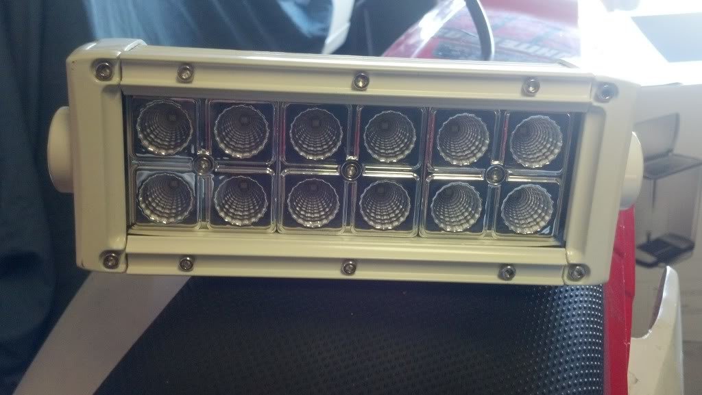

    Also picked up a couple 8" LEDs to put behind the valence for side-light.

    How much did you grab those for

    I paid $400 straight from King with the cans. Total I have $2400 into shocks compared to their $4200 retail so I am stoked haha.

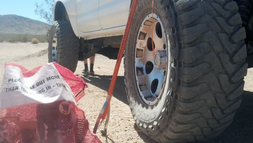

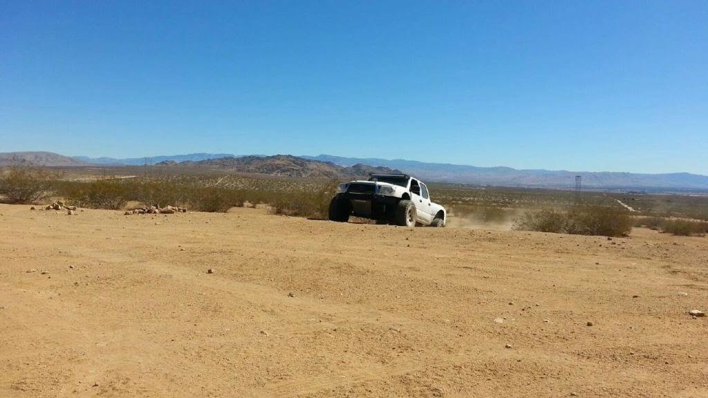

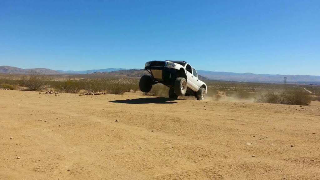

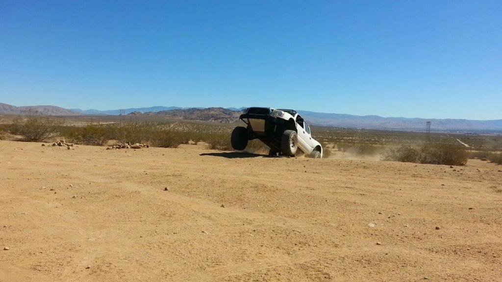

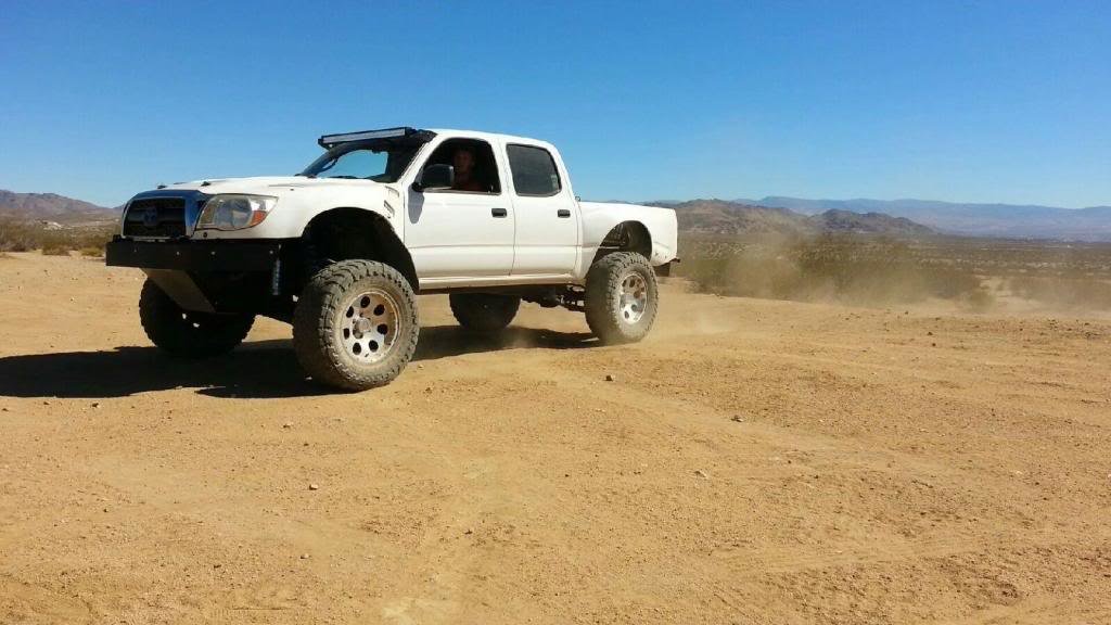

    Got out to Barstow today for the clean up. It was a solid showing. Got a free shirt and ran the truck around a bunch while we picked up trash all over the place.

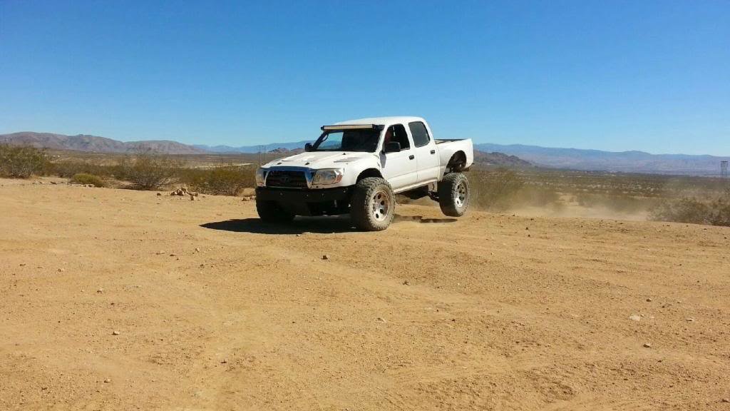

    Nicee! truck looks awesome!:thumbsup: how'd it do out there?

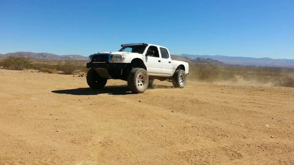

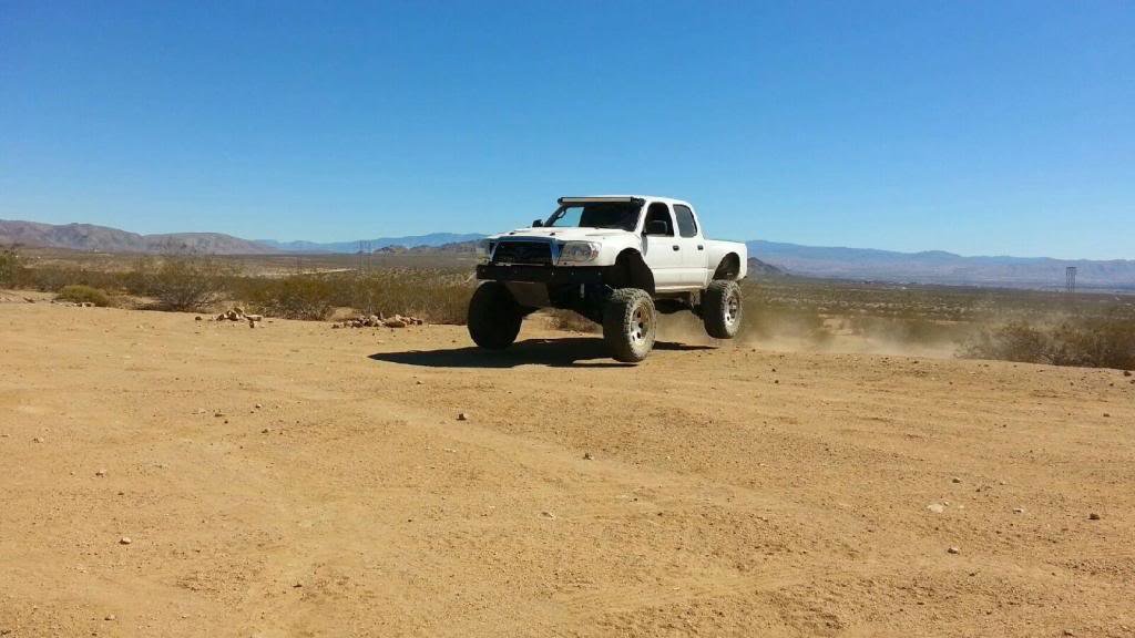

    Thanks man. It worked awesome no issues. My friend added some extra supports on the 1 piece and put the other 2 latches on it yesterday. Does not move at all in the dirt.
    Also stiffened the compression tube on my bypasses a little to make up for a full car load of people and it was crazy to me how much of a difference it makes.
