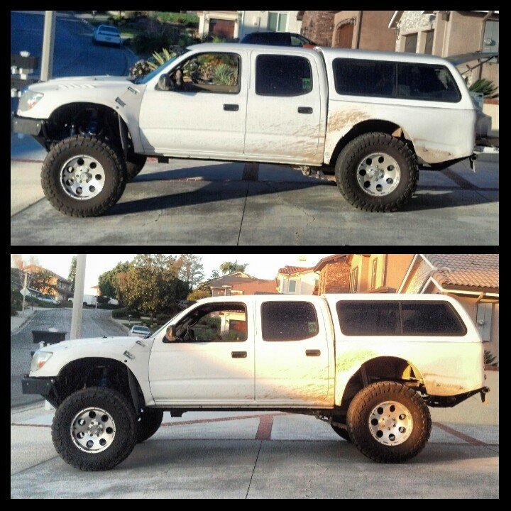

    Haha my friend and me were just saying yesterday we never want it off again haha. He's gonna check it out today and see if there is a fairly simple way to secure it a little better from the top.
    4 doors definitely have their benefits sometimes. Other times when I don't want to drive, I normally still end up having to because of the extra seats haha

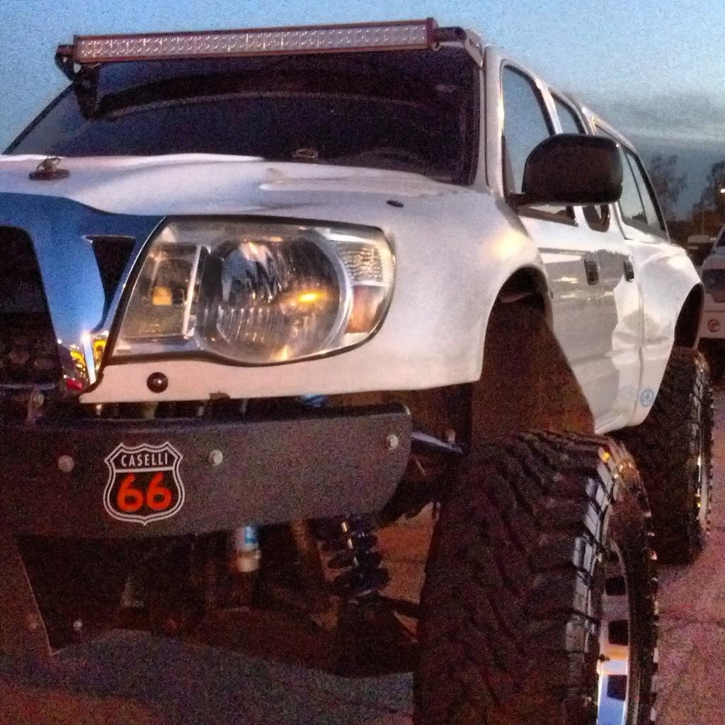

    Took the truck to Supercross today. Glad to say nobody stole the light bar. One of the best races I have watched in a while. Donated and got a Kurt Caselli sticker to put on the truck too.

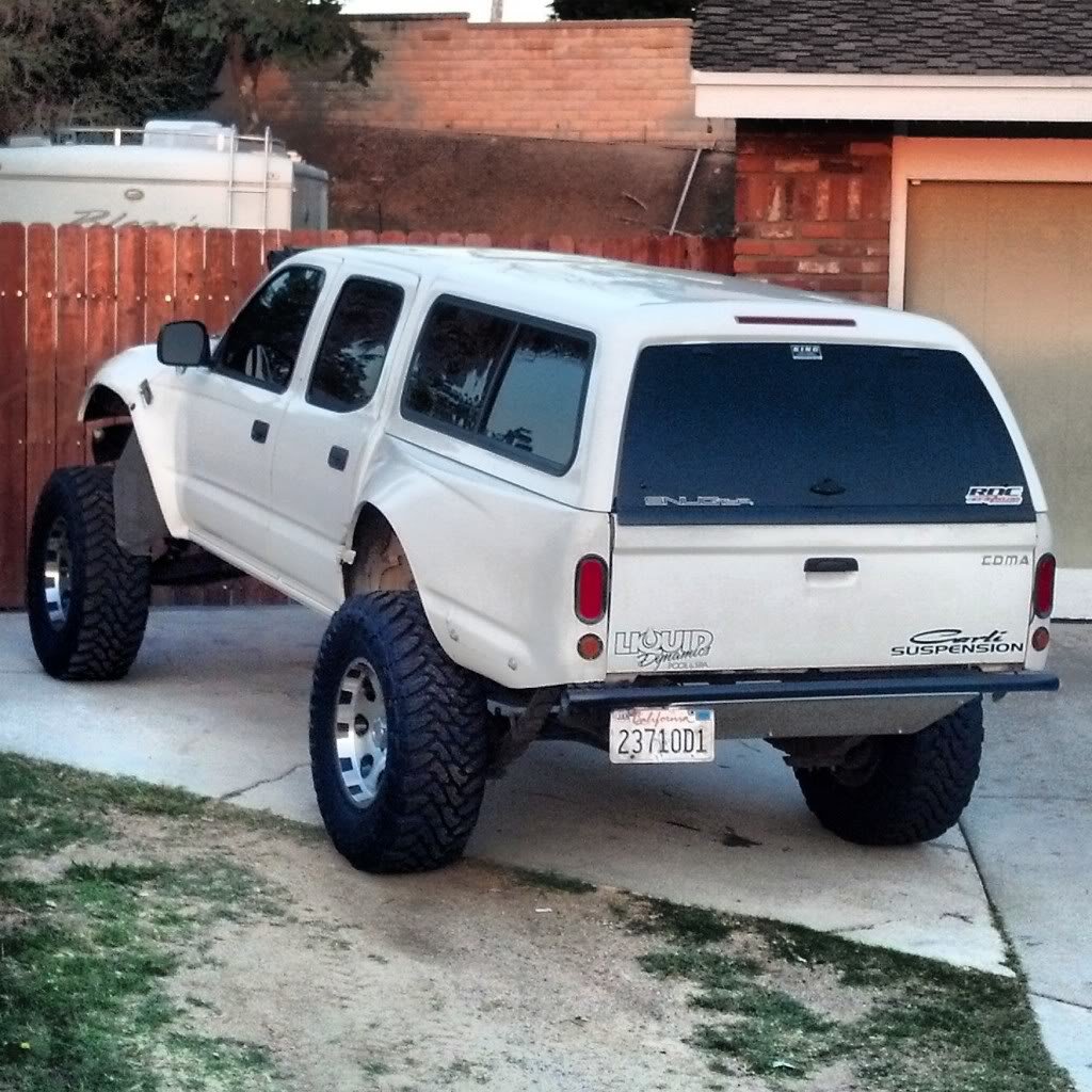

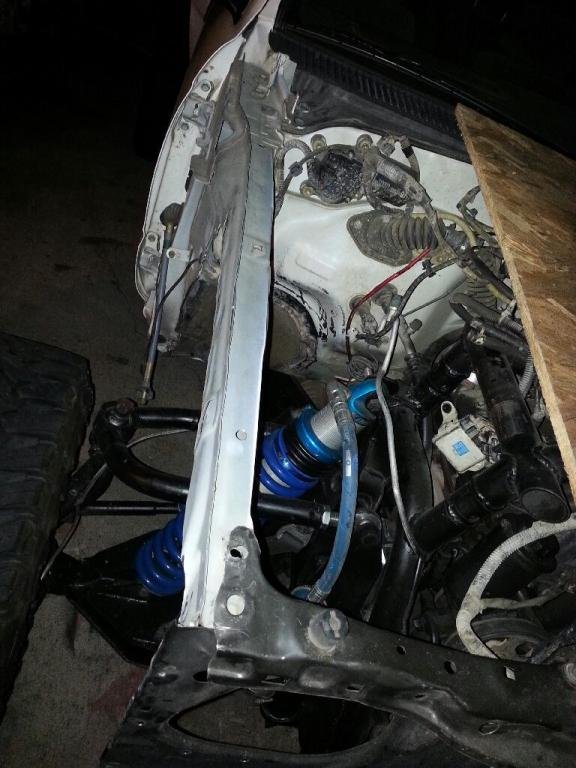

    Hey man this is a REALLY sick build I love your rig! When you cut the fender/wheel wells did you have to re weld anything or can you cut most of that sheet metal out of there?

    Thanks man. If you look closely you can see there are miscellaneous accessories that were relocated to mount off the engine cage. Those mounts were welded on but other than that there was no welding. The only thing was after a few trips out to the desert the core support started to seperate from the sheet metal that connects to the cab. Just have to be careful you don't take too much out.

    Got ya ya I just wanna cut out most of it so I don't get any rubbing I just installed my total chaos kit! Thanks man your truck is my idol haha

    I still have not taken the shell through a whoop section but it has held up perfectly fine on mild offroading. I don't plan on mashing with it on until the truck gets caged and it gets supported up top. As for the rear axle it would probably slightly rub the shocks at full articulation with no spacers so I threw a 1" Spidertrax spacer on it to be safe. It doesn't touch at all the way it is currently set up.
