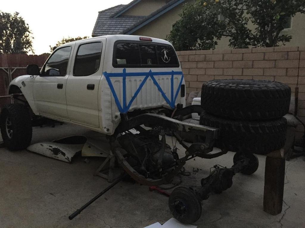

  6. Jun 16, 2015 at 2:57 PM
    #806
    whitetoblack
    whitetoblack [OP] ******
    Feb 23, 2010
    #31986
    1,135
    Tyler
    SoCal
    02 Prerunner & 08 Prerunner
    Johnny Branch Fabrication, King, Deaver, Glassworks, Toyo Tire, Alpine, work in progress...

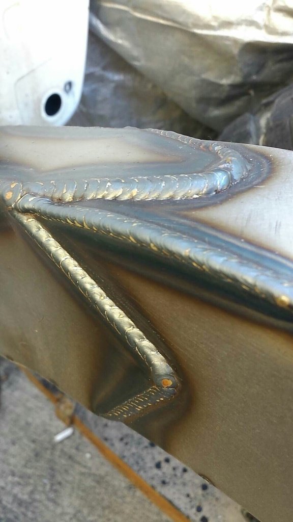

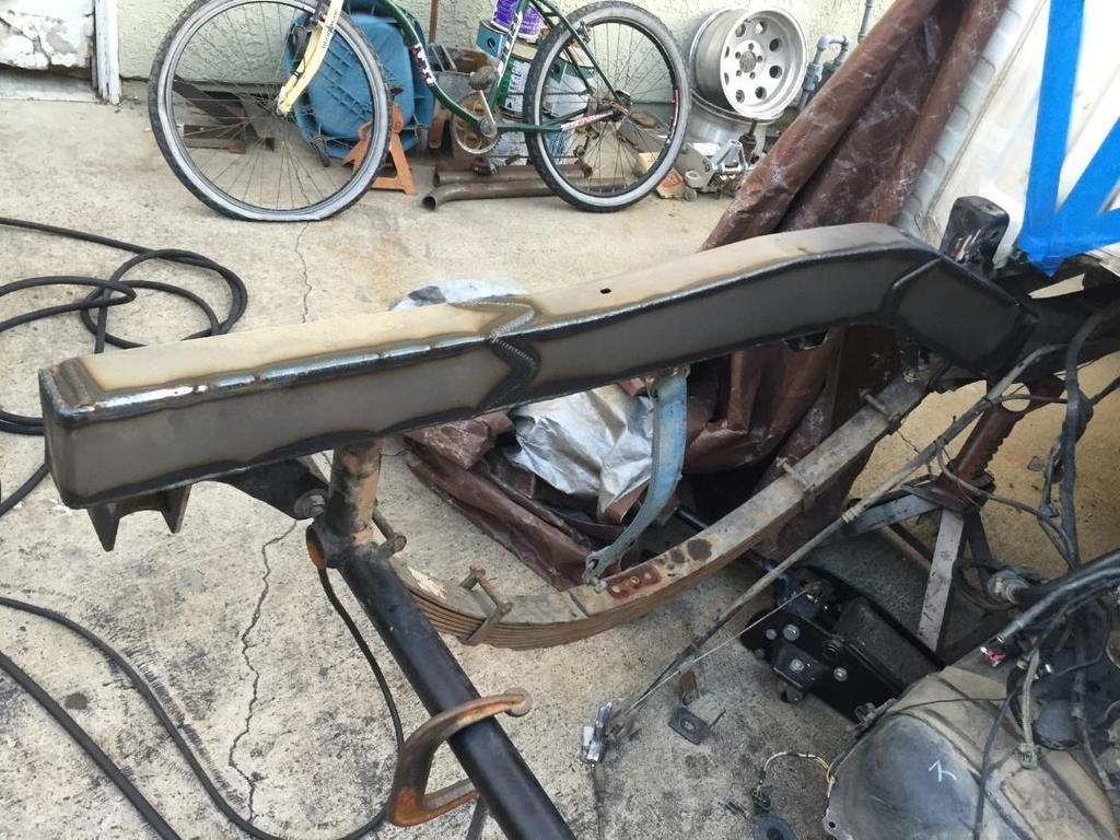

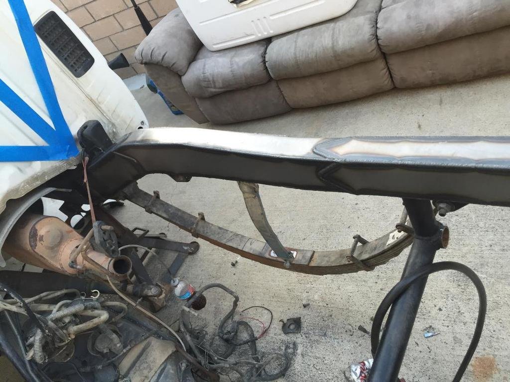

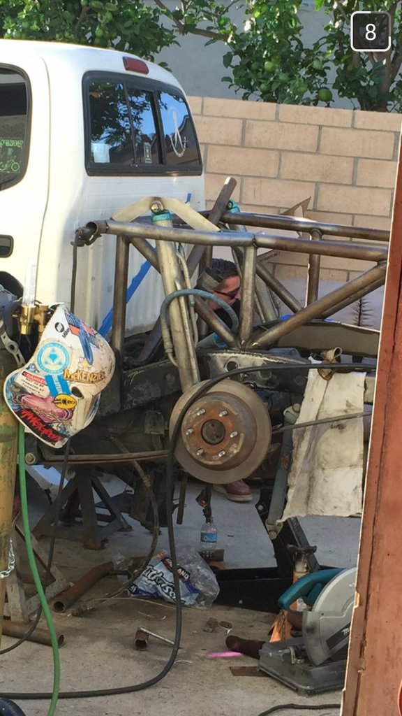

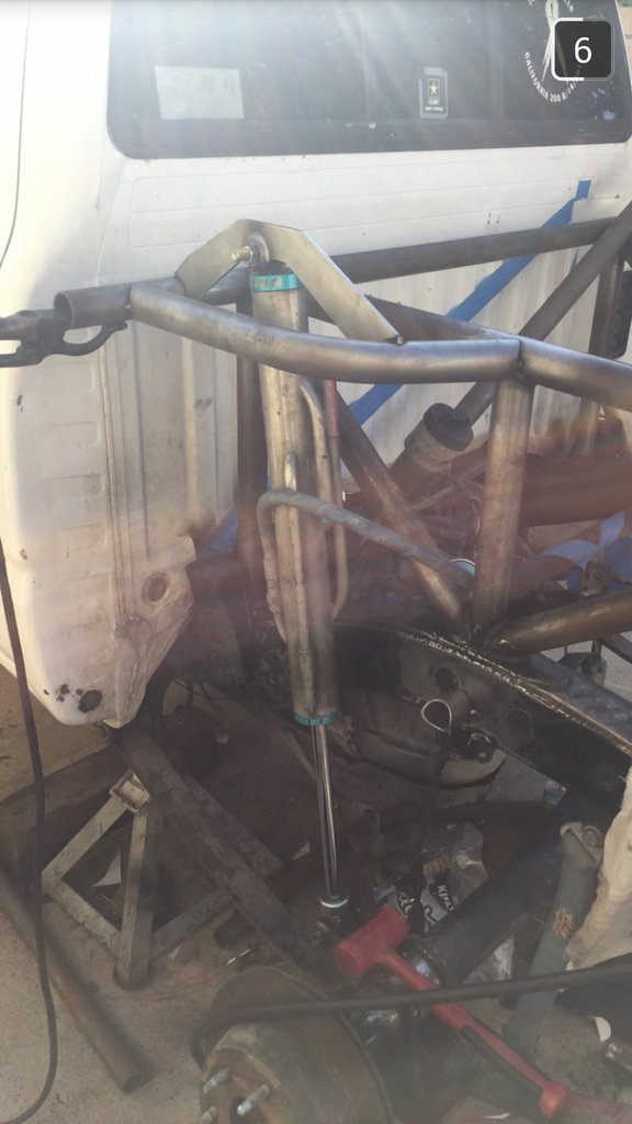

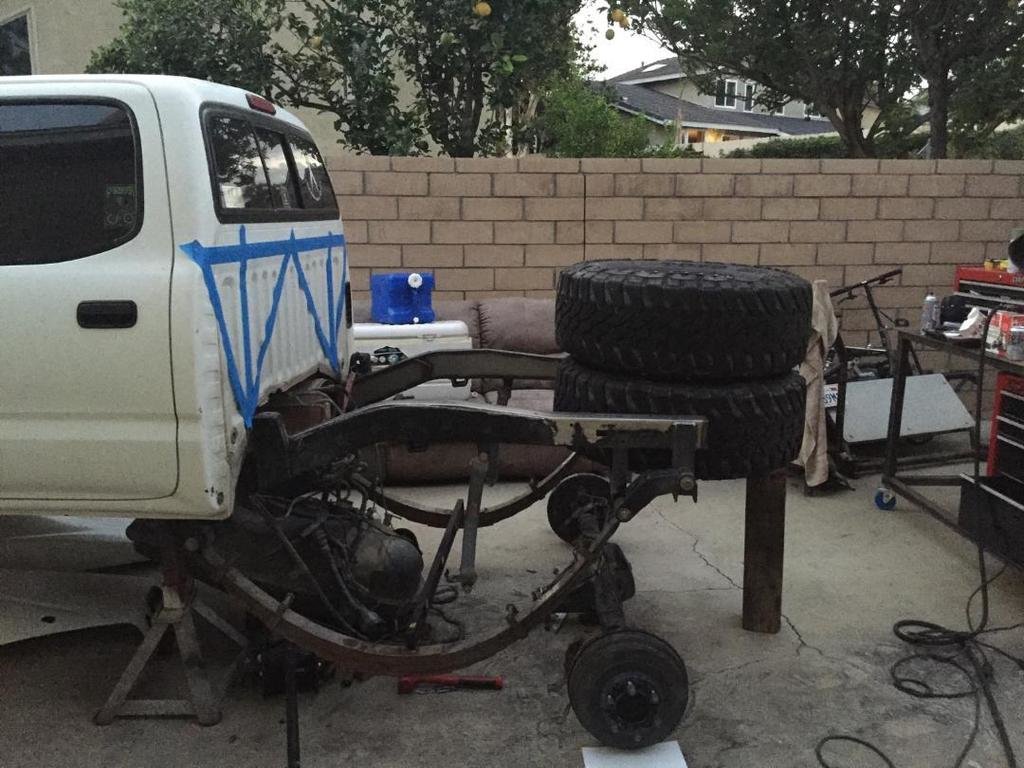

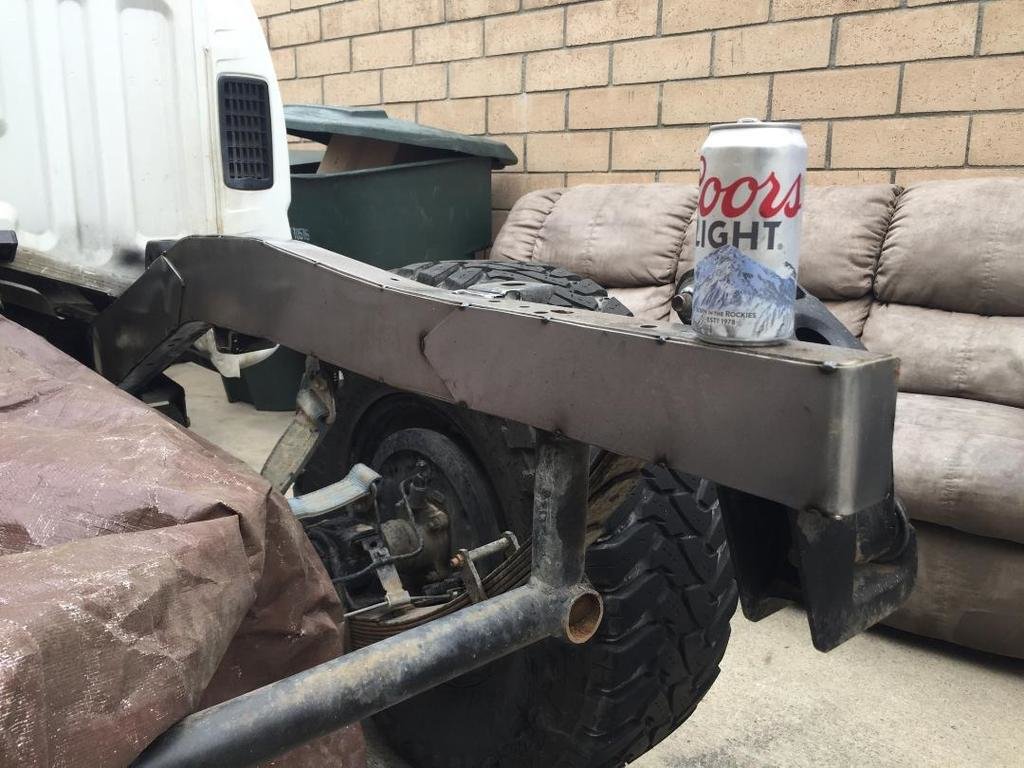

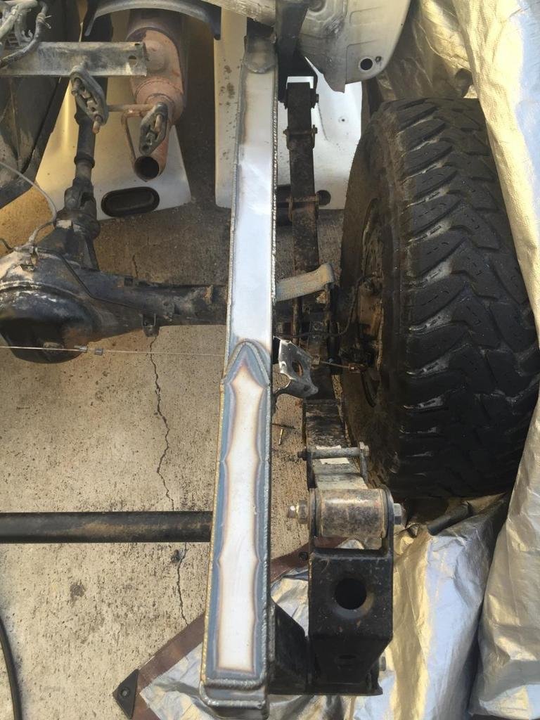

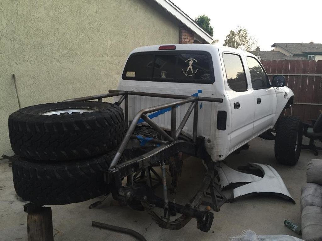

    Haven't updated this thread in a while. Put some new wheels on the truck and it's now under the knife getting a full back half rebuild, a Ford 9" rear end that matches the front track width with 4.56s and a spool, new rear fenders/bedcage, and then an internal cage. Here are some pics.

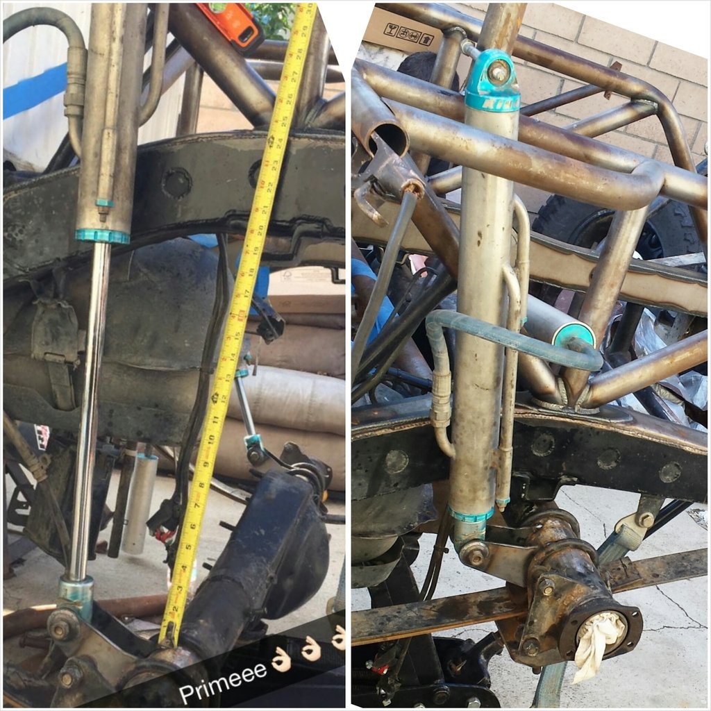

  12. Jul 25, 2015 at 1:29 PM
    #812
    whitetoblack
    Feb 23, 2010
    #31986
    1,135
    Tyler
    SoCal

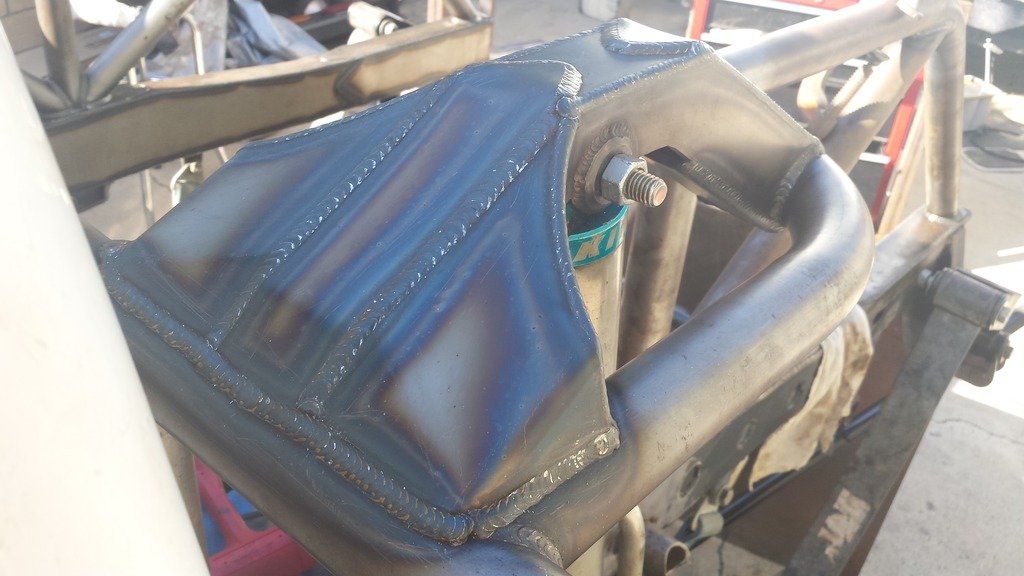

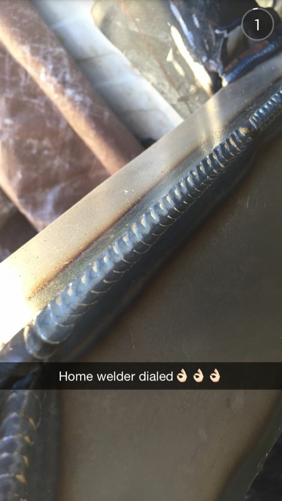

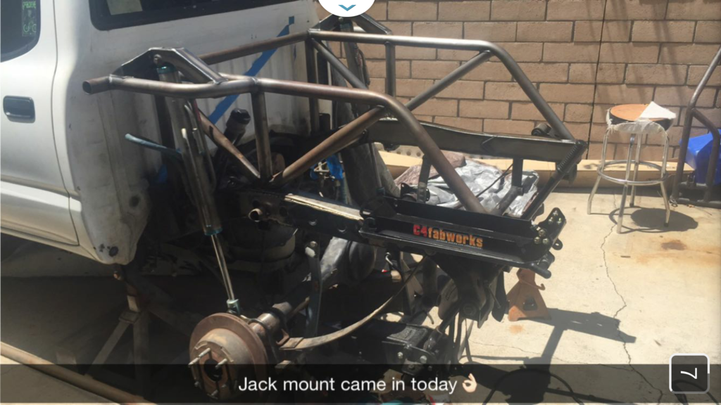

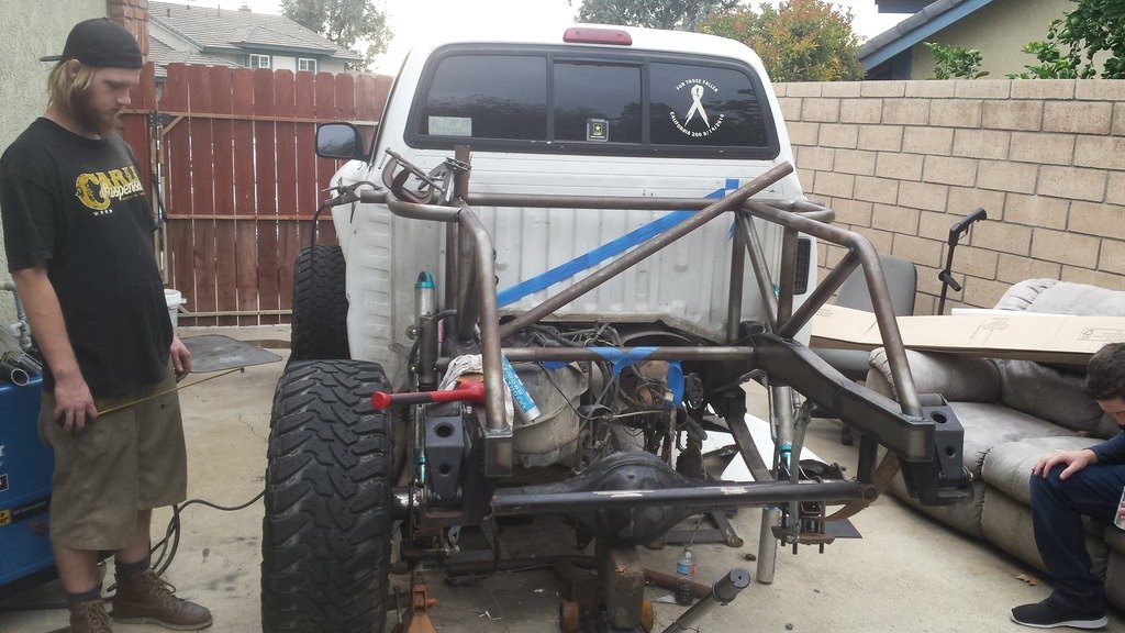

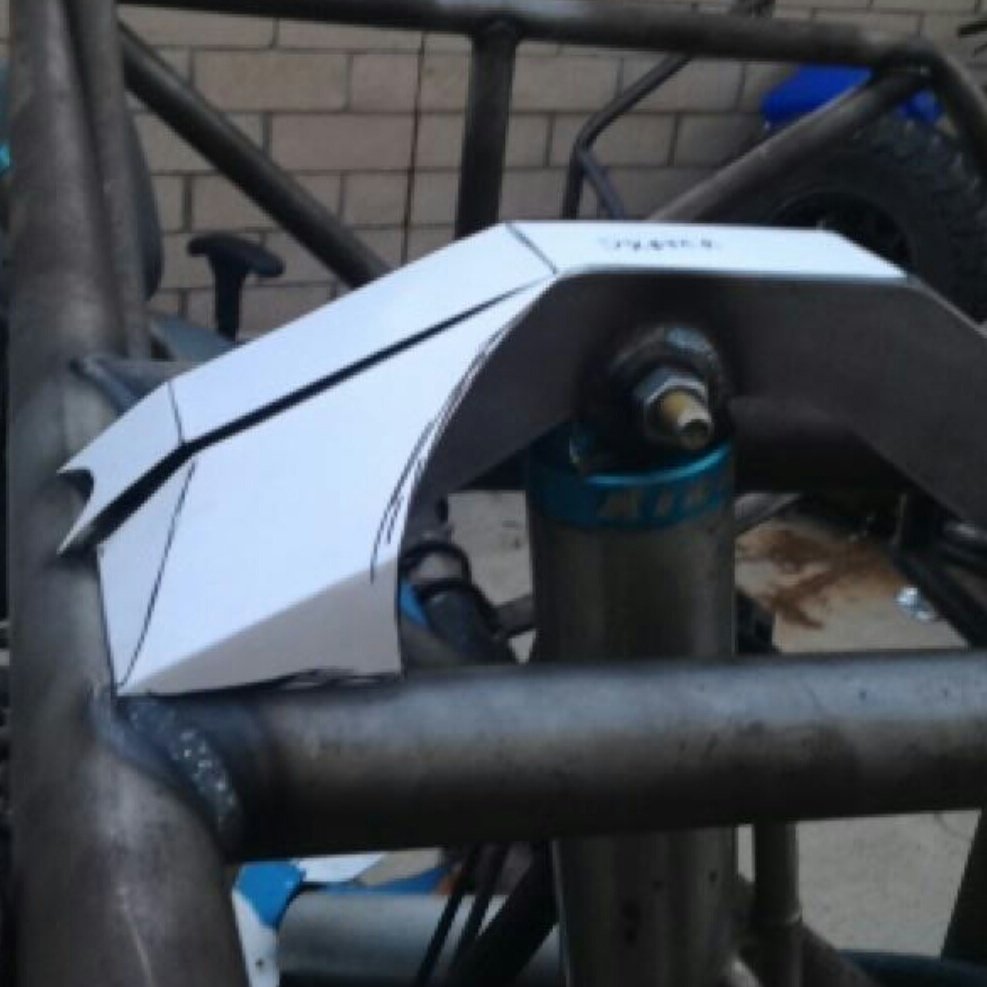

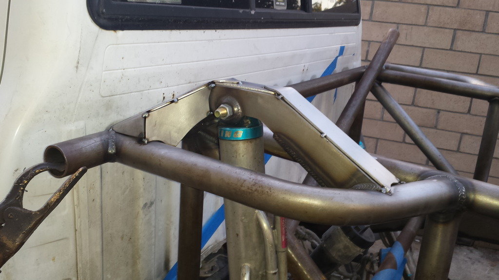

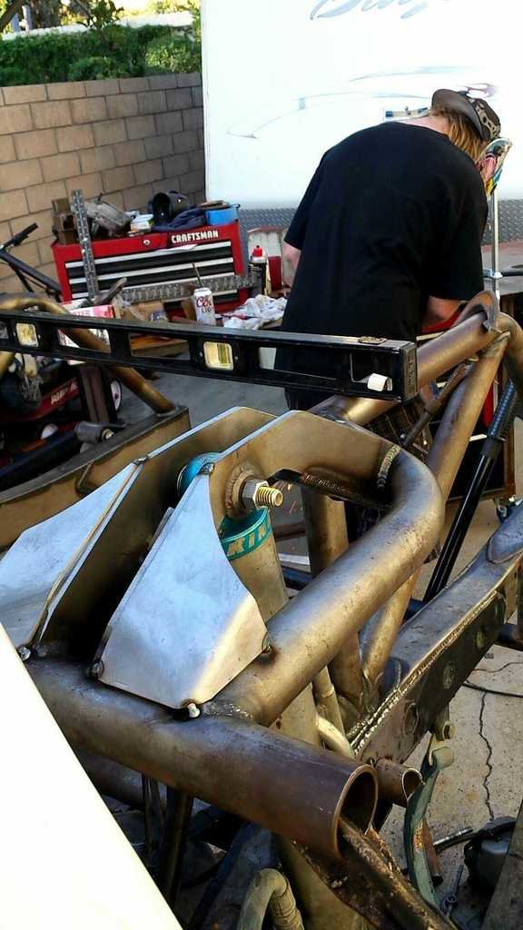

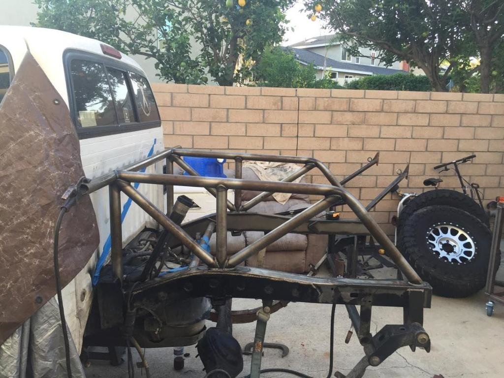

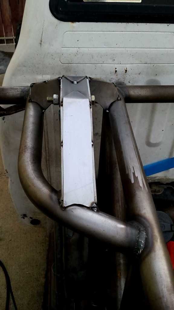

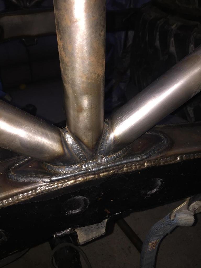

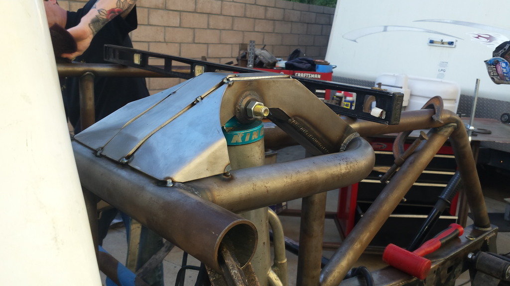

    Some more update pics. Bedcage started and shocks are getting mounted.

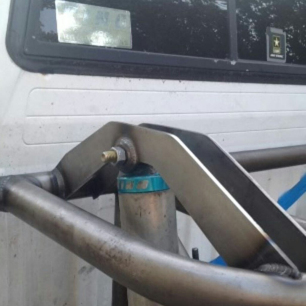

  14. Aug 3, 2015 at 9:17 AM
    #814
    whitetoblack
    Feb 23, 2010
    #31986
    1,135
    Tyler
    SoCal

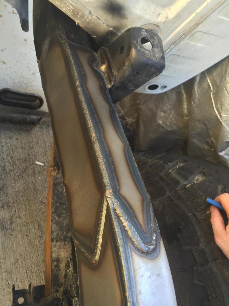

    When I mounted my bedsides, I drilled out all the spot welds on the stock bedsides and kept the stock bed rails. Since it still had those rails up top, the camper shell just mounted the exact same way it does on a stock bed. You can slightly see the back clamp in this pic but that's the only pic I have.

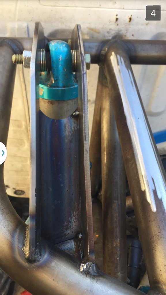

  15. Aug 3, 2015 at 10:04 AM
    #815
    whitetoblack
    Feb 23, 2010
    #31986
    1,135
    Tyler
    SoCal

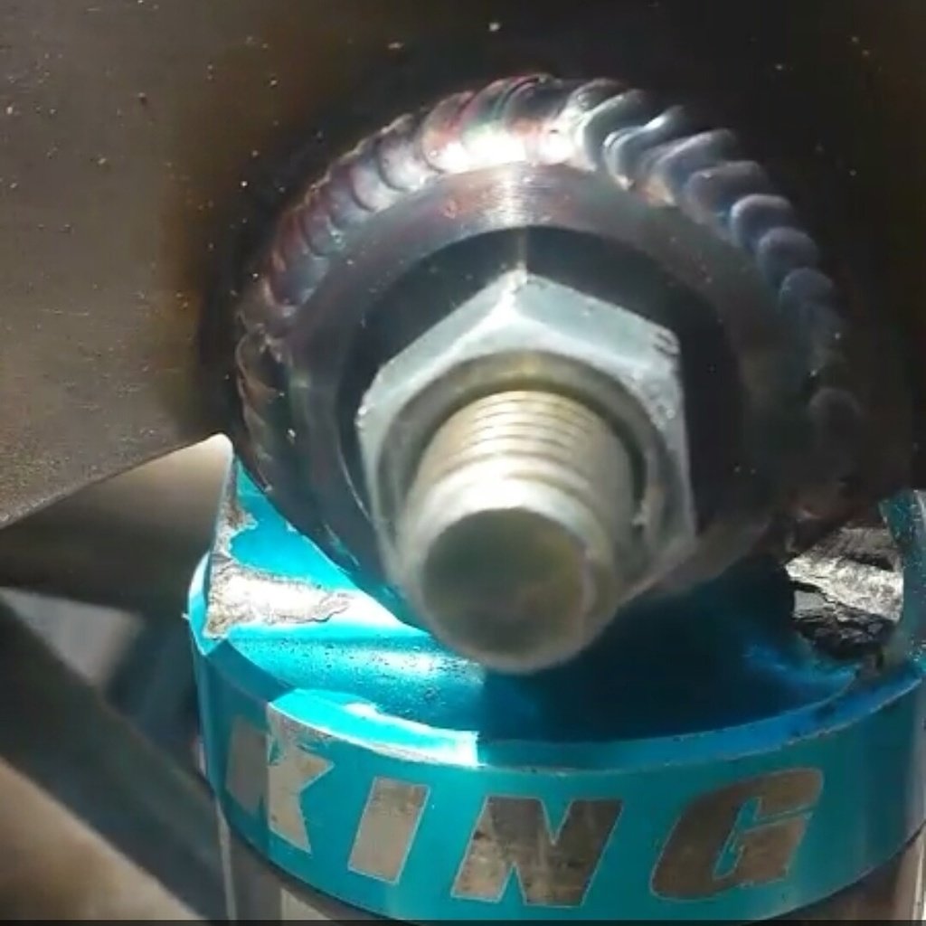

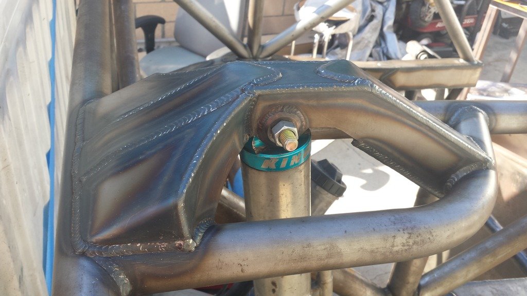

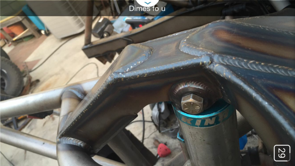

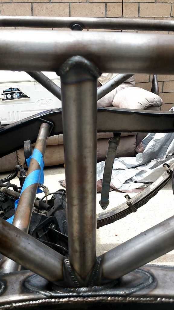

    My friend absolutely nailed it with the shock mounts. Couldn't be happier with how it is all turning out.
    A little tig on the weld washers
    CayucosTacoma, nfs257 and DIRT YOTA like this.

    Wow, I just stumbled on this thread. I seen this around and its awesome! Really cool ideas and clean work! I like the rear shock mounts, solid work!

    @BigRonDog thanks a lot dude. My friend has become quite an impressive fabricator over the last few years.

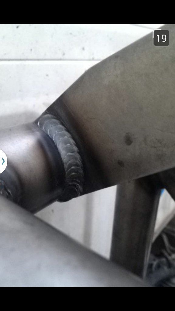

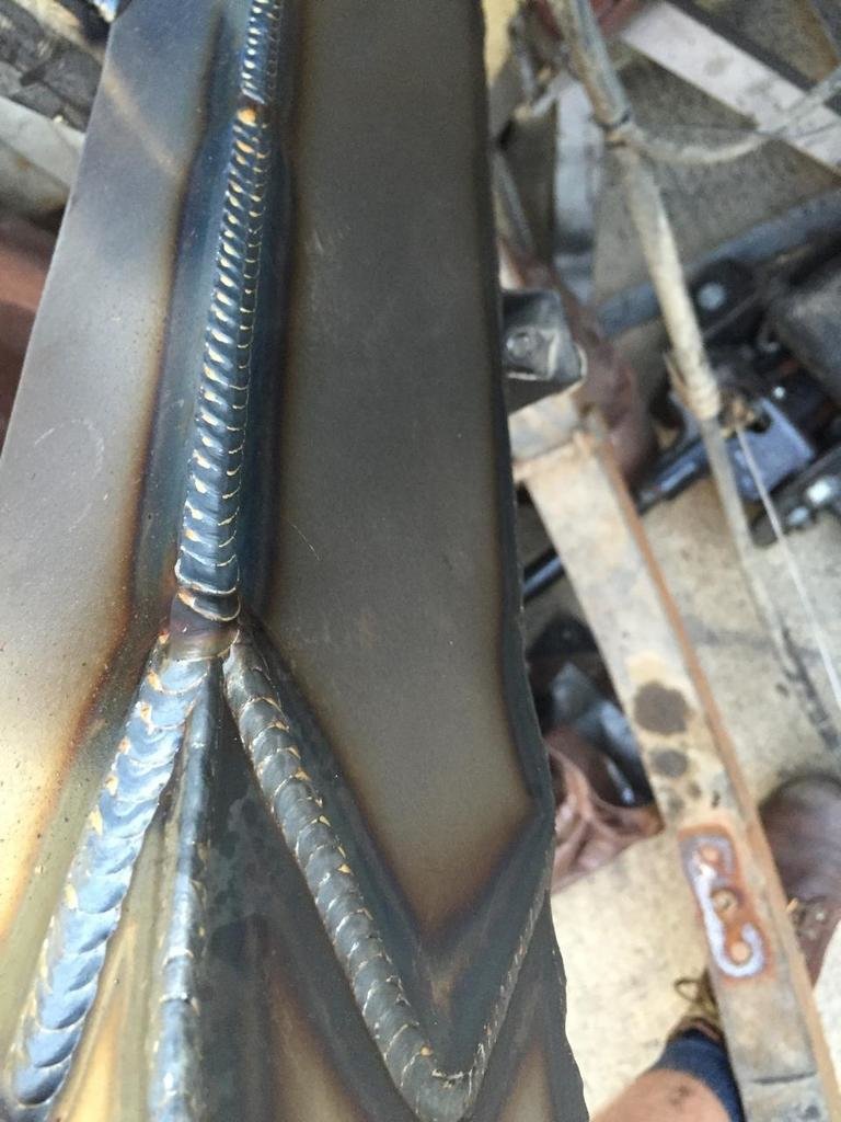

  19. Aug 25, 2015 at 11:48 PM
    #819
    Blackdawg
    Blackdawg Dr. Frankenstein
    Dec 31, 2010
    #48500
    81,601
    Monte
    Wyoming/St. Louis
    The Trifecta of Taco's
    Damn rear setup is looking sweet!
    TIG welded all that i hope...cause that would be insane MIG welding...haha Great work.
  20. Aug 26, 2015 at 9:08 AM
    #820
    whitetoblack
    Feb 23, 2010
    #31986
    1,135
    Tyler
    SoCal
    @Blackdawg Everything is MIG welded except the weld washers which are TIG. Why do you hope it's all TIG? I'm confused haha
