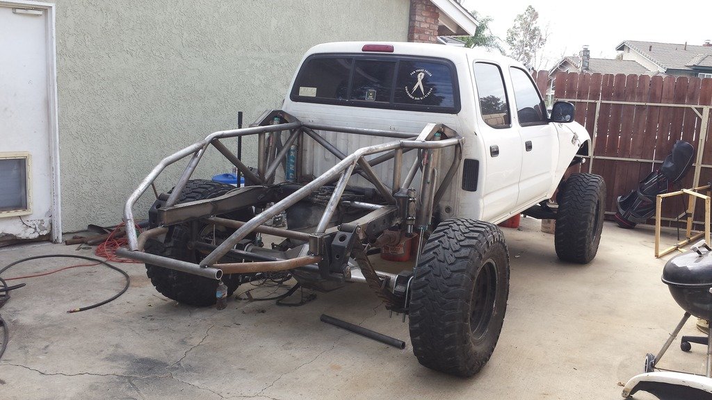

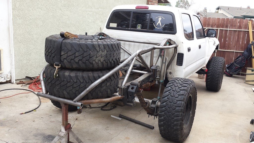

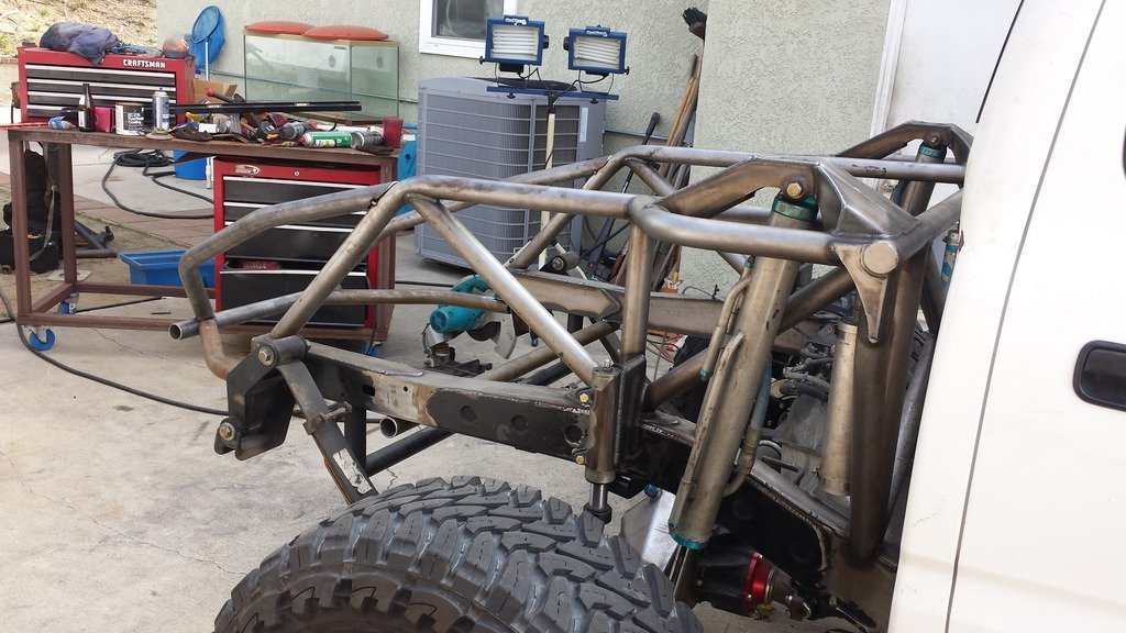

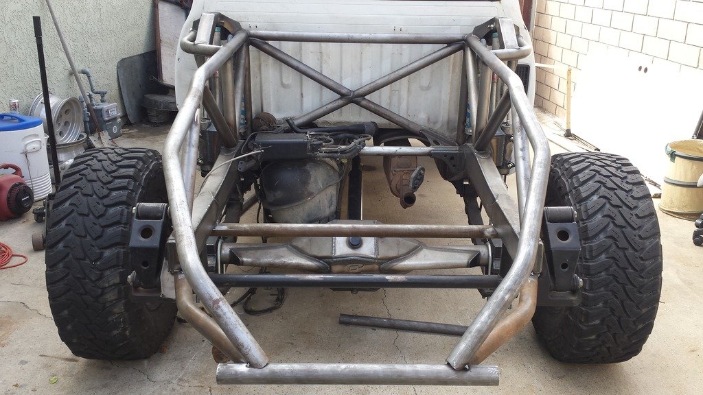

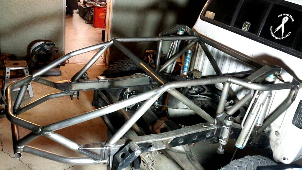

    Starting to finally look like a truck again

    Suprised you didn't just link the bitch.

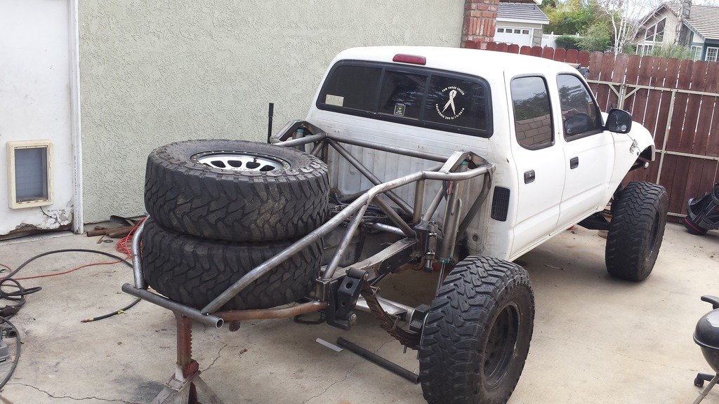

    I only would have gotten 4 more inches of travel without losing the back seats. The 64 kit works good enough haha. Plus the bedcage can be slightly modified if one day I do decide to link it

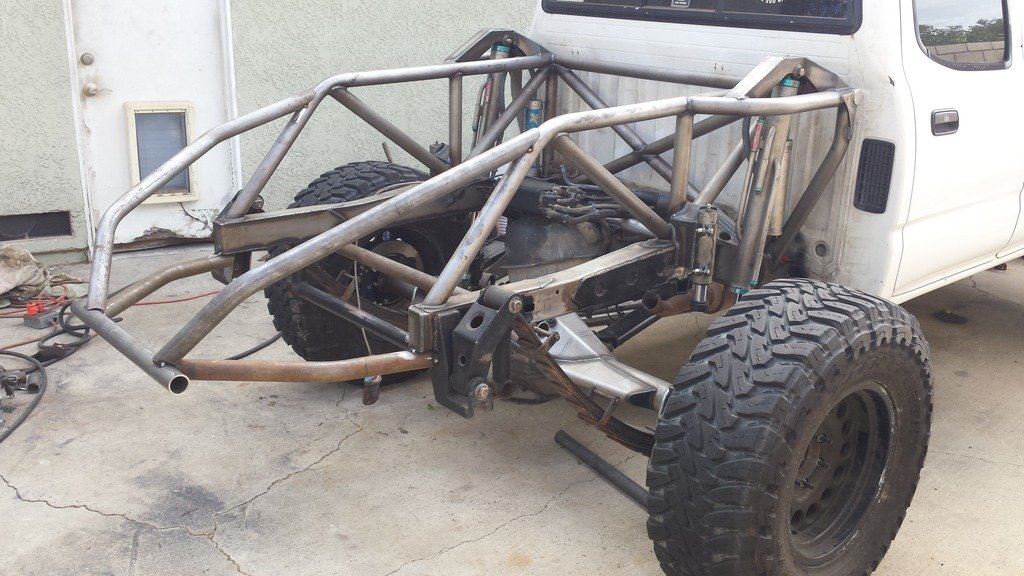

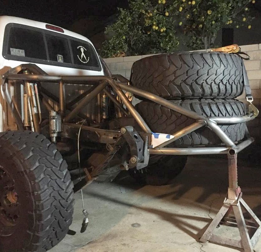

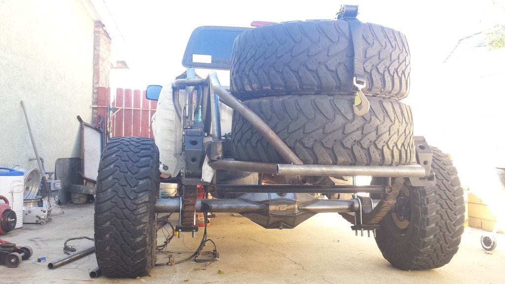

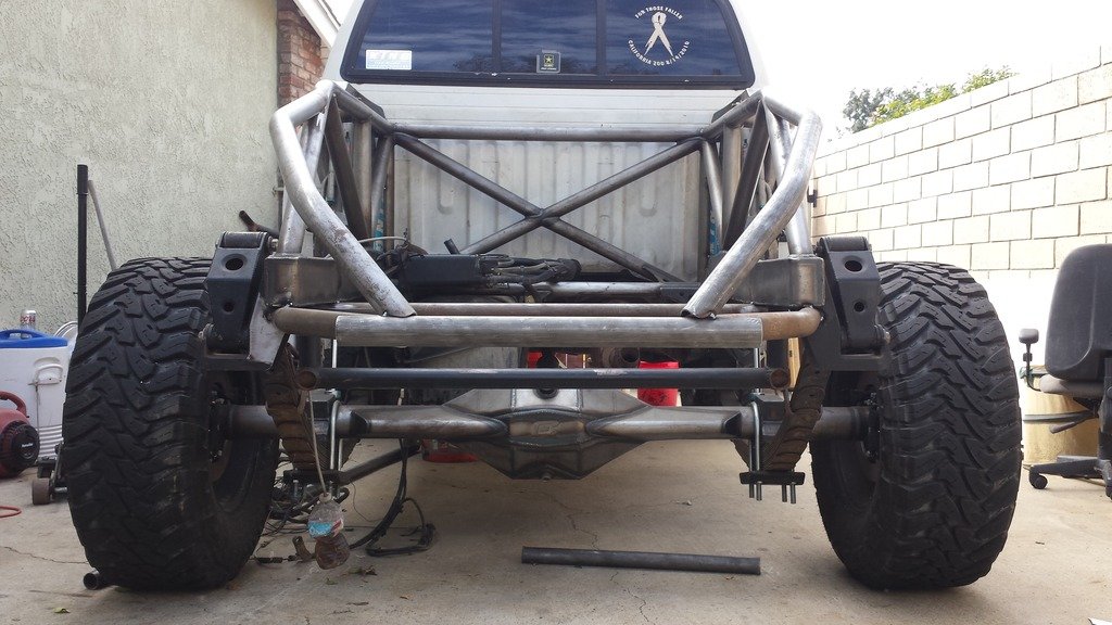

    Is that rear axle a full floater? Can't tell from the pics
    Also, did you have ABS originally? If so, how about a pic of the master cylinder and associated parts along with the proportioning valve.

    No it is not a full floater. 31 spline 4130 axles. Maybe one day I will hack the ends off and make it full floater but it wasn't worth the extra thousands of dollars right now when I am not pushing a lot of power.
    And no ABS stock. Just a stock master cylinder and a wilwood proprtioning valve. I will upgrade if necessary but for now it will stay stock. I will post pictures when it is all mounted.

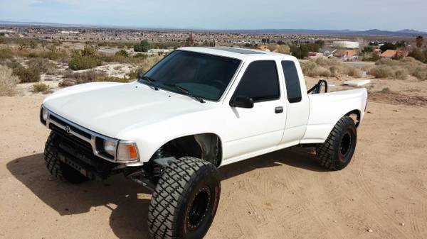

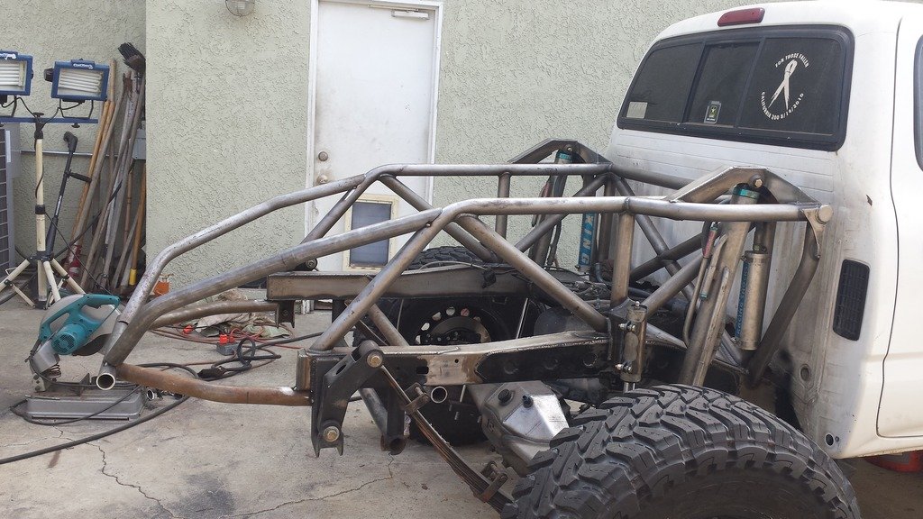

    this is up for sale on craigslist LA can anyone tell me about his rear suspension cage?

    send me the link? I doubt its for sale...its in pieces on the side of his house getting major work.

    ah, they looked pretty close.

    Honestly the only thing that looked close is they are both white and Toyota... That truck is nothing like this one lol :crazy:

    They actually are pretty close. I think everyone was confused what you were comparing it to haha

    both beautiful! i had to fight the urge to fly out to cali and drive the top one back to georgia.
