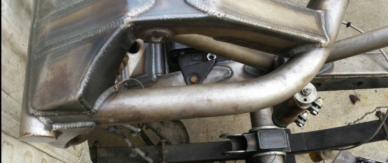

    Hey man if you get a chance could you please take a picture of how you have your shocks mounted to your axle in relation to the spring perches? Did that change from when you just had the Tundra axle? Also would you mind measuring from the outside of one u-bolt plate to the other so I can get an overall width of the kit? I think I'm going to just run smoothies and notch the frame until I lt the front. Then I'll swap out the axle for a fabbed one like yours and get some bypasses. The notches will come in handy like others have said that have been rubbing with a Tundra axle. Thanks again. I'm at the point now where I'm going to start buying stuff for the axle so I want to check once more before I buy anything. Thank you! Have a good day. :)

    Hey man, here is a picture of how the shocks are mounted to the axle. Its the only one I could find. I live in San Diego and the truck is in Orange County so I cant get those measurements right now but I should be able to this weekend.
