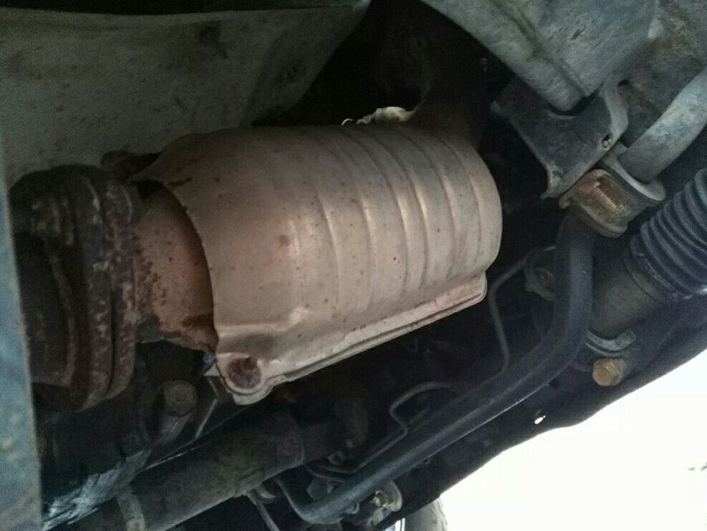

    ok now im back i took pictures of both these are they both cats? the smaller one is closer towards my passenger tire and the longer one is futher back... and beyond that there is the big muffler so does that mean these two are both cats?, sorry i cant even find this in my manual

    Looks like you have two catalytic converters.

    sweet thank you for quick response ! i kno what to order now woot!

    The rear cat on yours is either an aftermarket cat or it's just missing the heat shield.

    The heat shields rusted off
    Even Aftermarket cats come with heat shields

    as far as i know everything was stock(except the grey wire mod) when i purchased this from a friend of a friend and it sounds completely stock ,very quiet indeed compared to my other friends who own aftermarket exhausts, and i want to thank you both for replying back so quickly :p this was a good introduction to this forum and i will be back for sure

    It’s a missing heat shield
