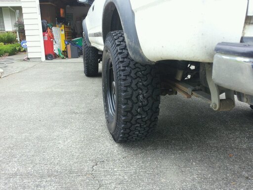

    Basically I am tired of having a bumpy ride on the trails. The spacer lift is the obvious culprit here. Pre-compressing the springs is not conducive to a smooth suspension. Not to mention that the struts have 160,000 miles on em. As for the rear, I have been reading a bunch of threads regarding shackles adding to the flattening of the leafs, so those will go as well. Time for a new leaf pack
    The body lift went on to add a little clearance when I got my BFG MT's a while back. Was thinking about taking it off, but I would have to find the factory hardware to do that. Might end up going to Tacoma Screw to get them if I can find the specs on them.
    So I get my coilovers on the 12th, and I am super excited to put them on. Due to funds, I could not order the leafs just yet, but that is set for August. I can get the shocks for the rear though, but was unsure about a couple things. I can get the shocks and use them until I get new leafs, but I am not sure if they are going to be the correct length. Pretty sure they will be the same as I have 2 inch shackles on there now and will be replacing with 2 - 2.5 inch Dakars. Also, don't want to damage them by using them with spent leafs. Thoughts?

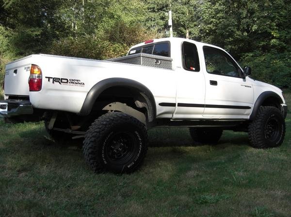

    The old BFG Muds

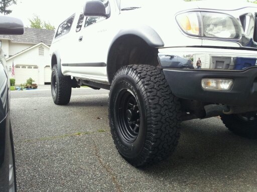

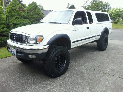

    How she looks now with the A/T's
    And you can see my flat leafs here

  3. Jul 8, 2011 at 5:11 PM

    looks good with the shell

    Thanks. I originally got 33" MTR's before I had any lift, so I got the cheapest lift I could find to fit the tires as I was anxious to put them on. The lift has served me well as far as clearance goes, and it was fairly easy to install. By "build it right" I mean build the suspension right.
    BTW, not a big fan of Goodyear MTR's. They did not last very long on the truck. My BFG Muds, which I recently retired, lasted for 55,000 miles and were awesome. Since I don't really go crawling or mudding as much as I used to, I decided to get some BFG A/T's which are great!
