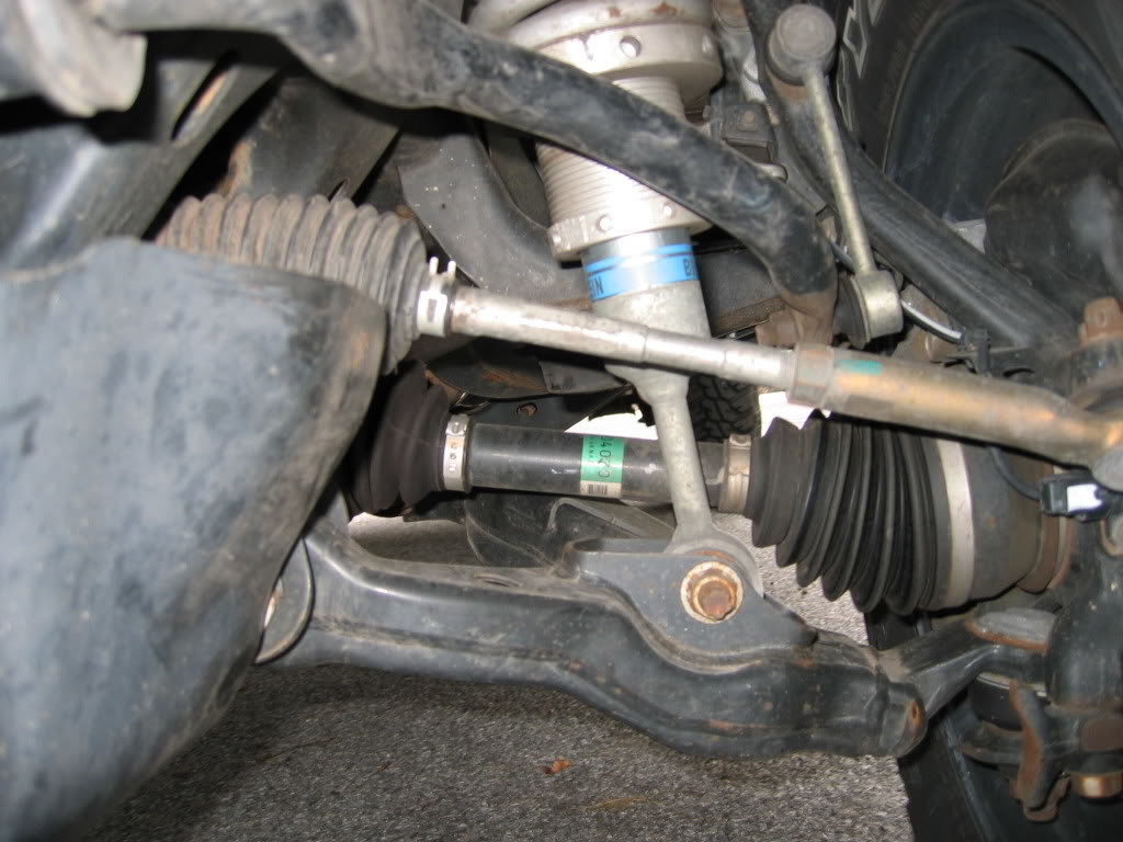

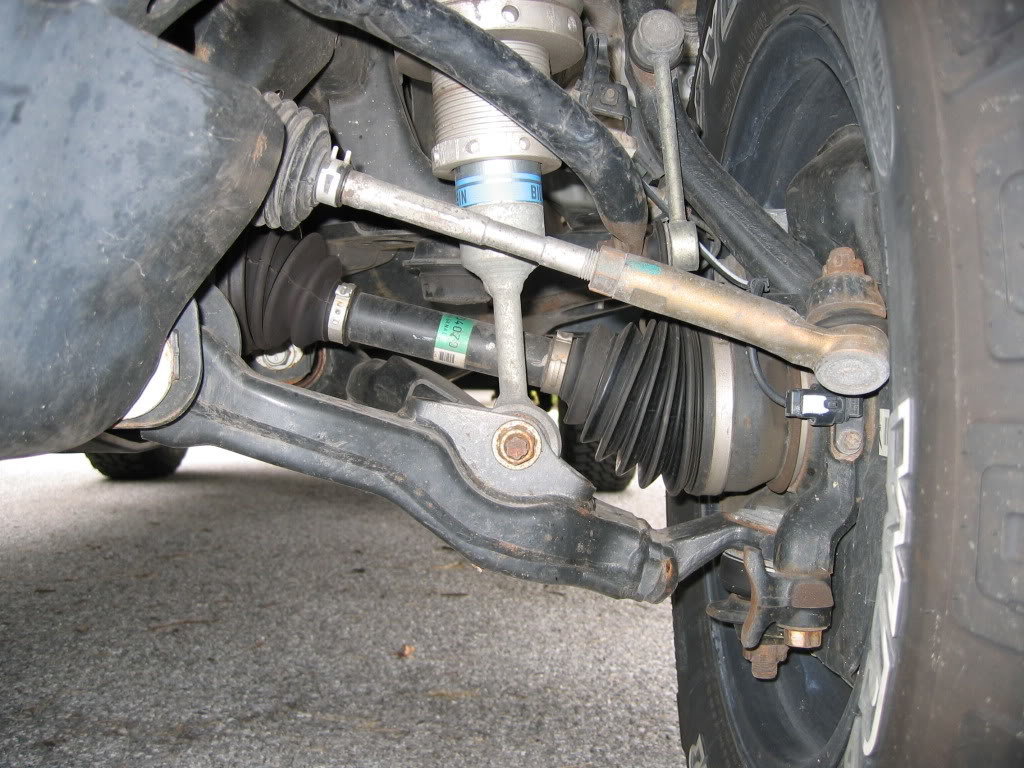

  14. Jul 27, 2017 at 7:53 PM
    mlcc
    mlcc Well-Known Member
    May 2, 2015
    #154429
    1,911
    Oregon
    2002 DC TRD/ 1995 4runner
    Mid travel, armour all around
    I'm running the eibach springs and bilstien shocks with a 1 in body lift from daystar and 33s and absolutely no rubbing at all and a diff drop with no
    issues
    Ritchie likes this.
