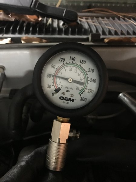

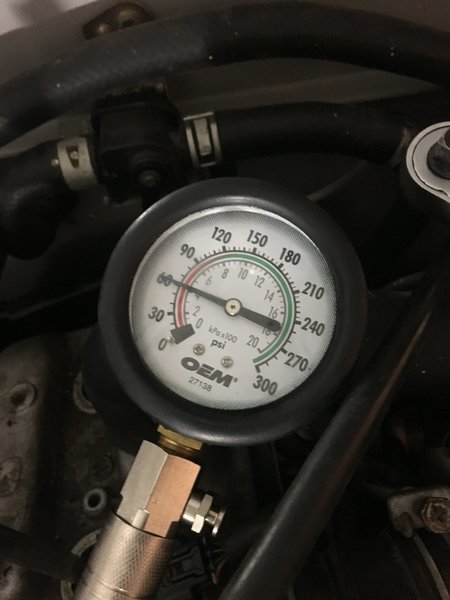

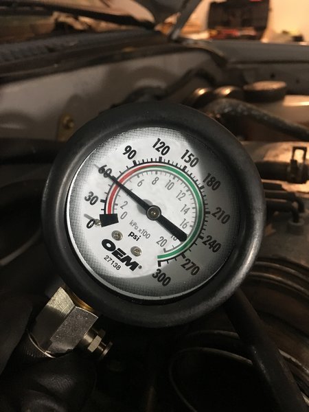

    Just finished compression test on all 4 cyl and result
    1 70psi
    2 60psi
    3 60psi
    4 60psi
    And idk why but my plugs full of oil

    Yeah that's not good. I would do a leak down next. You will need an air compressor and can rent the tool from autozone or advance auto. Your comp numbers should be 150-180 area. Oil on the plugs can be from blow by oil getting passed the rings or leaking from the spark plug tube.

    I don't know that I trust that gauge....bent valves can't seal at all. Your POSITIVE that the timing is right?

    Any reason you dont trust that gauge?

    It's not that I don't, I just don't know that I do. I have two compression gauges because 1 of them is prone to false lows. It's trickier to seal against the head. The other I put a taper on the spark plug adapter so it seals better to the taper of the plug hole. And I tighten the adapter to the hose now with pliers.
    Bent valves probably wouldn't show any compression but timing off WILL give low numbers. Bent valves WILL fire back through and poor timing MIGHT.
    Shooting some air to the cylinders would tell you more so the previous guy is correct about a leak through prob. being next. Usually not needed for a bent valve. Under the valve cover, are the valves acting smooth and tight (except for lash clearance) as you rotate the crank? You would have excessive clearance under any that are bent. Did the head get reworked while off? Mileage high?
