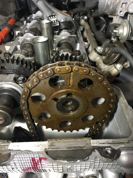

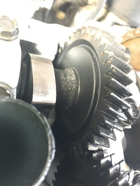

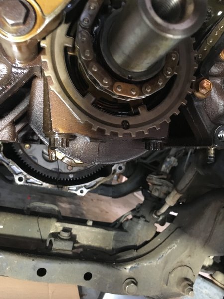

  6. Jan 21, 2017 at 7:04 AM
    #66
    westly7
    westly7 [OP] Well-Known Member
    Dec 16, 2015
    #172418
    194
    Westley
    01 tacoma 2.7 auto 2wd
    But how that happen if when i put the timing chain i make sure all marks are correct,see pic
  7. Jan 21, 2017 at 7:04 AM
    #67
    cruiserguy
    cruiserguy Well-Known Member
    Jul 31, 2016
    #193416
    18,924
    Elijah
    SLC
    2000 ext cab, 2.7L, auto, 4x4
    Makes sense. I echo the mechanic. Make sure you are TDC COMPRESSION STROKE. Then set cams to timing marks.
  8. Jan 21, 2017 at 7:05 AM
    #68
    westly7
    Dec 16, 2015
    #172418
    194
    Westley
    Yes see pic
  9. Jan 21, 2017 at 7:06 AM

  14. Jan 21, 2017 at 7:22 AM
    #74
    mechanicjon
    mechanicjon They call me "Jonny Stubs"
    Dec 2, 2016
    #203828
    10,083
    Jon
    Scottsdale Arizona
    04 Taco SC 4dr SR5 TRD Prerunner
    Supercharged, AEM FIC/6, Meth Inj, ION Alloy's, Radio & Phone steering Wheel controls,Fabtech AAL, Billie's wrapped with 880's , Tundra big brake conversion, bully bars and Pioneer DDin Stereo/dvd with exterrnal usb ports. 290K and going strong.
    Doesn't have to be shredded to slip. But if it looks shredded then hell yes.
  15. Jan 21, 2017 at 7:24 AM
    #75
    mechanicjon
    Dec 2, 2016
    #203828
    10,083
    Jon
    Scottsdale Arizona
    It looks timed right by your pictures

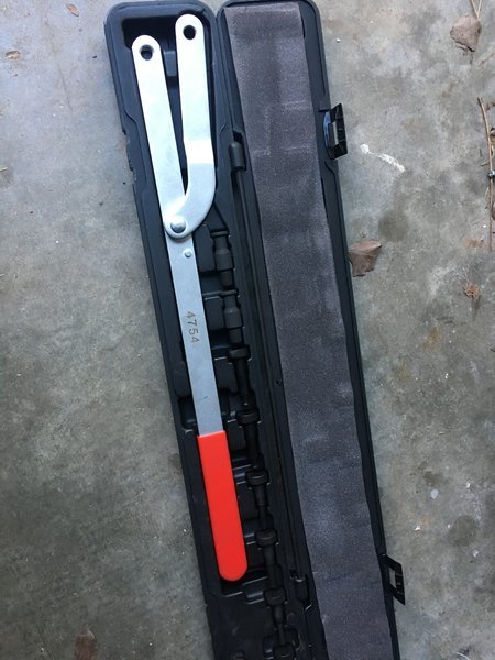

  16. Jan 21, 2017 at 7:26 AM
    #76
    Dirty Pool
    Dirty Pool FLIES ON THE FRIES, KETCHUPS WATERED DOWN
    Mar 24, 2013
    #100471
    2,266
    59.4 Miles, 56.67° NE Of Moab
    99 XCAB V6 MT TRD
    Dirty Pool rear bumper/air tank with integrated spare CV shaft storage, DP customized TJM front bumper, 8000 lb Ramsey/Technora rope, E-locked, Extended breathers with front diff catch can, PCV catch can, SAWs with DP heim joint seals, DP custom 6 leaf rear springs/Billies, DP custom skids, 2lo, Gray wire, Cap, Bed Rug, Black steelies, 01 Center console, Map lights, Disraeli gears
    Worst case scenario. The best argument for not using a chain or strap wrench to hold a crank pulley.

  18. Jan 21, 2017 at 7:29 AM
    #78
    westly7
    Dec 16, 2015
    #172418
    194
    Westley
    I actually bought that $70 pulley holder
  19. Jan 21, 2017 at 7:31 AM
