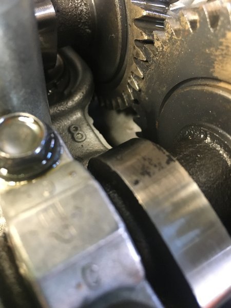

    Ok straw in cyl #1 and i turn cam gear with 19mm to get TDC here the result
    First straw #1 TDC
    Second straw #1 TDC
    *cam dots is not align so i dont take pic*
    But the timing cover at 0
    Third straw #1 TDC
    *little over 0 but i think still 0*
    I think i got the timing correct right?

    looks right by your marks. As long as #1 is tdc.
