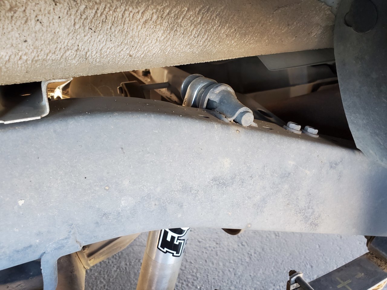

    Here's a pic of my own truck for reference

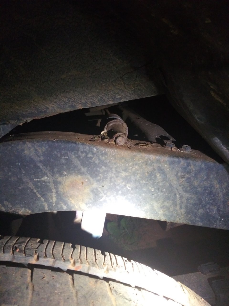

    Passenger side. Best i can do at night

    That's a stock mount, granted someone may or may not have welded it to add strength?
    I'll look at my own truck in a bit.

    Here's mine
