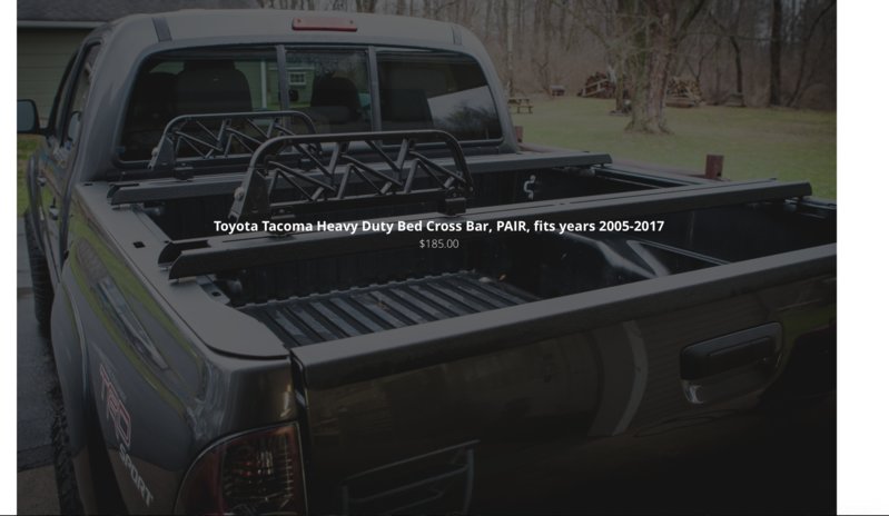

    Hmm, Ever think about getting him to fabricate you metal bedrails and attach the rack to that. Would avoid any more modifications to the truck bedsides. Also with your new total chaos bed stiffener, and doing this you would have fairly tough bed that should not get the known cracking issues in the sheet metal. Plus it would all be removable if you decided to sell the truck and build another?

    That's an interesting idea. I figured that the rack's feet would have a horizontal bar running between them (on both sides of the bed's sheet metal, if possible), but completely replacing the plastic bedrails with new, metal ones could be a cleaner solution. I'll discuss it with Cruisin' when I get my tonneau installed (should be shipping Thursday).

    You could also do the front rail and get a boxed in rack, that should work with the tonneau cover. This is something I was looking at doing prior to the canopy purchase, but I couldn't get it to work out how I was going to stiffen the bed enough to sort out the issue of the sides warping. Now that Total chaos has a bed stiffener, and a few others, It should be easily doable.
    I belieb KB voodoo, BAMF and a few others already have pre made bedrails you could purchase and modify.

    I'm liking this idea more and more. Will look into pre-made bed rails!

    to see what I mean about the bedrails, they show them on their website, not sure if it comes with the cross bars or not.
    Judging from how the bedrails sit, you should easily be able to get Jason to weld on some 1.5" round stock and create your rack from that. Only issue with using the pre made rails is finding out the type of metal so that he can weld properly to it or source the correct materials to do so, that and oh cost.

    Yeah, I'm already looking at them on their site: http://www.kbvoodoo.com/shop/powder-coated-side-rail-cap-system-short-bed-fits-years-2005-2015
    I'm not crazy about the "textured" powdercoat here, but suppose I could get them raw, especially if I'll be making modifications to them.
    It also looks like they will conflict with the TC bed stiffeners, as they use the same bolt to attach... Also, the above link is for 2nd gen Tacomas... I don't know whether they have a 3rd gen option yet.
