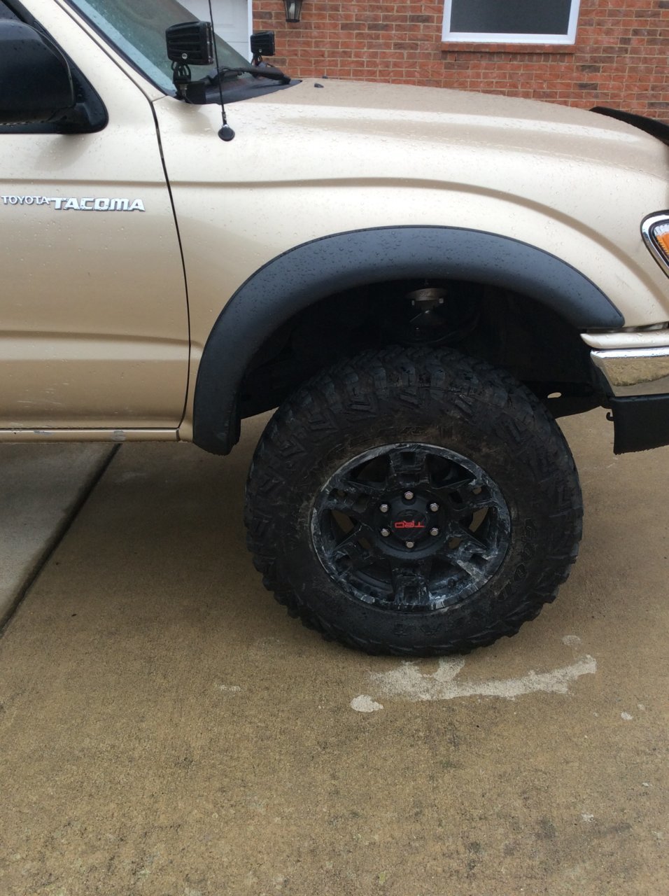

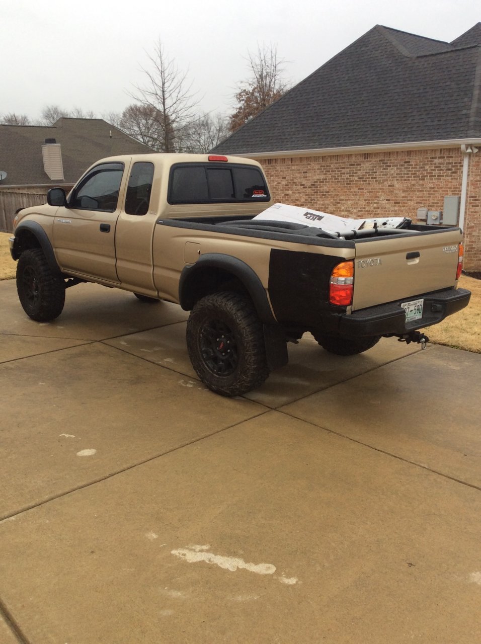

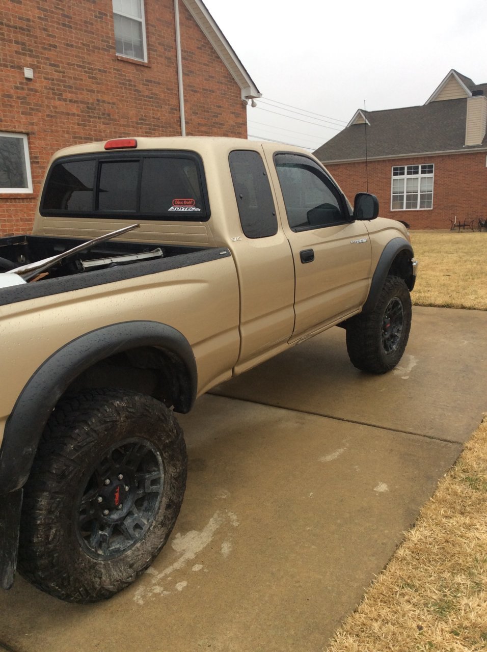

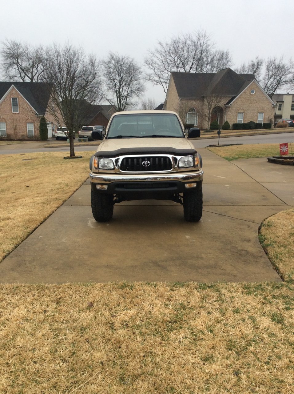

    I wrecked my truck a few weeks ago on black ice. Long story,but I ended up hitting the center median and went into a ditch on the right side. A bolder came under and bent the skid plate and right wheel area. I replaced the radiator, Lower A Arm, Spindle,Ball Joints, Tie Rods,brakes,Rotors, new rear bumper and I just temporarily pulled the bed side out to get it drive able. However the right tire is still back .25 inch. There is no visible frame damage to the naked eye.
    Can a frame shop pull it out you think.
    The truck has 62,000 miles and the inside is like new, loaded with TRD and SR5. It’s a pre runner. 15 TRD wheels and a toytec lift with 5100s and coilovers. What do you think I can get out of it in its current condition? It’s drivable but still needs that issue above addressed. I’m thinking of going to a new 3rd Gen. Clear title.
