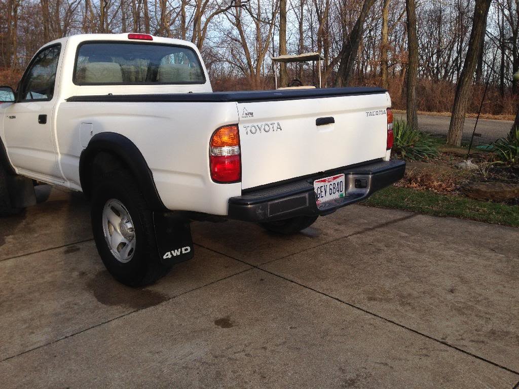

    So obviously I'm new to the forum and don't know many of you, I've always been a forum lurker but I've finally decided to pull the trigger, join and make a thread. Feel free to make rag on my ideas/truck I have some pretty thick skin lol.

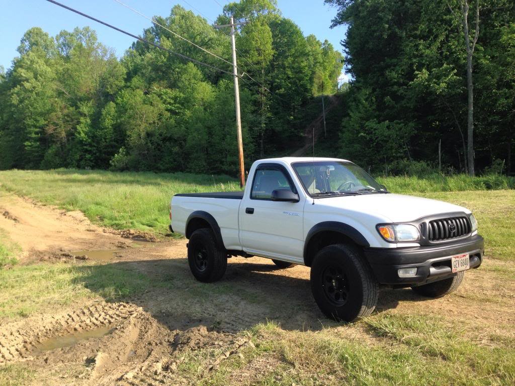

    So here it is, 2003 Tacoma, 101k, 4cyl, 5spd, 265/75/16 tires, and plenty of rock chips.

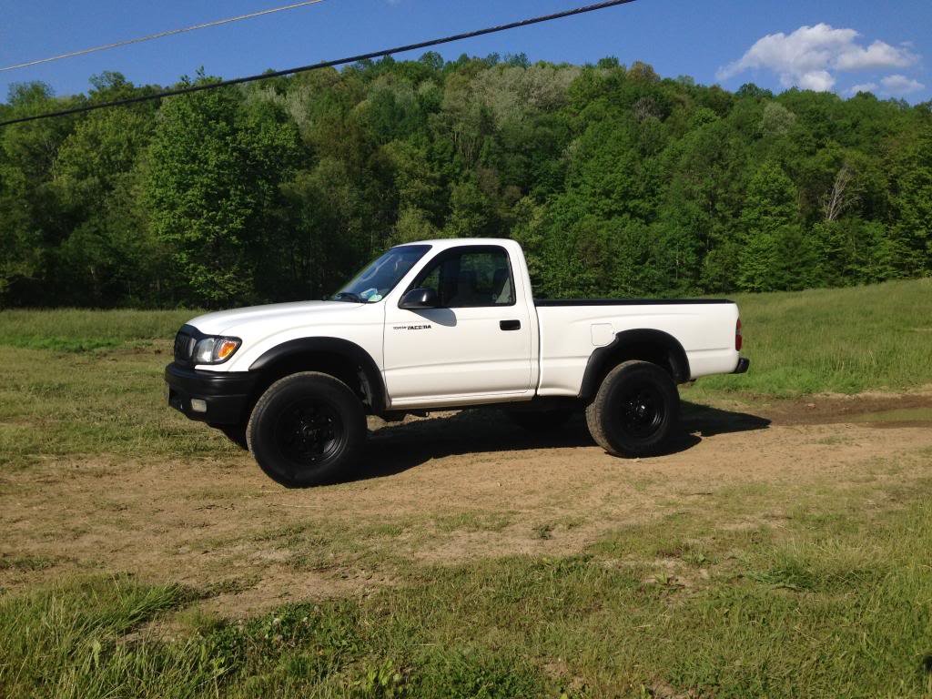

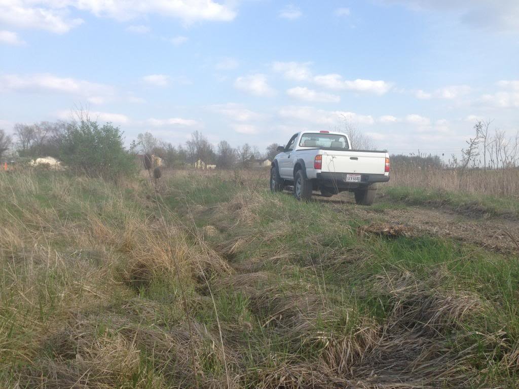

    I am in college at The University of Akron for Construction Engineering and have been working the last three years of school to scrape up a few pennies and get back to my roots and get a 4x4. I totaled my Jeep Cherokee right after I graduated highschool
    Then shortly after I got a Ford Contour :anonymous: So after two years of the Contour I picked this piece up.

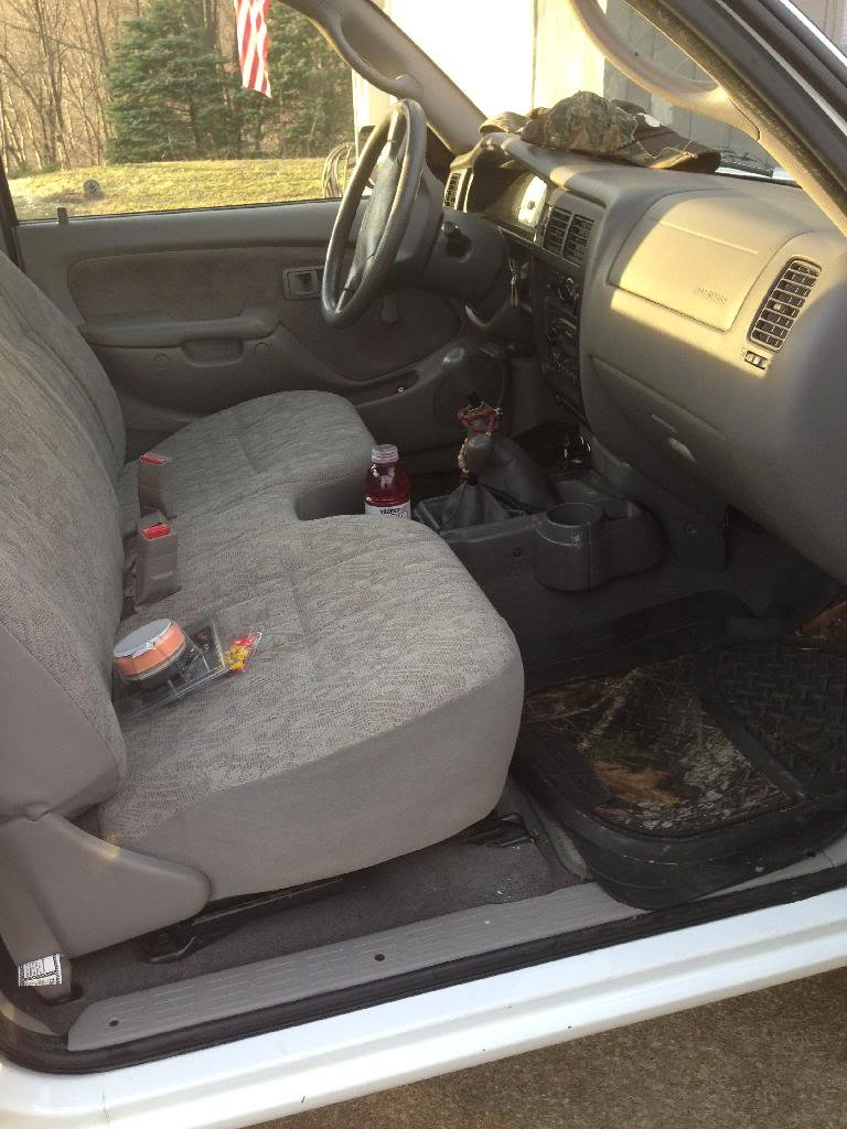

    Bench Seats can go to hell.

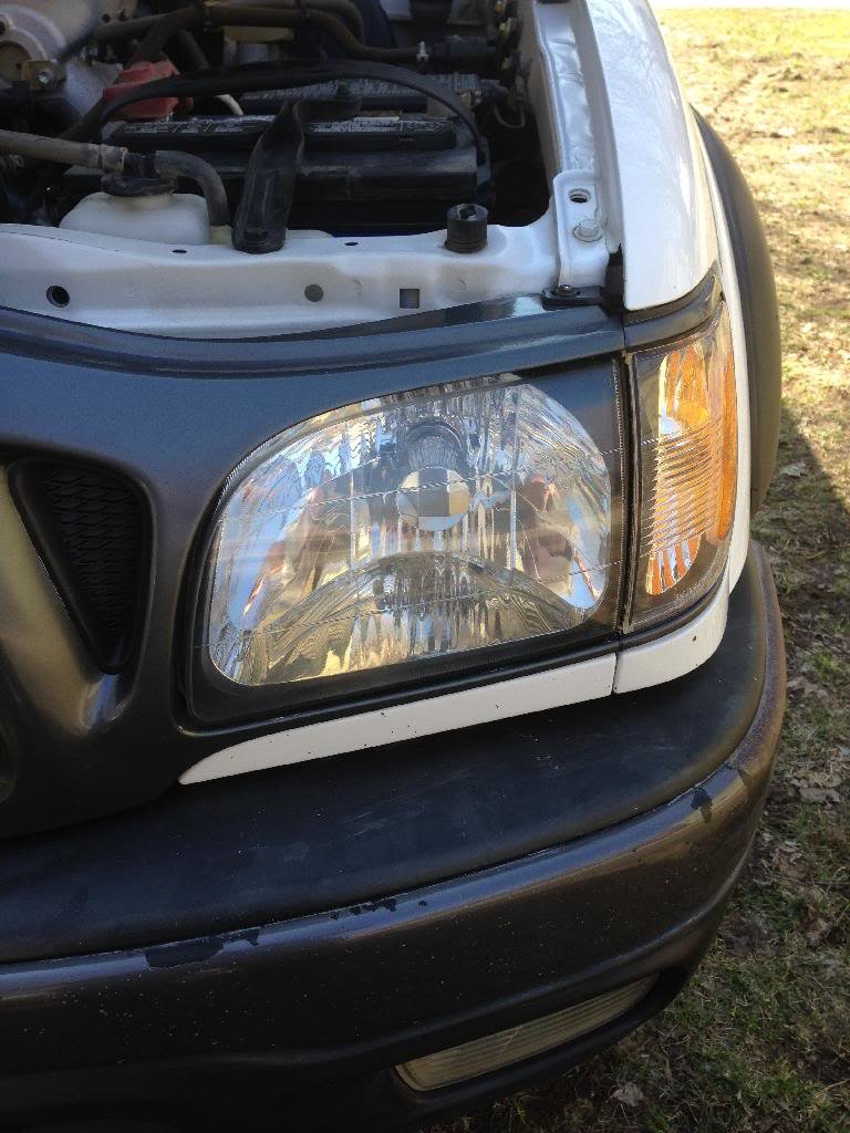

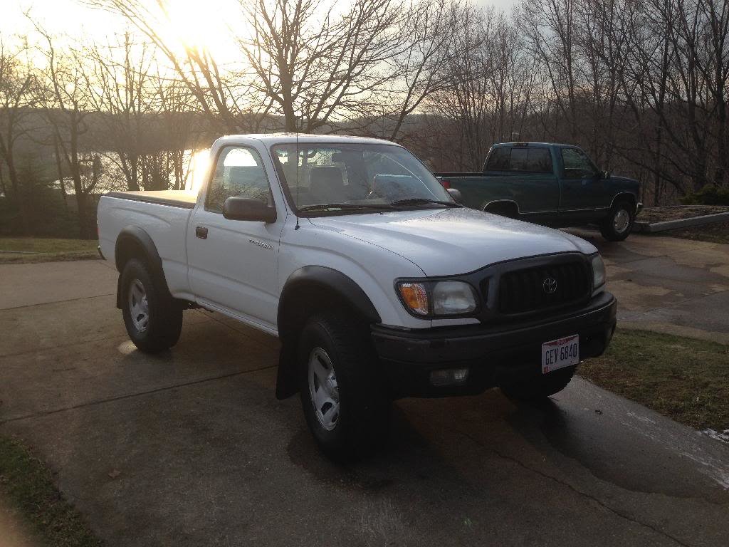

    So first thing first, my headlights they were quite foggy
    FF99BC2E-2D97-4FFA-A9AB-EC8D62EB814F_zps_9ee4deb8aa42290d97ddd291ab871dec4404a613.jpg
    So I polished the best I could without sanding them to try to keep the UV coating intact.
    C80FADBC-8015-4C2D-ABCA-FDEB7CB4E54B_zps_6e7b2700ceac2dc0d850d9ea7701525bf1fe287b.jpg

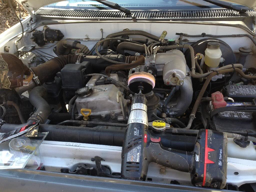

    Heres a Picture of the engine bay while I'm at it

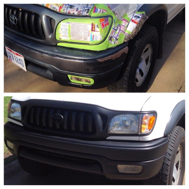

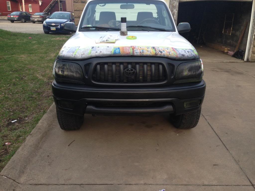

    So I have a good bit of experience in Plasti-dipping things, my roomates are into "stanced" cars and we have Plasti-dipped entire cars multiple times, with spray cans and then an actual Plasti-dip gun and quite a few little odds and ends pieces, so needless to say I felt up to the challenge of dipping my bumpers and grill that were in need of attention.
    F4EA2CFD-8372-4151-AB20-58EFB273C8FC_zps_b5df89748074a1fa9be654354b83772a62cd5d7a.jpg
    077887C7-1C3F-46AF-A980-3DBFD0B22477_zps_11f505e1636f78ae3a6d2b116a36022ecd6d2f77.jpg
    Taped off and ready to go, so I got to work
    F4E387BE-0A8E-4973-BC00-0BF19B8DF897_zps_12ff45198aeaade66daf536605da8965a0462275.jpg
    I think it turned out pretty good for two cans of Plasti-dip and 3 hours

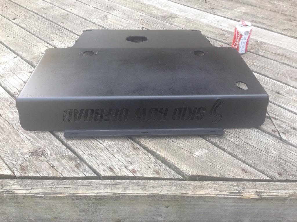

    So over the past few days I've been screwing around with my taco. Mainly because our internet has been out and I haven't been able to get on here :smash:

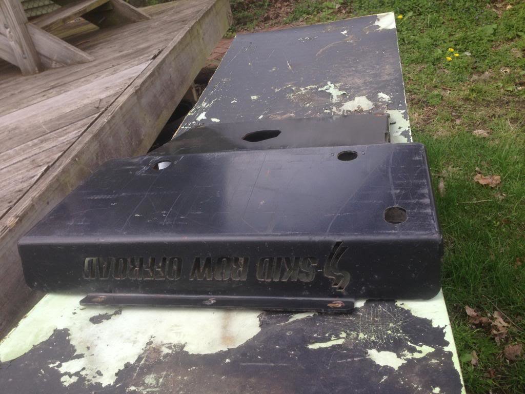

    First thing was a craigslist find on a skidplate. Its a SkidRow Offroad skid plate that cost's over 300 bucks brand new and I talked the guy down to 40, so I'm gonna take that one as a win although it needed some new paint.
    Here's the beginning product ( dont mind our ragged old broken pong table):
    5243D43D-F217-4EC6-90DB-C442DAA984C1_zps_fcff2c4dc5883f6153afc6a65489d9a81d83cd8e.jpg
    After a few coats of the old rattle can:
    1F9EDB19-9326-46B9-B6D2-EB5F501D923B_zps_fa086de43b5a01ff3b5056332b3e85367a852f49.jpg
    Bolting it on took a bit of persuasion, I did it by myself so it was a pain in the ass to hold up and keep aligned on the truck. And it was also a pain to slide under the truck with my mudflaps on that I've been meaning to take off, so off they went.I started by loosely mounting the front bolts. Then when I got to the rear mounts it was about a quarter inch too short on both sides, I had tto get a little creative with our floor jack and it a little persuasion using the pressure from the jack and the hole for the oil filter. I got a little scratch in the paint but I plan on getting a few more anyway :mudding: . All in all it ended up pretty nice if I don't say so myself.

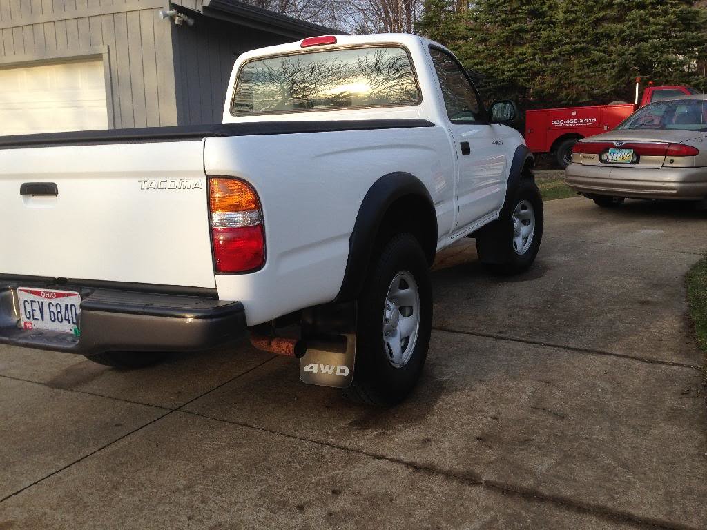

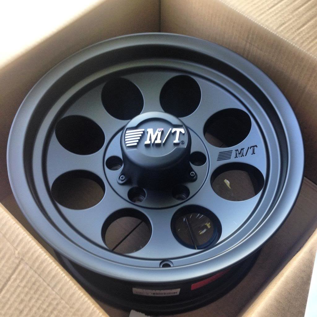

    So its finally done, I want to thank Summit Racing for amazingly fast and painless service when ordering my wheels and lug nuts. I ordered everything late on a Tuesday night and recieved my lug nuts Wednesday afternoon, Thursday I had 3 of the wheels waiting beside my garage and Friday I had the fourth( had to be shipped from Georgia instead of Akron).
    Wheels:
    Mickey Thompson Classic 3
    16x8 6x5.5 with 4.5" Backspacing
    Lugnuts:
    Summit Racing M12x1.5 Spline Drive Lugs.
    URL=http://s1144.photobucket.com/user/cmf88/media/E2A2CF60-DEE5-4DAB-80EA-5500017E8F47_zpsti7pm1zh.jpg.html]E2A2CF60-DEE5-4DAB-80EA-5500017E8F47_zps_862d5a374abd7e9b0b691e99aeaadec14451d42a.jpg[/URL]
    After test fitting my wheels to check for clearance issues, I took it all down to the tire shop to have some free 265/75/16 General Grabber HTS tires mounted on these wheels. I want to save my old tires for winter and get new 32x11.50 tires in the spring as well as a minimal lift.
    B74F85A4-C2F2-471D-8395-B2F1AEBF39F0_zps_7424bdec5ca9d1b33a0eb6e8b3853b62adcc30b6.jpg
    After the jackass kids struggled to get the front wheels on(they are a little tricky for some odd reason) I was finally set to go.
