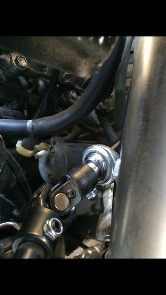

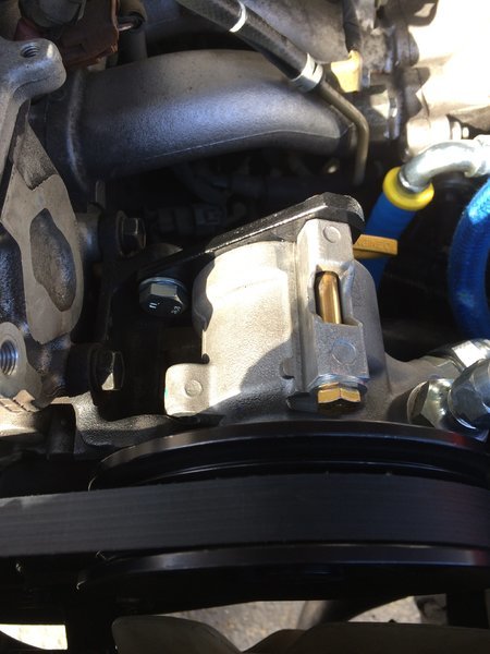

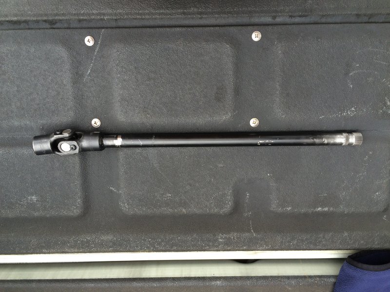

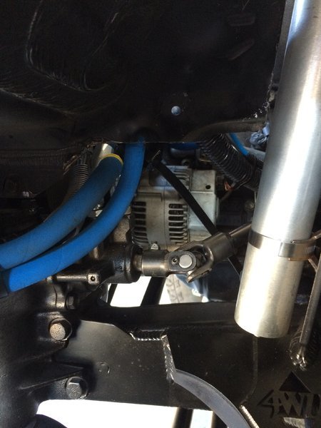

    I have managed to re-do the steering u-joints & shafts, fire wall plate, steering pump and have added 1 bracket I made to work with the OEM bracket. The lower portion of the OEM is now a pivot point, allowing the pump to roll towards the battery. The black bracket behind the pump holds it in position. This gave me a 1/4" clearance for the radiator hose and the low pressure hose to the pump from the reservoir.

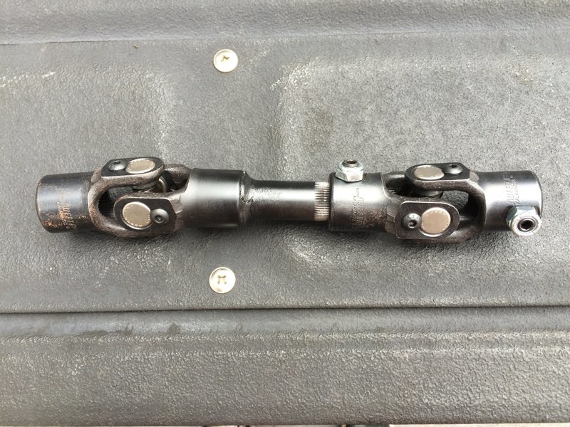

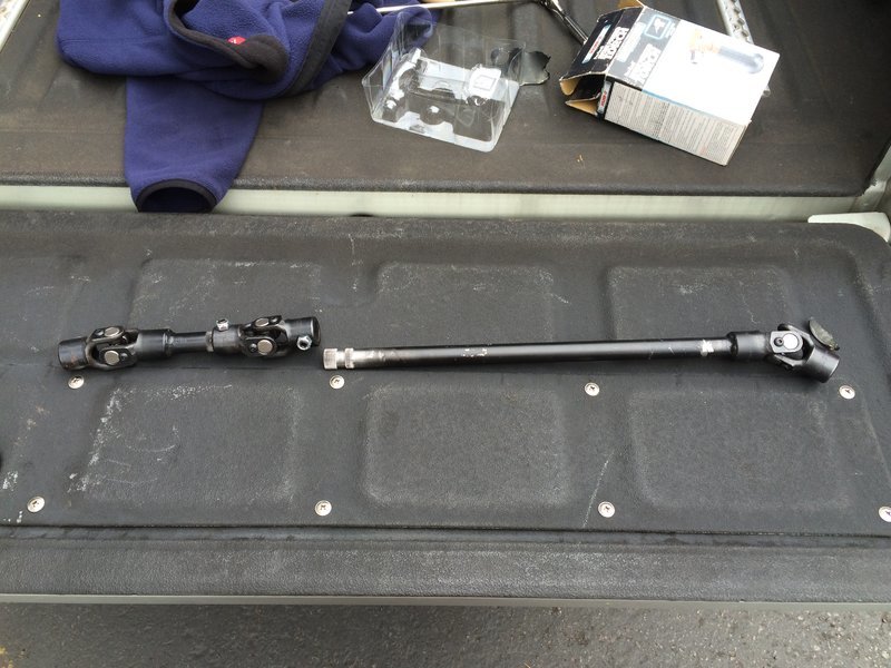

    As for the steering shafts & joints, here are pics prior to install:
    Steers great now.

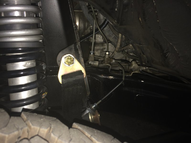

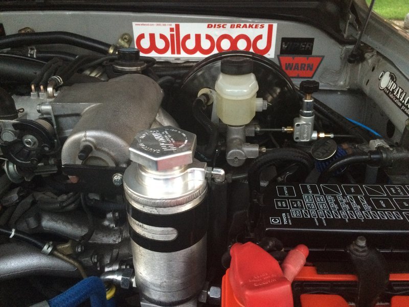

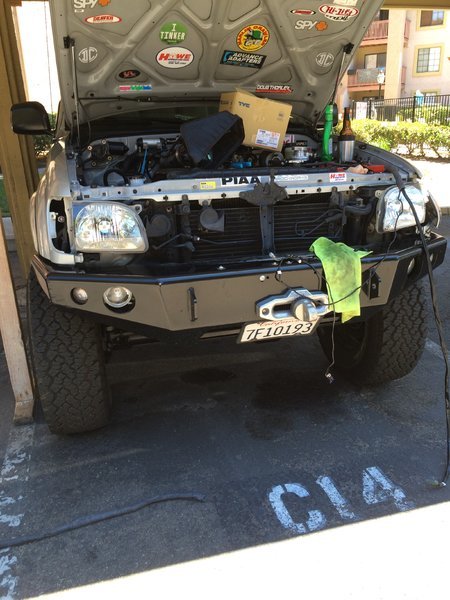

    So I spent most of yesterday completely removing the ABS system... what a bitch!
    1st off, thanks to Davidpick for the link to his ABS Delete mod seen here: https://www.tacomaworld.com/threads/abs-delete-2001-2004-tacoma.377243/ There are a couple things he did that I didn't which in my case involved SAS'd parts, like larger shock towers and a steering shaft.
    The OEM lines are perfect. I did slightly modify the smaller RT & LT hard lines that attach to the steel braid brake lines and, I ended up swapping those lines from LT to RT & RT to LT. They just worked better getting around the shock towers. The LT hard line from the 'T' down to the fitting on the frame, I did install it upside down due to the spirals in the line making contact with the steering shaft. Fits like a glove.
    The Wilwood proportioning valve is awesome, light & compact. As for now, I have it set 3 turns from the fully open setting.
    Also, doing this mod cleaned up all of the bent & twisted lines that happened during the major portion of the project, really cleaned things up. No longer do I have hard lines attached to the fire wall and wrapping around here & there. All appears OEM with the exception of the proportioning valve.

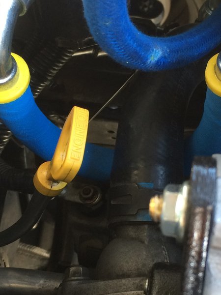

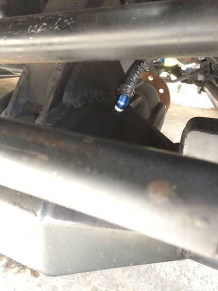

    On Saturday, I spent some rare free time and extended the front diff breather into the engine bay. It came out clean.
    I figure another 3-4 weeks and I should be ready to get her out to test everything.

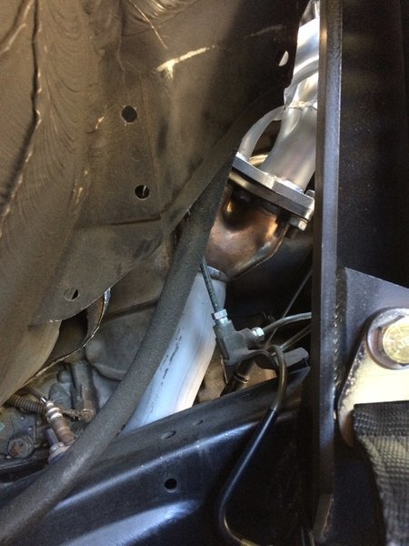

    Yesterday, I installed the new Doug Thorley header and new cat. Finally, all exhaust leaks are gone.
    Now CO's & rear shocks will be picked up tomorrow and installed next weekend, then, I can install the compressor.

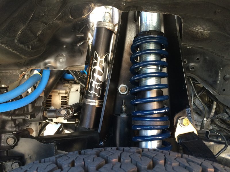

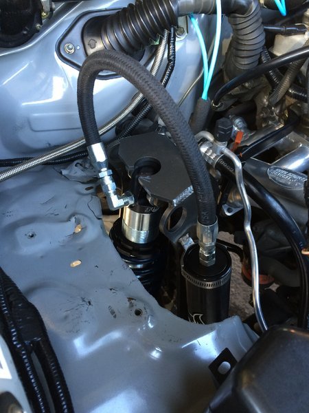

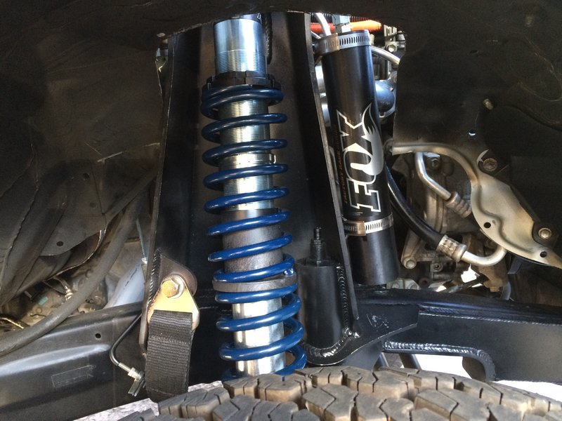

    So the new Fox CO's are on and are awesome. All 4 corners were weighed and springs set accordingly. What a large improvement over the RadFlo's.
    I did some fenderwell trim clean-up while I was in there. I will add sheet metal in the passenger side to eliminate the large overcut section. Once that's done, I'll Flex Seal the area to match the OEM seam sealer.
    Over the weekend, I did install a new Doug Thorley header and a new cat. Also, wired up the front locker solenoid and tucked all wiring back into an OEM looking loom and installed new headlights.
    I am awaiting 1 - 90 degree fitting that will go on top of the passenger side reservoir. Routing this hose below the shock tower will allow my compressor to sit in there nicely.
    Driver side CO complete.jpg Passenger side CO complete.jpg Rewiring Compressor.jpg Ready for compressor.jpg New headlights.jpg New Cat.jpg

    Driver side is 200/250 and passenger is 175/250. Both CO pressures are @ 200. This leaves me with 5.5" of up travel and 6.5" down.
    The bleed hole on both was enlarged to an unspecified size.
    The front DS weight is 1,226 and front PS is 1213. Rear DS weight is 956 and PS is 840. Weight is now 58% front and 42% rear.
    Rides & drives like a dream now.
