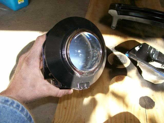

    I was in the hunt for those a while back too, but they are impossible to find and ACAHID went out of business. Plus they are rediculously expensive. I actually just got some extra headlights, because I am about to do a HID projector retrofit.
    If you want to get halo headlights, I would do a projector retrofit.Now If you don't want to buy those expensive projectors, ballasts, etc., there are still more options. You could retrofit some Acura MDX halegon projectors. They sell for pretty cheap, like $40 a pair. Then get some CCFL halo rings from Oznium.com in whatever size you need. Finally get some shrouds to dress up the projectors, you get you lawn light covers for a cheap, effective shroud. Then open up your headlights, install the projectors, install the halos, and put everything back together. If you think about it, you just spent $70-$80 for $1400 projector halo headlights by doing it yourself.

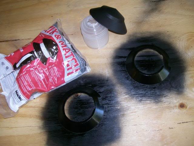

    Yep, for dressing up the lawn. You could by expensive projector shrouds, but my buy them when you can make them for cheap. Here's a pic of what I mean:
    I will be taking pics of my install.
