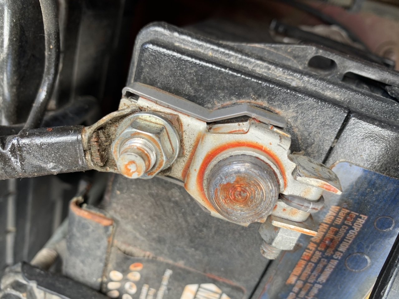

    Edit: You need 90982-06022 for the negative cable (Grey plastic)
    Then modify the existing cable/terminal by cutting off the clamp portion to leave a square tab with a round hole in it. Now fasten that to the new terminal with included but, and you are done. It even looks OEM!
    let me know if you need a pic of the finished product

    Yeah both of my Tacoma’s that clamps has slowly failed due to cracking. I think it’s design allows over-tightening which leads to cracking. Here is a pic of what I did. I recall that you have to trim the connector with tin snips slightly since the edges of it are turned up.B77408B9-DC59-43D0-BDA7-23D908163512.jpg
