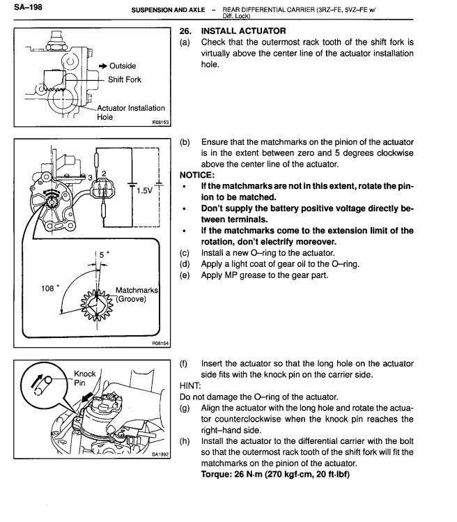

    OK I have locker off. See the key sliding on bar. Which way do I side it. Towards differential or wheel?

    I think toward the wheel

    Unless you sync the exact tooth of the motor actuator pinion to the exact tooth of the locker rack gear as shown in the FSM you have no way of knowing if it is correct. It can be off and still "work" just not fully engaged or disengaged as was likely the case at the get go. And yes, possibly causing damage, more so when putting a load on it when you think it's fully locked.
    Your call.

    I definitely want it to be right. I am struggling to comprehend the diagram tho.
    By sliding it all the way right towards wheel it seems to have fully unlocked it and when I engage the locker switch it seems to lock and I can feel it in wheels.
