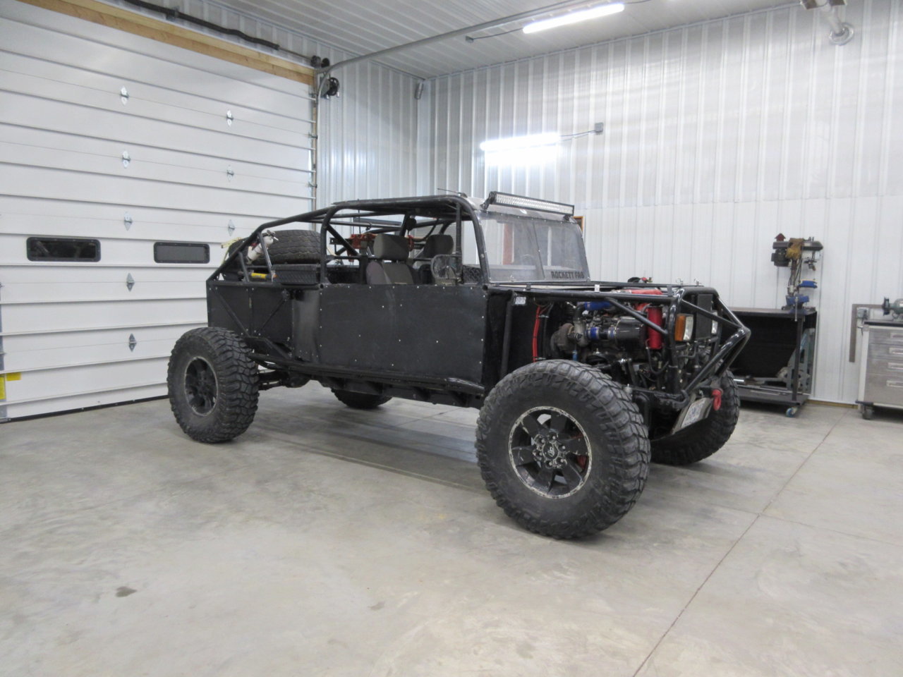

    Tacoma based buggy
    all of them
    suspension:
    front:
    - 3.5" over control arms
    -tundra eibach pro-truck Sport (added delrin bushings, and a nitrogen port)
    -ome 885
    -fabricated spindles (to hold the tundra unit bearings)
    Rear:
    -all pro 5" lift springs mounted sua
    -12”shackle
    -fox 14" bypass shocks
    -limit straps
    -rough stuff high clearance u-bolt plate
    chassis/body:
    -back halved stock frame
    -lexan windshield, and paneling
    -3/16" skids bracing on top
    engine/trans:
    -Greddy turbo (roughly equivalent to a 2860r)
    -non-intercooled
    -AEM water meth
    -AEM fuel pump
    -AEM fic6
    -3" exhaust
    -emissions equipment deleted
    electrical:
    -heavily thinned factory wiring
    -blueseas fuse box
    brakes:
    front:
    -tundra calipers and rotors
    -stainless steel braided brake lines
    rear:
    -willwood brake proportioning valve
    -willwood 2lb residual pressure valve
    -prelude front calipers
    -tacoma front rotors
    drivetrain:
    rear:
    -second gen 8" rear axle (e-locker)
    -nitro 5.29 gears
    front:
    -second gen tundra 9" diff, cv, and unit bearings
    -nitro 5.29
    -welded diff
    -shortened a.d.d. shaft 140mm
    -re-heat treated a.d.d. shaft
    -custom steel a.d.d. tube
    miscellaneous:
    -37x12.5x17 cooper stt pros ,
    -emgo 12k winch on 2in receiver (mounts front or rear)

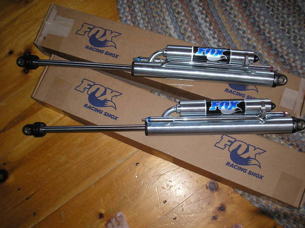

    :D got my shocks today some 14"stroke 2"body 2 tube fox bypass shocks...should go nice with mid travel

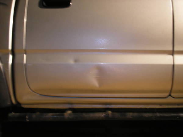

    i got this nice ding in the door while wheeling yesterday.no idea what i hit just found it when i got home. good thing i have sliders otherwise it might have been allot worse.

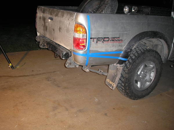

    the bottom line is the line actually being used for the new high clearance rear bumper
    one side down! i made the cut angled like it is so i don't stand out to much and it should still work the same, maybe better cause ill be able to kinda slide off obstacles. side note but i think it makes my truck look faster.

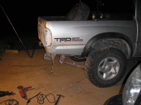

    lined every thing up and tacking it in to place.
    im pretty happy with how it turned out.ill test it out tomorrow and see if it was worth cutting up my truck
