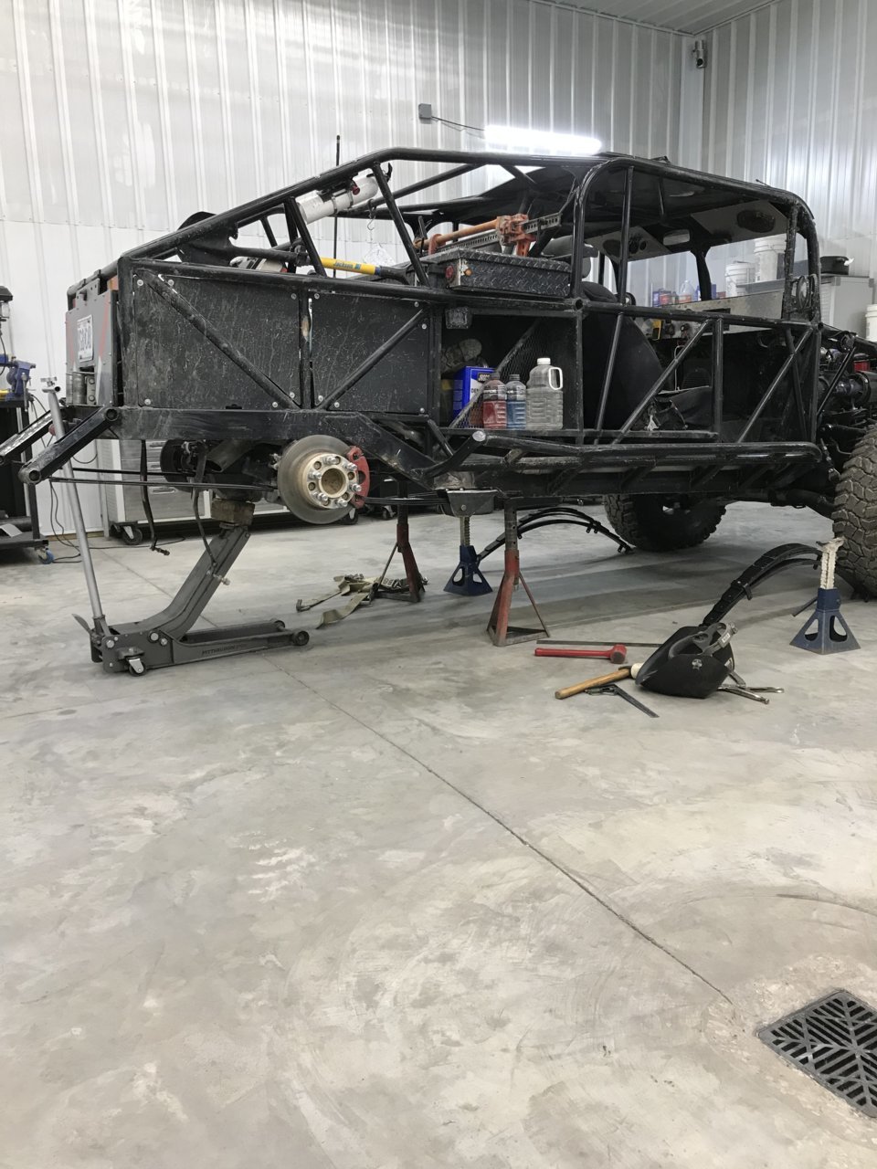

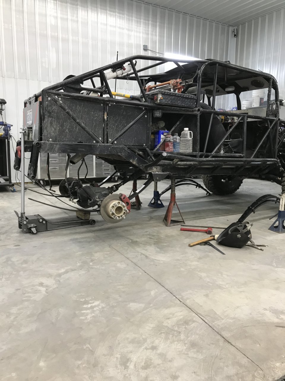

    Blew out another 8” e-locker rear so I decided to beef things up a bit. Picked up a tundra 10.5 rear. This thing makes the 8” rear look like a toy.

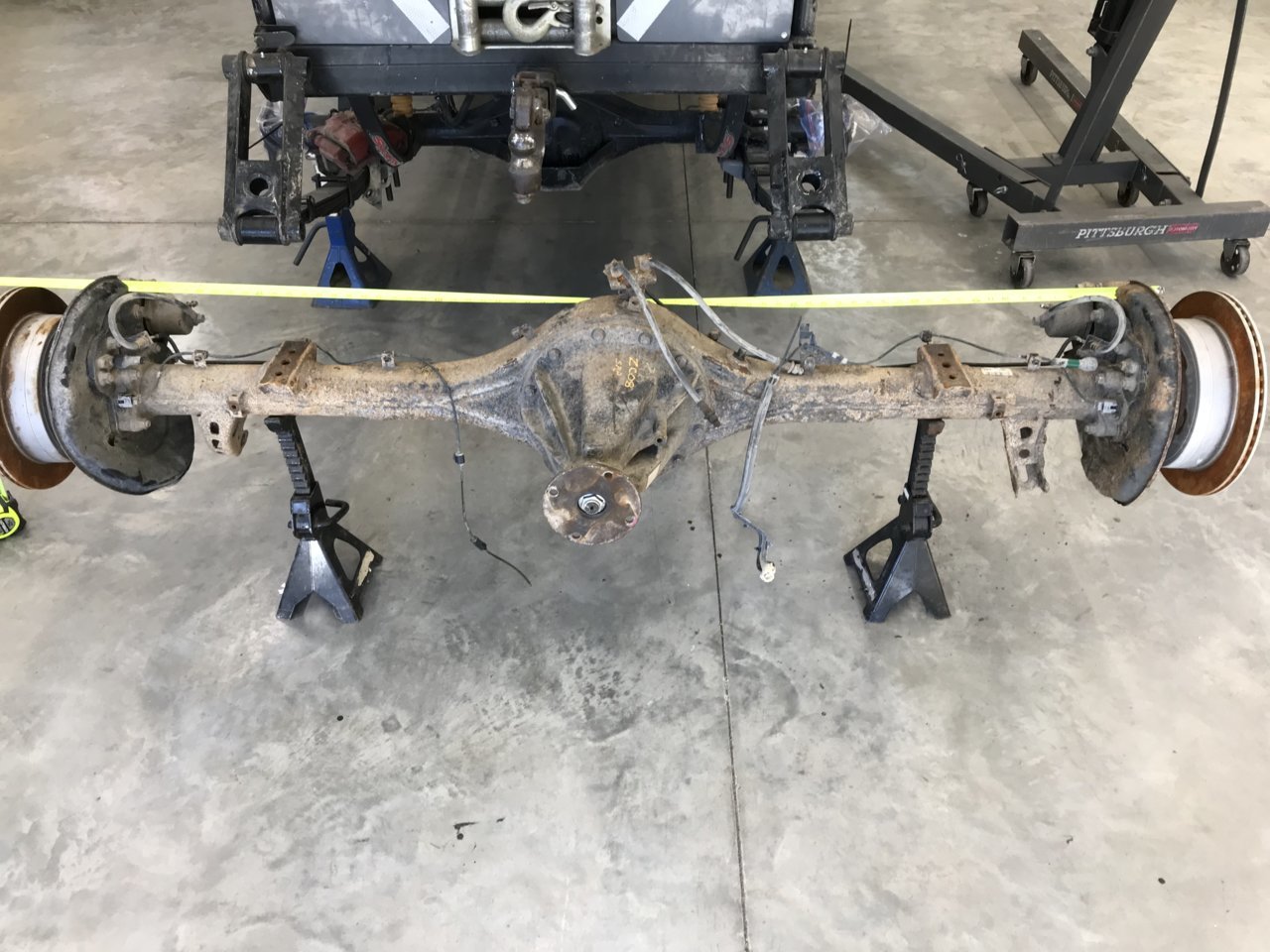

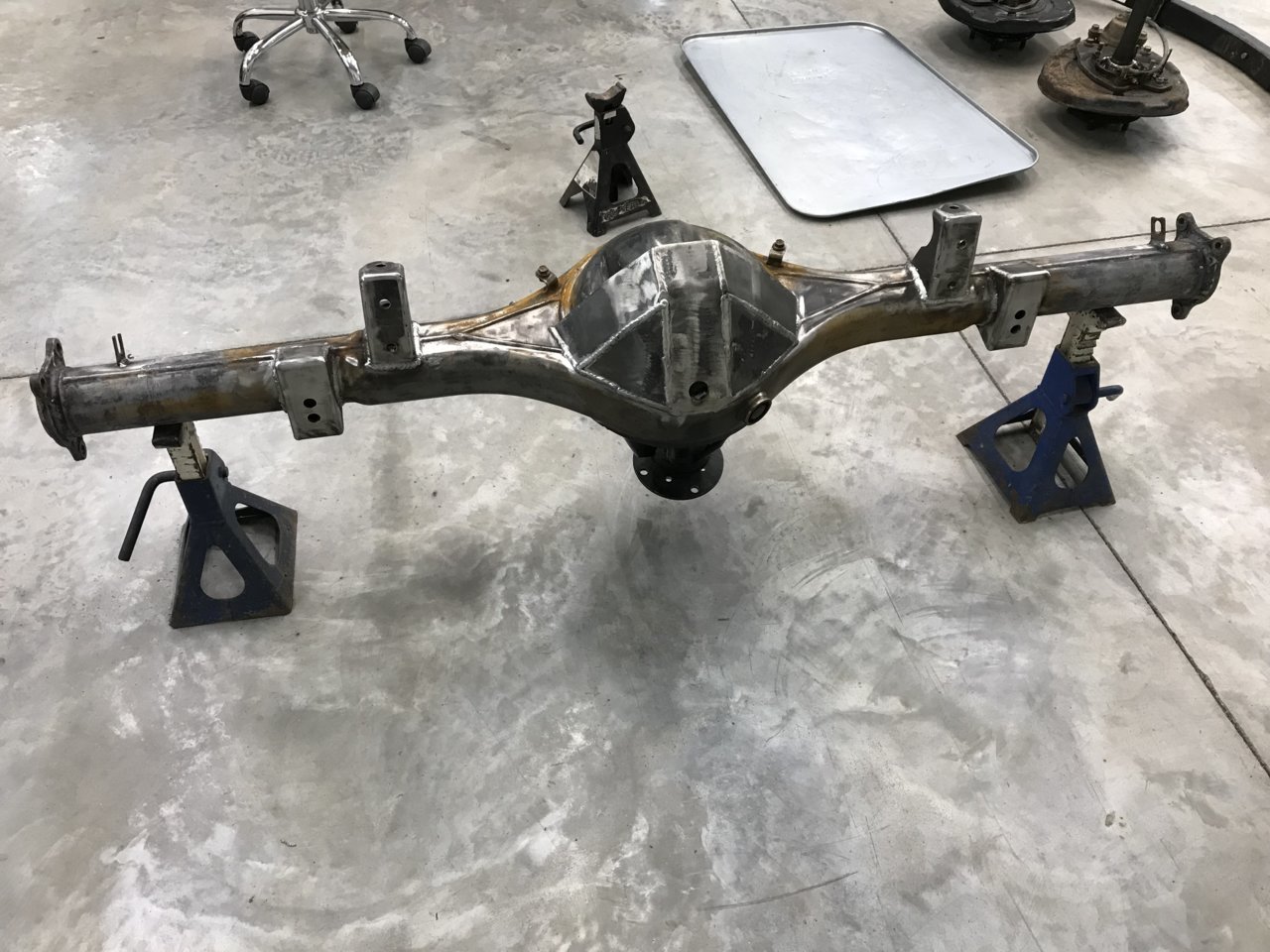

    For future reference because I couldn’t find it when I was looking in to these axles, a second gen (07-21) tundra 10.5 axle width is 72” wms-wms.
    Pinion mounting surfaces to axle centerline is only .875” longer then an 8” e-locker.
    Stripped down axle with no brackets or brakes weights 274 lbs.

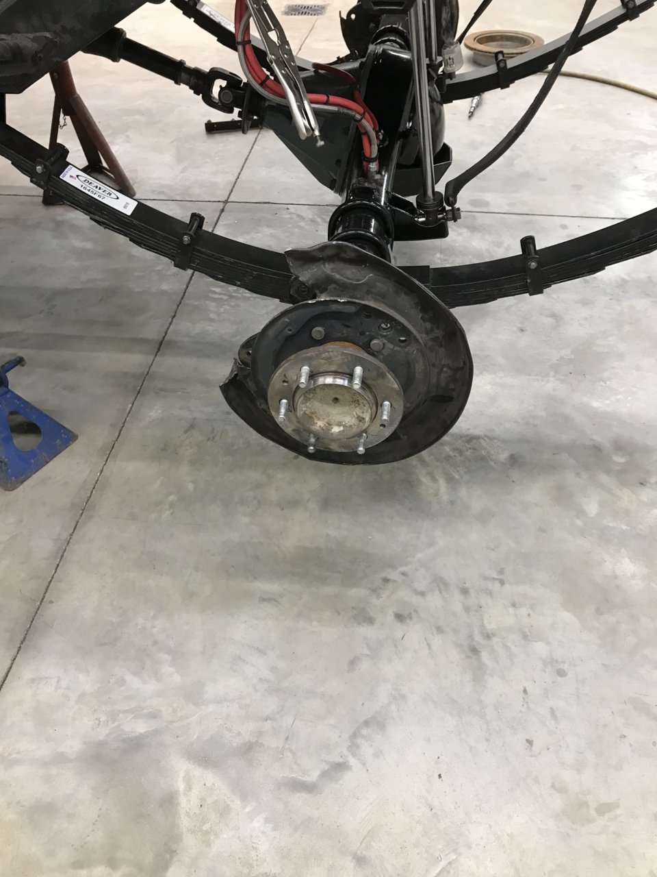

  7. Jul 13, 2022 at 6:59 PM
    #207
    livel0veryde
    livel0veryde [OP] Well-Known Member
    Jun 17, 2011
    #58450
    960
    josh
    missouri
    Tacoma based buggy

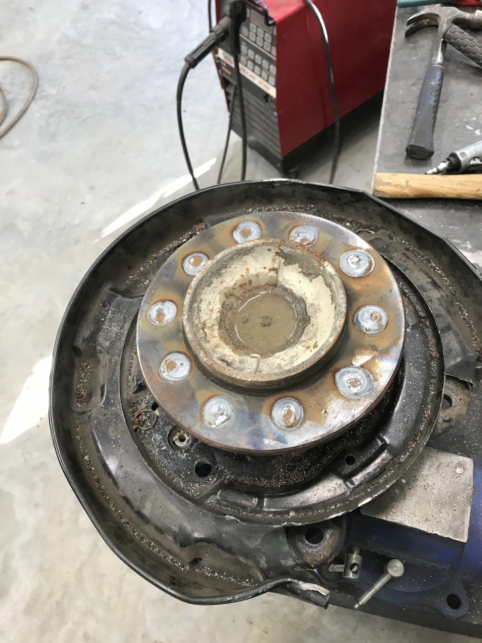

    Got the third set up, 5.29s and an arb. Axle’s all cleaned up and painted. Still gotta finish converting it to 6 lug, do a little bit of wiring, and plumbing.

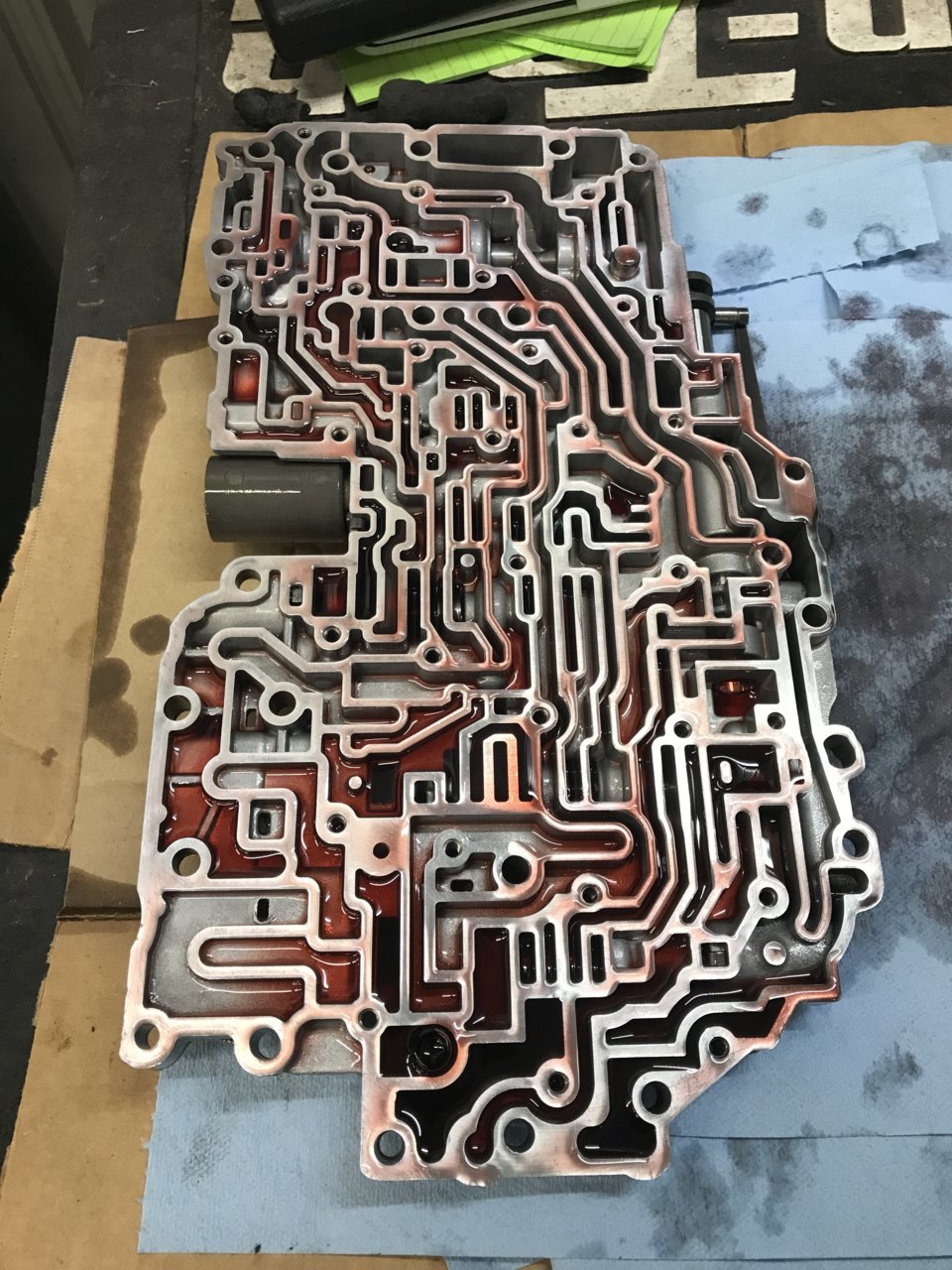

    Finally got around to installing the transgo hd2 shift kit after it sat on my shelf for about 2 years. Wasn’t too bad of a job took an evening to knock out. Went with the truck settings and I’m pretty happy with it. Definitely an improvement over stock though personally I wouldn’t mind if the part throttle was a bit firmer and the full throttle was a bit softer.

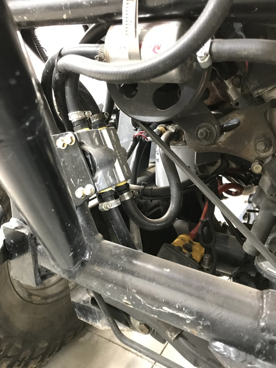

    missouri
    Tacoma based buggy

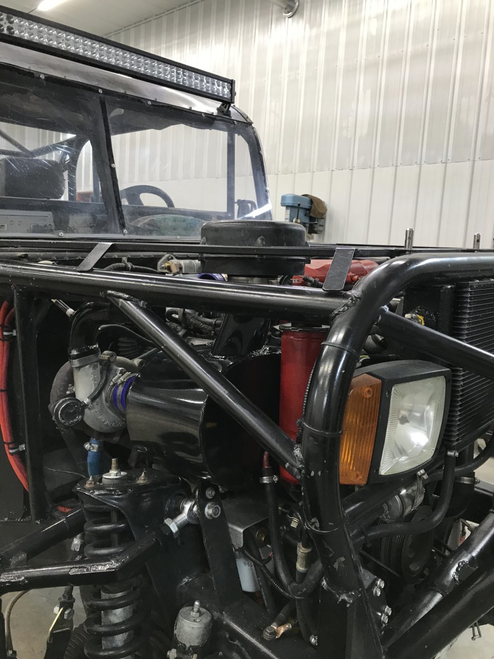

    Trans cooler setup I did a while back. Big Hydac 12x12x3 hydraulic cooler (repurposed from cement mixer), inline thermostat, and 12” thermostatically controlled spal fan. Repurposed old trans cooler to ps cooler and mounted it in front.

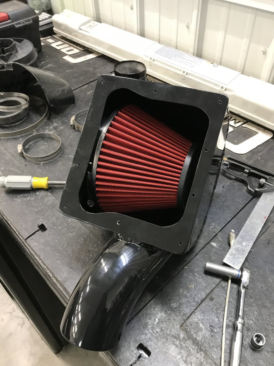

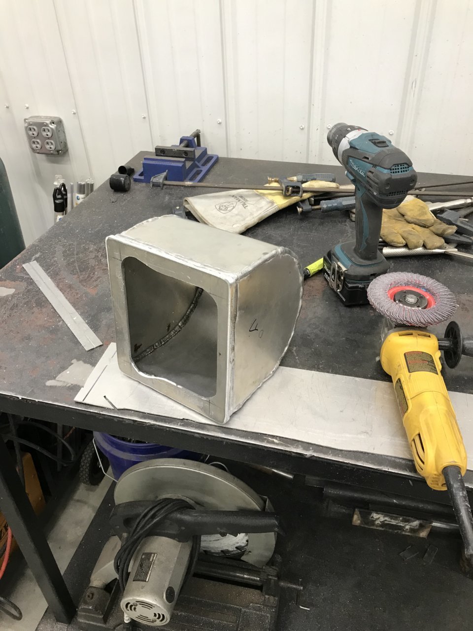

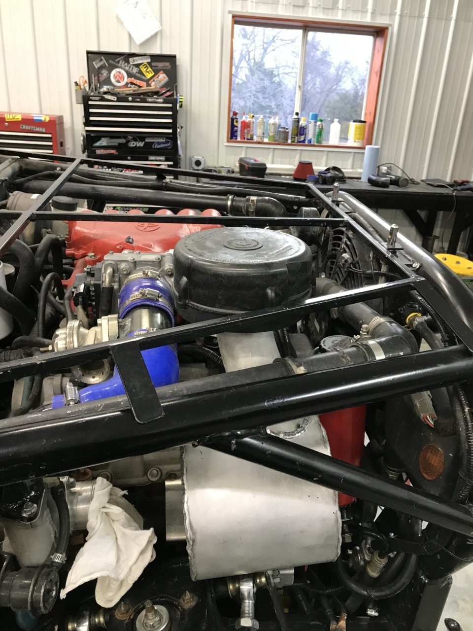

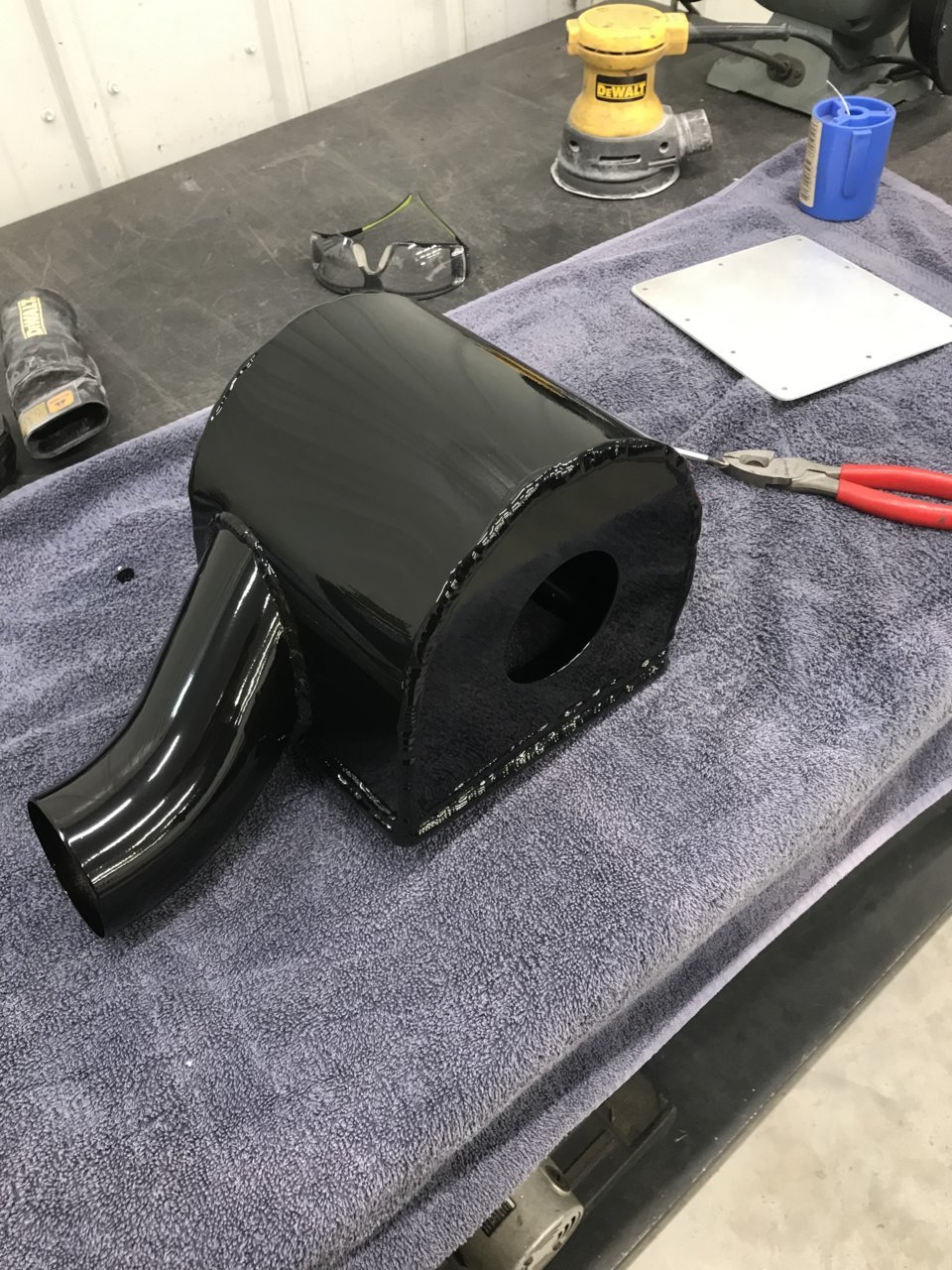

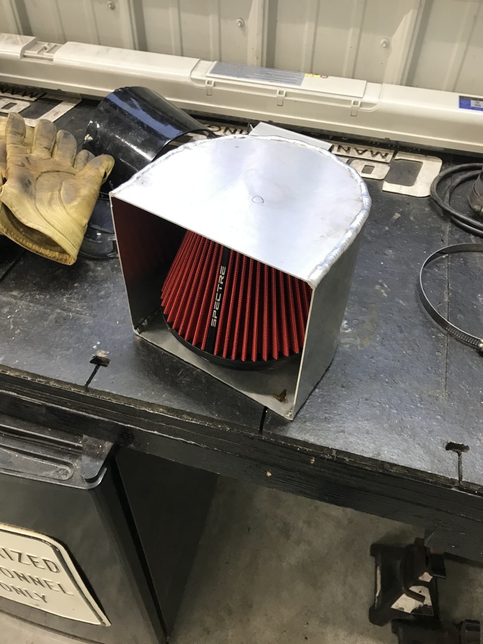

    Had some free time and some scrap laying around so I finally built myself an air box. Went ahead and topped it off with a nice pre-cleaner.

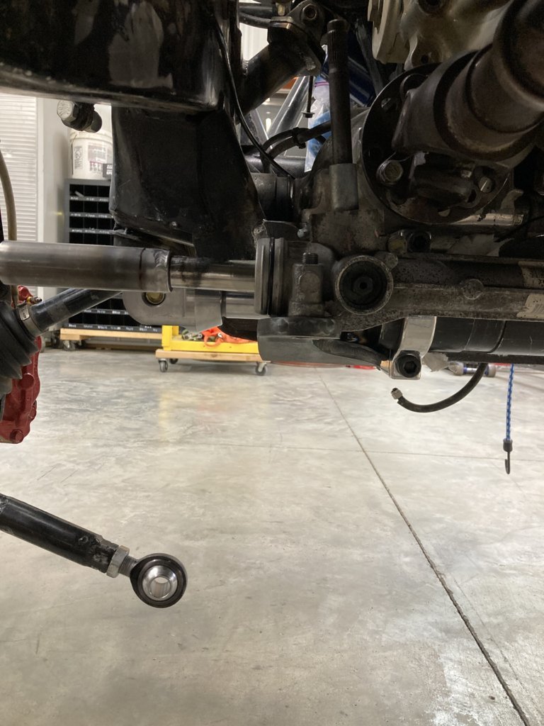

    missouri
    Tacoma based buggy

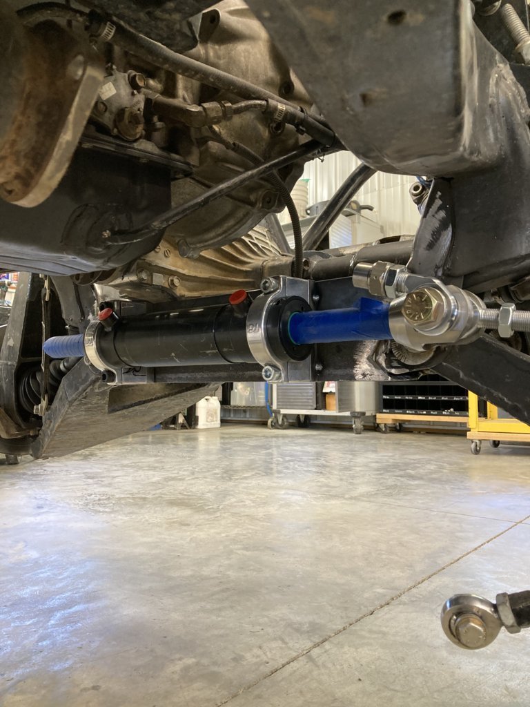

    First gen steering rack wasn’t cutting it anymore. Putting together a 4500 style steering kit. De ram, Woodward servo valve, manual steering box, and a Psc pump.
    Got bump steer down to a negligible amount.

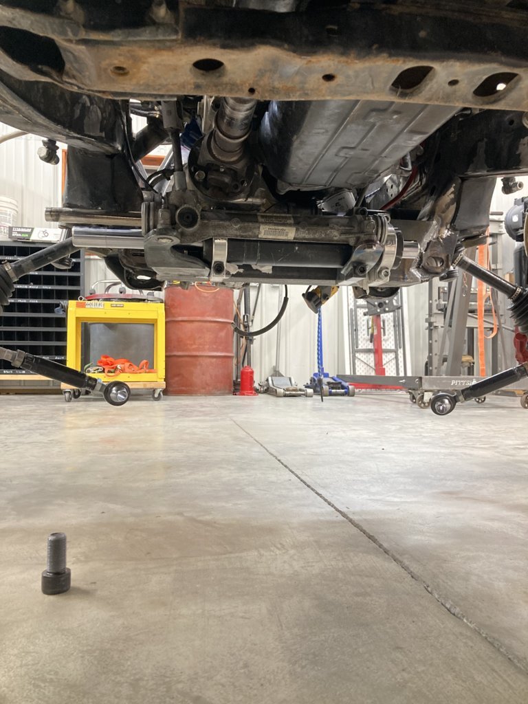

    missouri
    Tacoma based buggy

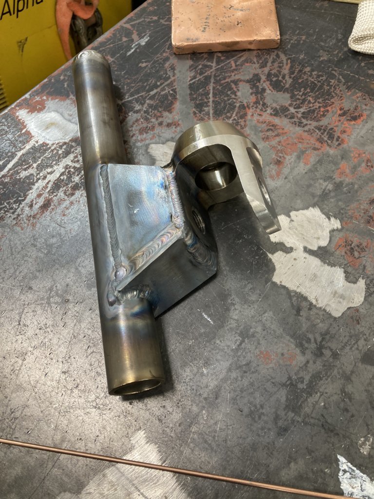

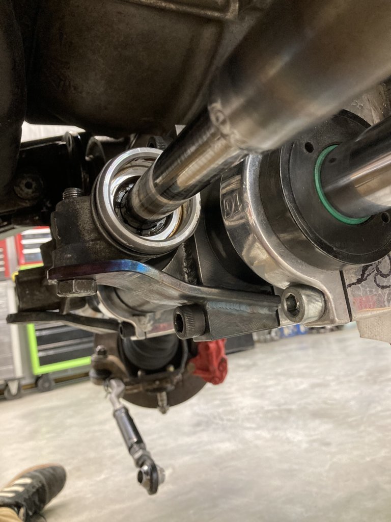

    Was going to do a conventional 4500/4600 style steering using a steering box and drag link but after getting the ram where it needed to be and holding it up there I decided it just made more sense to use a rack instead.
    After scouring the Internet, I settled on a Fiat 500 abarth rack. It’s a rear steer electric over manual rack with the correct travel and a pretty quick ratio (just under three turns locked to lock).
    JTFisherman, Slashaar and Dalandser like this.
  14. Nov 10, 2024 at 11:02 PM
    #214
    livel0veryde
    Jun 17, 2011
    #58450
    960
    josh
    missouri
    Tacoma based buggy

    Are you a fabricator by trade or just really into the hobby? :rofl:
    I need more time in the lab before I could confidently tackle something like that.
  16. Nov 11, 2024 at 6:37 PM
    #216
    livel0veryde
    Jun 17, 2011
    #58450
    960
    josh
    missouri
    Tacoma based buggy
    Hah both I guess.

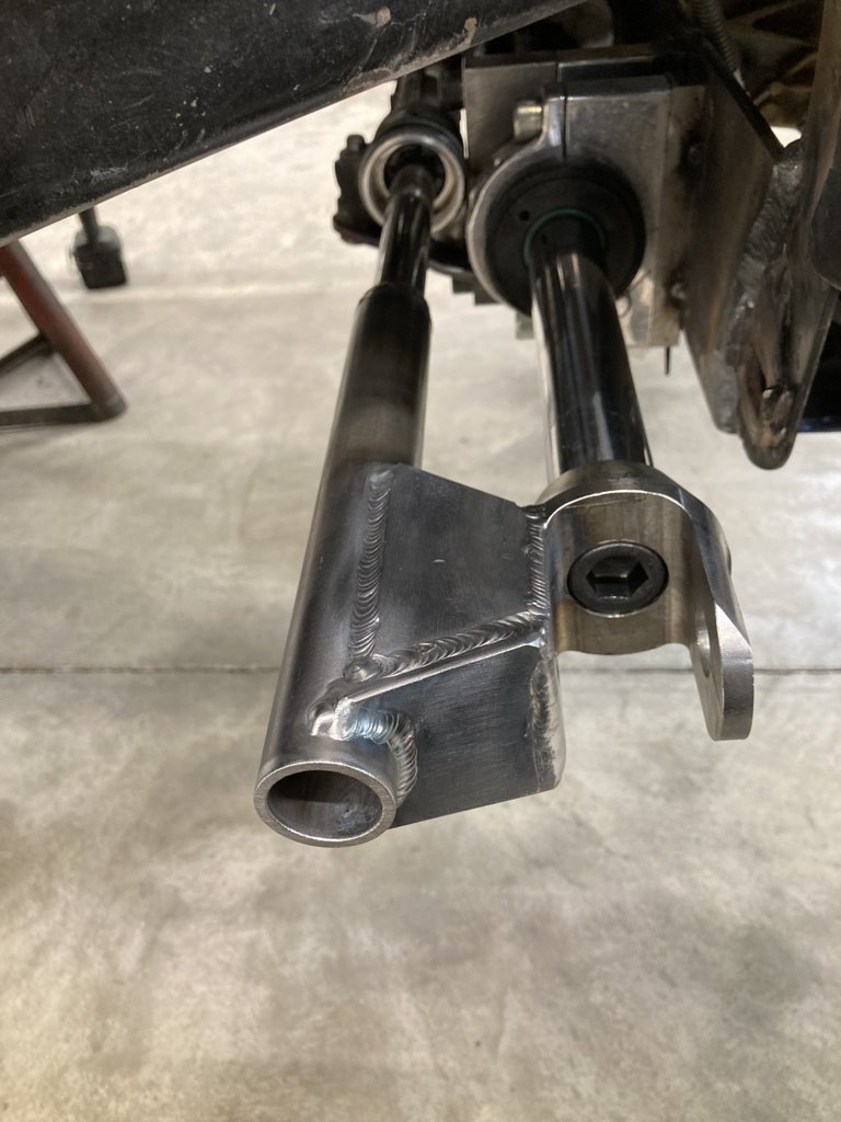

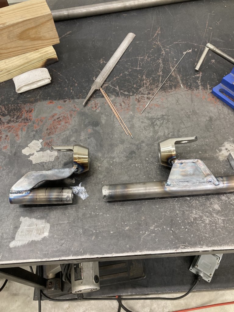

    missouri
    Tacoma based buggy

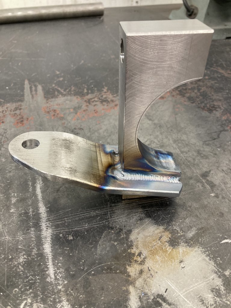

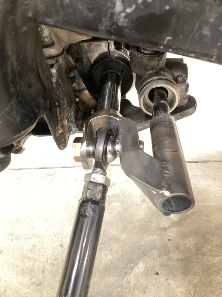

    Got the steering shaft put together, still need to make a bracket for the servo.

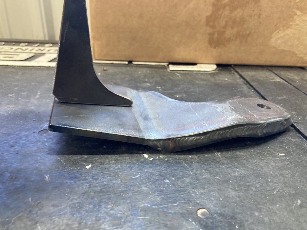

    missouri
    Tacoma based buggy

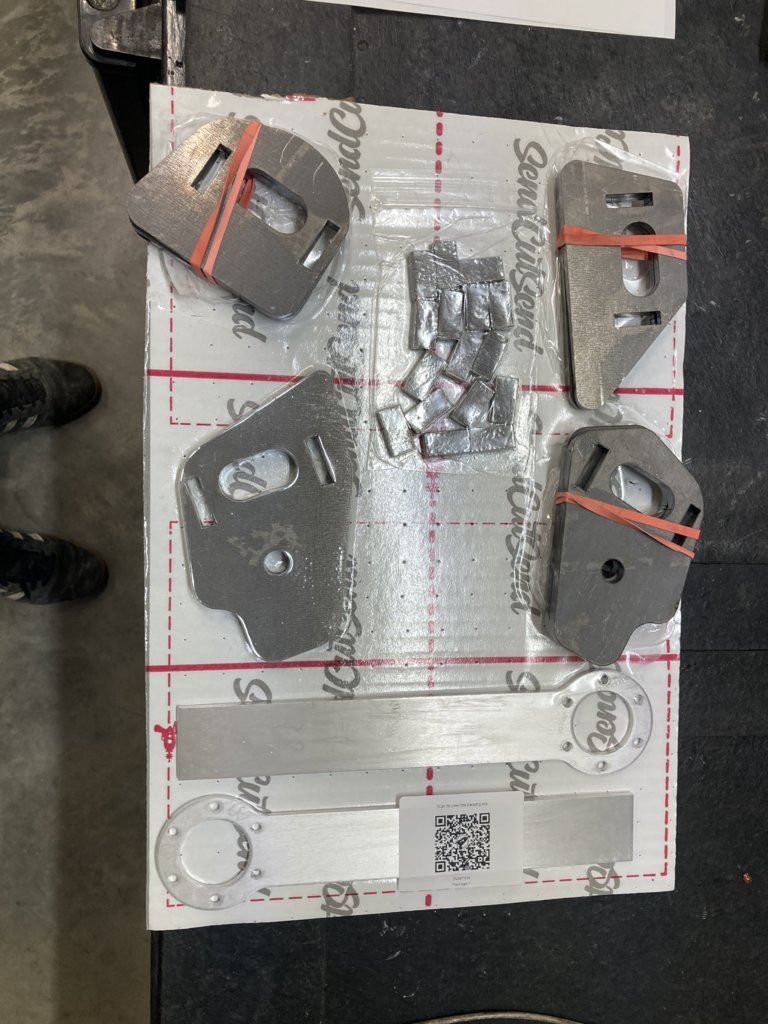

    Side quest while I have the lower control arms off. I didn’t care for any of the cam gussets on the market so I drew my own up and had them laser cut out.
    The AL bits will be the mounting bracket for the servo.

    2015 Tacoma TRD-Sport DC LB
    Coastal HC Front, 6112s+650lb King Coils, JD 62 Swap + 14" Fox 2.0s

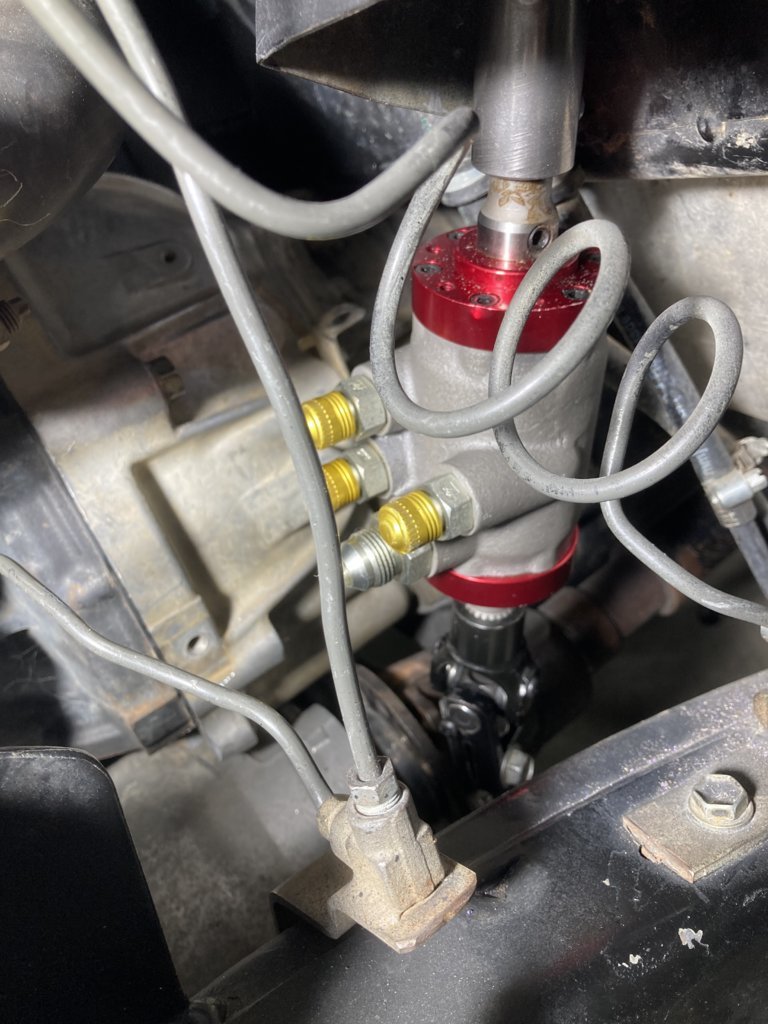

    What am I looking at here? Turn the wheel and fluid is forced through those fittings to drive the hydro assist? Don't think I've ever seen something that's along the steering shaft like this.
  20. Nov 21, 2024 at 5:06 PM
    #220
    tacoman2001$
    tacoman2001$ Well-Known Member
    Sep 23, 2022
    #406478
    767
    This is the most nutty steering setup I've ever seen I love it. So as I understand your using the fiat rack to essentially keep the hydro steering from drifting. You also have your orbital valve in line with your steering shaft. Do you plan on using the electric assist?
