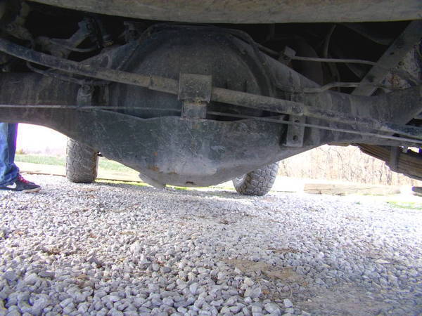

    did the diff breather mod today.
  16. Dec 29, 2011 at 6:02 PM
    #36
    livel0veryde
    livel0veryde [OP] Well-Known Member
    Jun 17, 2011
    #58450
    962
    josh
    missouri
    Tacoma based buggy
    diff armor i built i made it out of 3/16 flat bar. it turned out pretty good i think, should get the job done.

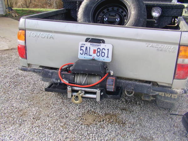

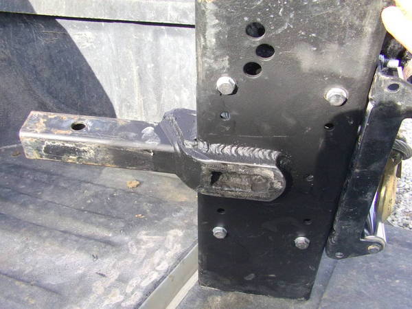

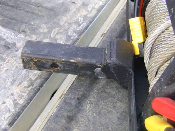

    built a mount for my new winch a few days ago. i used some 1/4 plate, the mounting plate it came with, and a 2in drop hitch. when i build a bumper for the front it will have a 2" receiver on it so i can put the winch on front or back depending on how im stuck.
    i cut out a section of the hitch so the would be more weld holding the two pieces together
    i also box in this back section

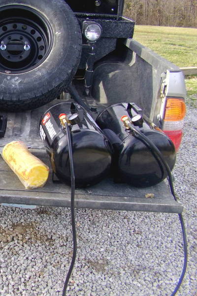

    started collecting parts for the onboard air system. two 5gal tanks and an air hose. the two tanks fit perfectly behind/under my spare tire in the bed so theres no wasted space. ill probably use an mv50 compressor and mount it in the tool box.

    Nice have you ever thought about using your AC compressor. I know you have to give up ac. My buddies 4runner is setup that way with 1 tank similar to yours and it works great.

    i read something about that a while ago sounds like it works really good, but i thought against it cause its nice having ac in the summers.
