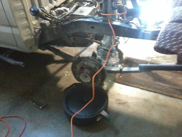

    discovered oil all over the my left rear tire, looks like a busted axle seal. called up O'reillys and ordered 2 inner and 2 outer oil seals for $35ish. thought it wouldn't hurt to have a spare set.

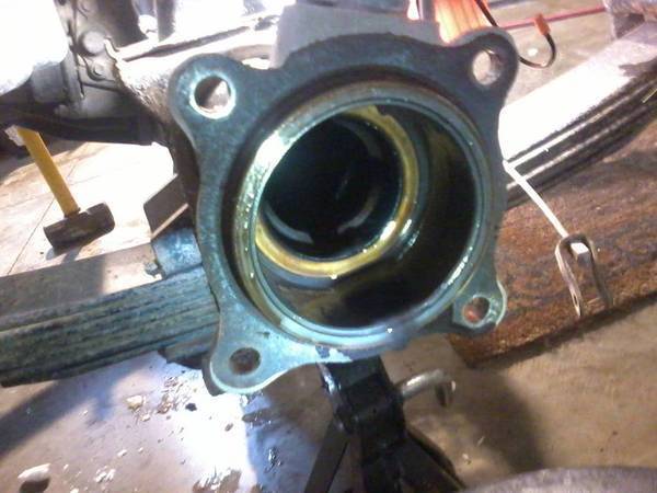

    some pix of replacing a blown oil seal in the axle tube
    about to remove the axle
    i found this loose in the axle tube
    pressed in the new oil seal with a mallet

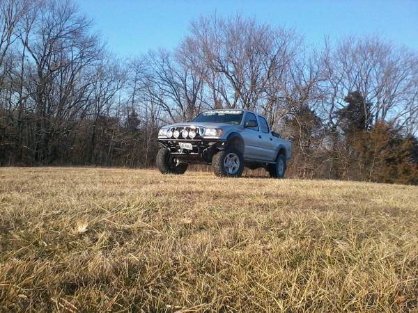

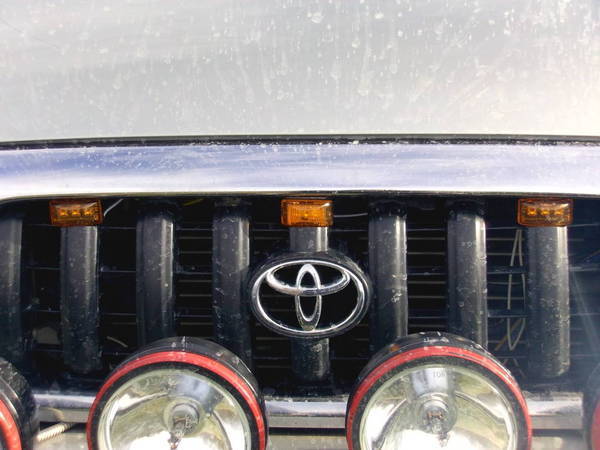

    i put these on a week or two ago, raptor style grill lights.

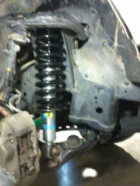

    new front set up.
    tundra 5100s (chose the tundra 5100s because they have more travel stiffer valving) and some old man emu 882s

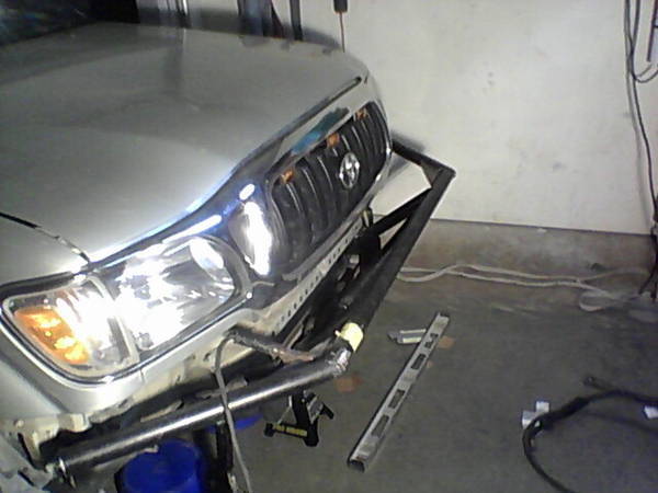

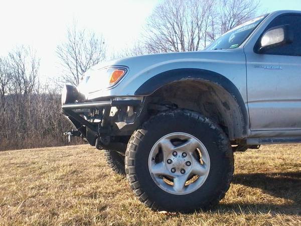

    some craptastic cell phone pics to show progress.

    looking good. Are you planing on making the whole thing into a plate bumper or just make a skid in the middle?
  14. Feb 12, 2012 at 7:41 PM
    #54
    livel0veryde
    livel0veryde [OP] Well-Known Member
    Jun 17, 2011
    #58450
    962
    josh
    missouri
    Tacoma based buggy
    no idea.

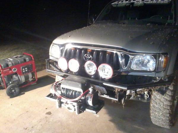

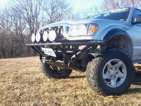

    the finished product im pretty happy with how it turned out
    the bumper has a 2in receiver built in where i can attach a d-ring or my winch

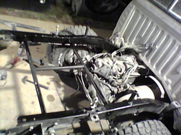

    also boxed the frame a month or so back

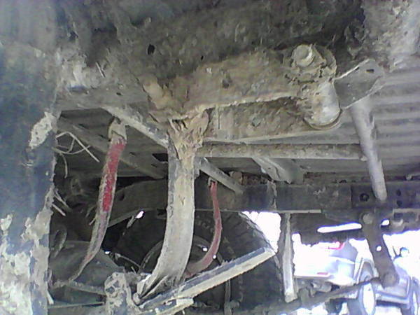

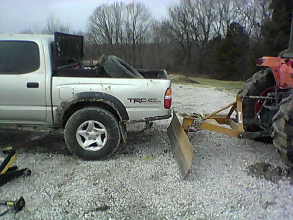

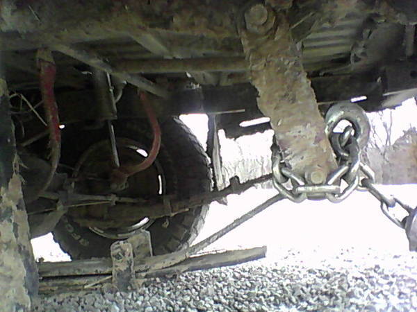

    had an awesome time wheeling last weekend, but it turned in to an expensive trip fast.
    had to put a new starter in last night, then my alternator died on the way home today so i replaced that a few hrs ago
    and discovered this monday morning while cleaning up the truck.
    so i took the tractor and a chain and pulled it back in to place
    but the leaf is trashed

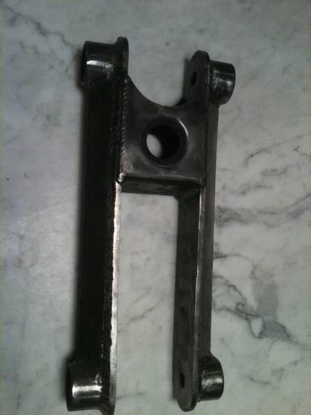

    i bought some giant motorsports shackles from a member on here then saw this picture and thought i should beef mine up a bit.
    i only have on side done so far but this is what i came up with.

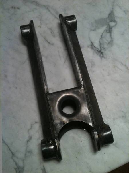

    josh
    missouri
    Tacoma based buggy
    one down. one to go.
