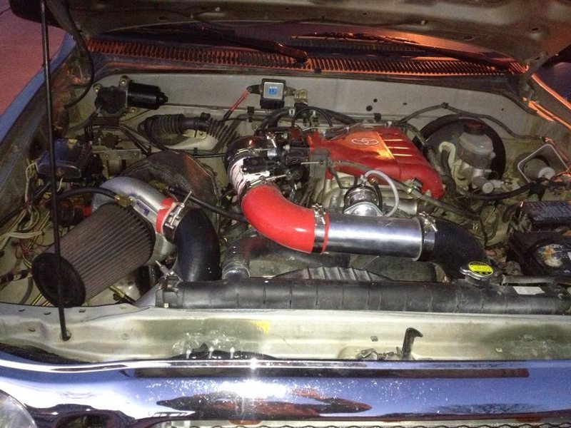

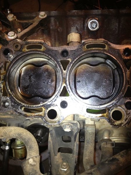

    I reach about 85% duty cycle on 550cc injectors, so ya I'd say it's necessary.im using an aem fic6 to tune. I should say was using, i blew a hole through a piston last week.

    How'd you manage that? How much boost?

    Lol 20lbs. I'm using the cx racing header, Iv never seen any of the urd stuff in person so I can't really say anything about it, but I highly recommend the aem fic,lets you do lots of stuff and is supper easy to figure out.

    Blew a hole through the piston!?:eek: Wow, I haven't seen that before. I guess our connecting rods are pretty strong then.:p

    Something like that, I haven't torn the motor down yet. But it's ether cracked or I broke some rings or something.

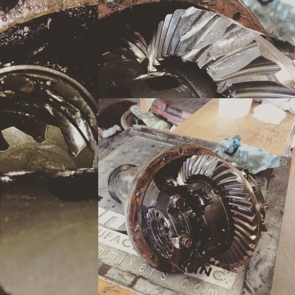

    About a month ago I was pulling up on the trailer getting ready to go to flatnasty and the rear diff grenaded.

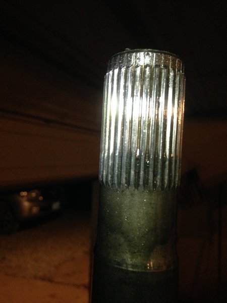

    So I got a set of 4.30 diffs from a 4Runner and started wheeling again. Then today while going out to get the mail this happened.
    Broke the ps side gear in my new diff... good stuff ::)

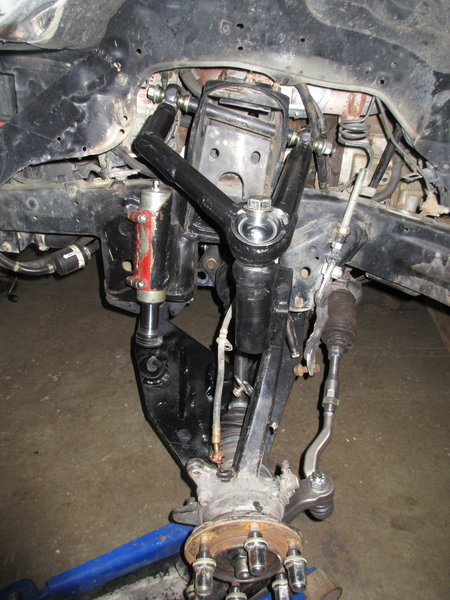

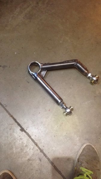

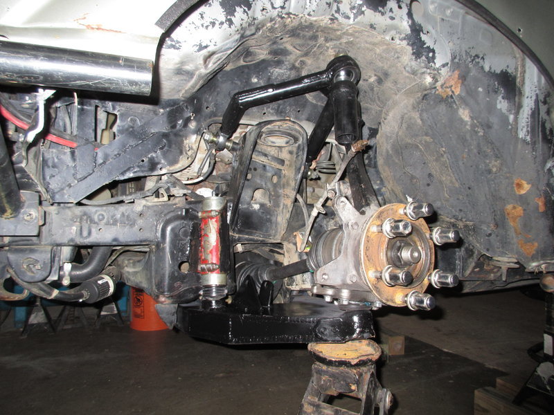

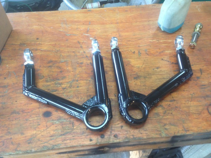

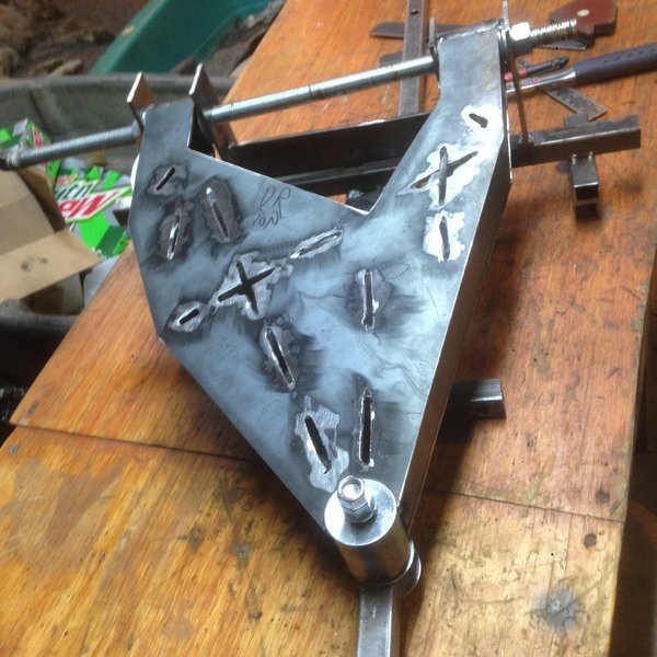

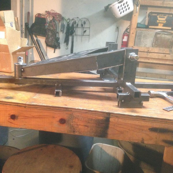

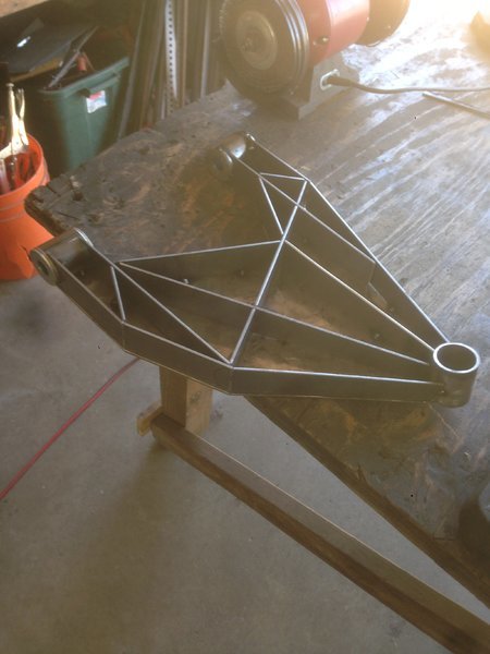

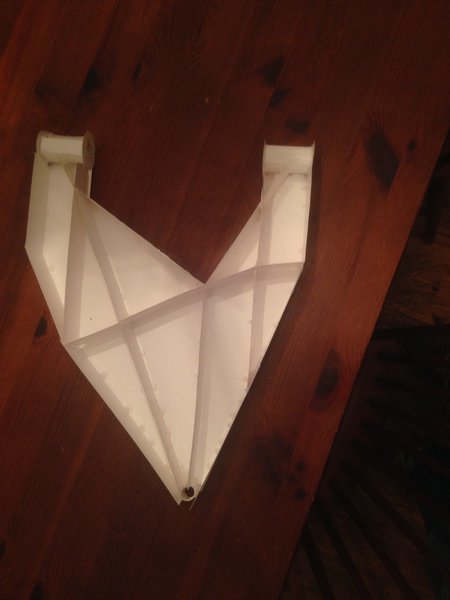

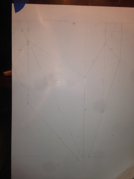

    So I started building long travel front suspension a few weeks ago. Nothing too fancy, just 3.5" over.

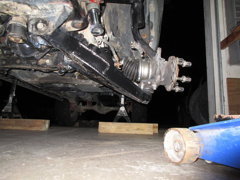

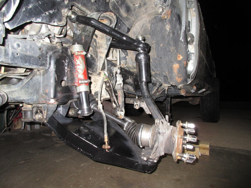

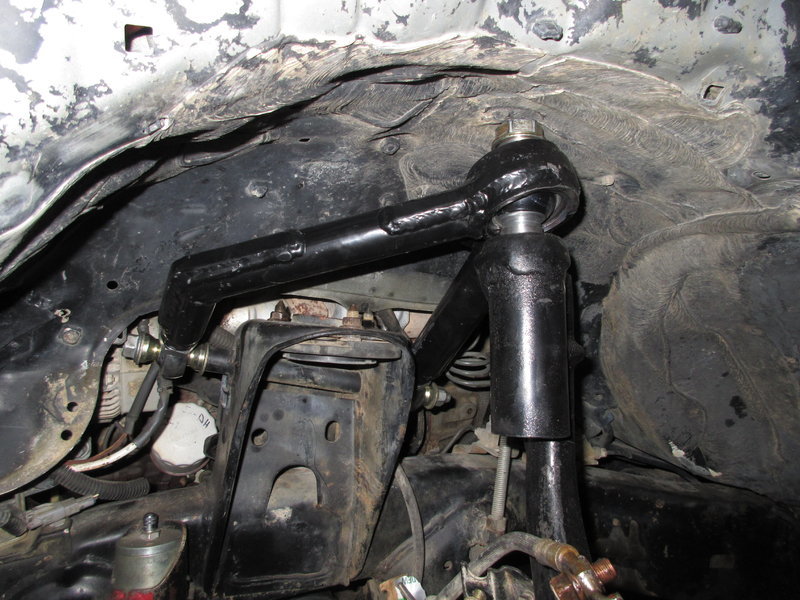

    pics of progress on the long travel build.
    pulls 12 in using tundra shocks and old man emu 885s.
    no idea where ride height will end up, theirs some adjust-ability in the eibach shocks so i should be able to get it dialed in .
