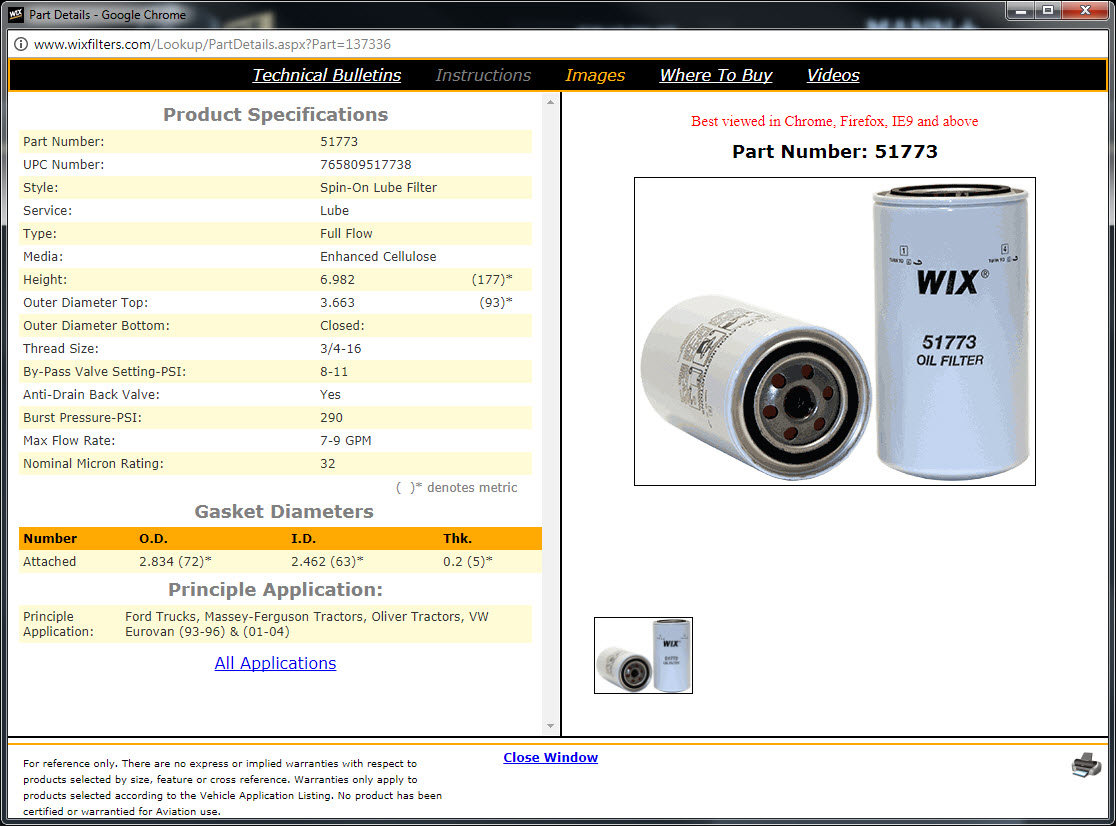

    Anyone try this monster?

    ...and a 1/3 of a qt does what exactly?

    Why??!?!
