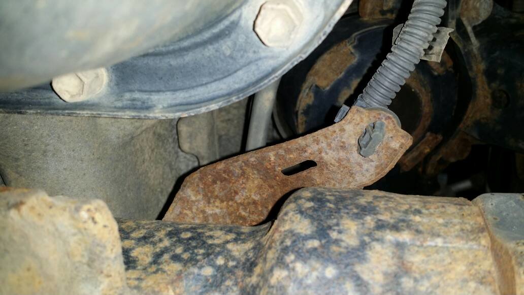

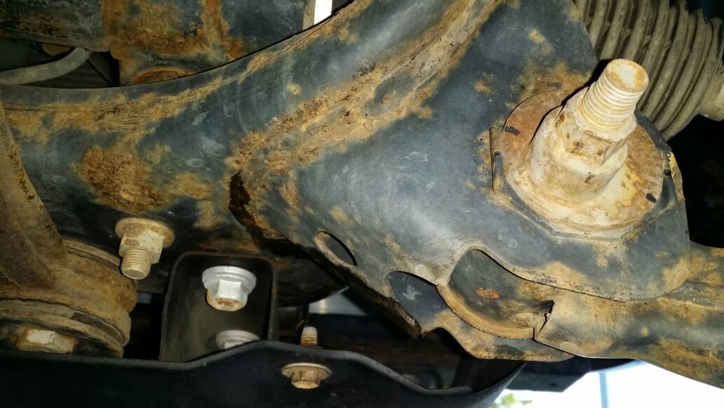

    How bad is this rusting? I sanded, rust reformed, and painted my frame from front tires back, but not to in the front where this is and wanted to know how bad this is. Thanks for your help guyssy6a3a5e_0f6e316394d08b375d9d3d6b50efc2ba5d63ace8.jpgemy7azy7_14fea6f601afe70384b95d4ecbc36ce16b4c0fd8.jpg2abevegu_0e6454c32a5a438238469b50e431f314641a00a6.jpg7edy7u6u_1866b3e4b6d399573c3f3bc769eef1d48b259860.jpg

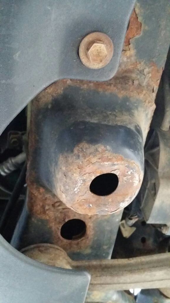

    ^^^^How does your frame look by the catalytic converters? That's where mine has a hole big enough to to put a beer can in.

    Would you say mine is just surface rust then? Most of it seems to me like it is, but I wasn't sure about all of it

    IMHO what you posted is just surface rust. Would not be a problem if you attacked it with a wire wheel/brush or grinder and repainted.
    The surface rust you can't see in between the sandwiched part of the frames is what will get your tuck though. If there is rust like that in the sandwiched parts nothing will save it now. This is the rust most people are falling victim to.

    Some of those areas will be really rough to brush and paint... There were just a few parts that the welds seemed like they were flaking off.
    Appreciate your help
