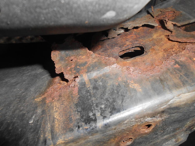

    And thats it? That easy? Pics of bad frame please.

    05 PreRunner TRD Sport

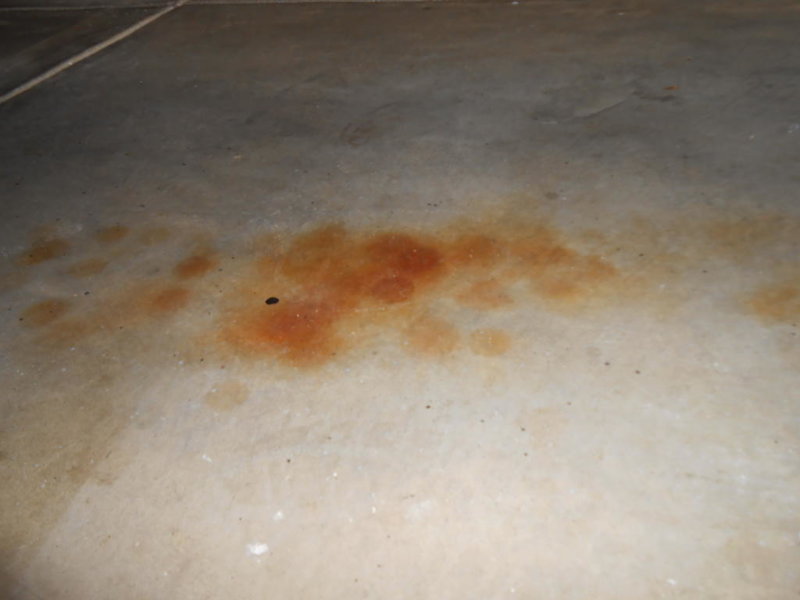

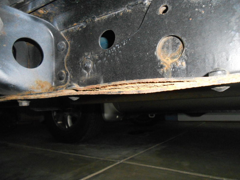

    Live in Louisville,KY. They use salt in the winter. I've sanded, wire brushed and spray painted frame over the years. First pic is the money shot that got my new frame, next to drivers side catalytic converter, second is from muffler area, third is of one of the two lines of rust spots on garage floor

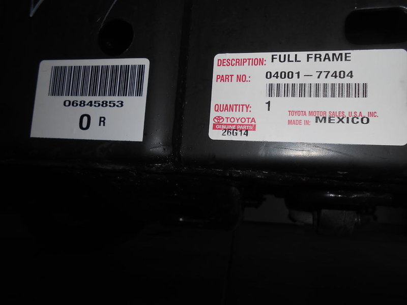

    Took a week to replace my frame. Night and day difference in how it rides now. I still had the old 3 leaf rear spring before, now have a 4 leaf. Steering is tighter, ride is much smoother. No sqeak when I get out of it anymore.
    Tried to read the cashier's invoice (upside down to me), looked like they charged $12,317, plus $210 for rental. If you get the chance, do it

    Are the replacement frames identical to the original? And is Toyota applying any coating on these new frames?
