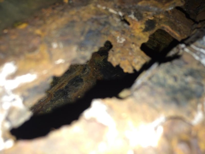

    Here is how big the hole got after their inspection today....look at my old posts for comparison

    Here's another pic
