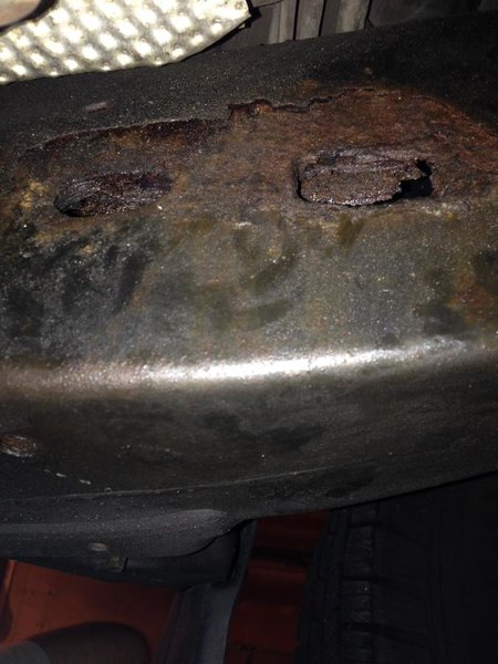

    State: CT
    Year of production: 2004 (10/04)
    Exact model of truck: 2005 Tacoma Access Cab 4x4 V6 TRD Off-Road
    Status of Toyota inspection: Inspected 10/02/2014 - failed; new frame ordered (4-5 weeks wait time)

    Troy, MI
    06 Tacoma TRD Off-road
    5100s with OME 885 coils. OME Dakar leaf and OME nitrocharger sport shocks., 265/75/R16 Duratracs
    So they ordered your frame the and day as inspection? My dealer sent pictures in to corporate. My frame failed as well. Still waiting to hear back

    I spoke to my dealer at the beginning of the week- go in today for the inspection- and was told that anything over 10mm in size gets a new frame and anything under that gets the CRC

    They did indeed. They informed me of the inspection result, filled out a bunch of paperwork, explained what the next steps were, and told me they would call me when the parts arrived.
    They also told me they would install new shocks and front axles for the price of parts - no labor - and they would do the clutch for parts and 2 hours labor. They also said they would give me a list of any potential problems and ask what I want to do before the truck goes back together. So far, everything has gone smooth. I've used this dealership for maintenance for the past 7 years and they have never let me down. So far, so good.

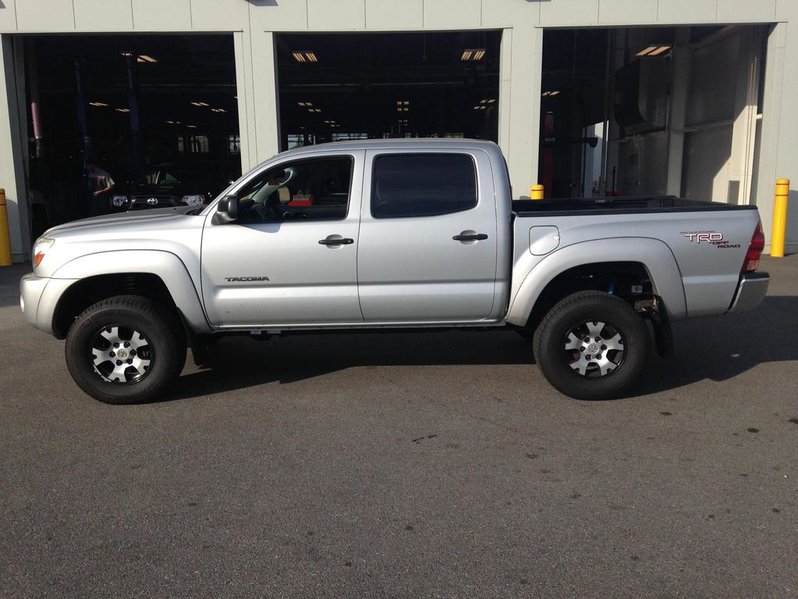

    Picked up my truck today. The truck drives way nicer than before :) I added a small lift (struts & springs, rear blocks), a new hitch assy, a couple of d-rings to the bed.
    The only costs I incurred were for maintenance unrelated to the frame ($2100 ugh).
    Here are the parts for the frame replacement listed on my service sheet:
    Frame Sub-assy
    jpn source parts kits, usa source parts kits
    brake tube kits 1& 4
    rings, drive shaft
    tube, rr brake 3-6
    arm sub-assy
    spring assy
    bumper rr spring
    carrier assy, spare
    wire, frame & skid control
    bolts & washers, nuts & clamps, brake fluid
    The sheet also included a write up of the actual work done in replacing the frame.
