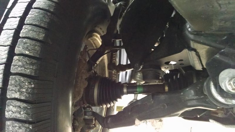

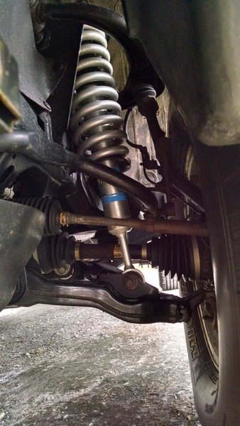

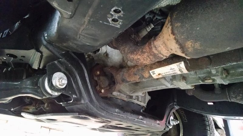

    I posted #544 when mine got done--my repair sheet only listed "arm sub-assy" - I'll try to post a close up of what the front end looks like.

    Front end close up, after new frame install

    Can you confirm that the lower control arm bushings and lower ball joint were installed with the lower control arm? I am awaiting delivery of my frame and I'm intending to have quite a few components replaced including control arm bushings and ball joints, but don't want to purchase the lowers if they're included with the frame swap. Thanks.

    From the way the rest of that truck looks, id say those are brand new lca's. They're not going to waste time, or even try to use the old bushings/bj. Its impossible to get the bushings out anyways without destroying them

    Probably by vin... I thought the 2wd trucks had the diff mounts on the cross members already?
