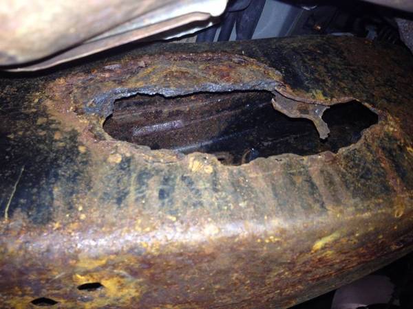

    Pick of mine, driver side with 95k miles. It is at the dealer waiting on my new frame and pieces parts. I am driving the dealer loaner until mine is fixed.

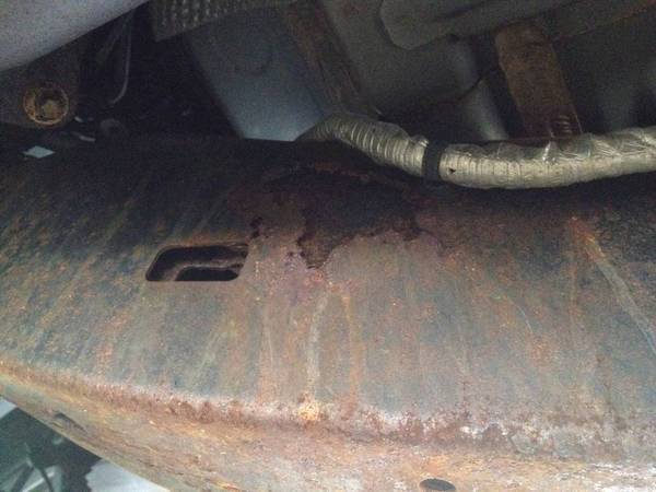

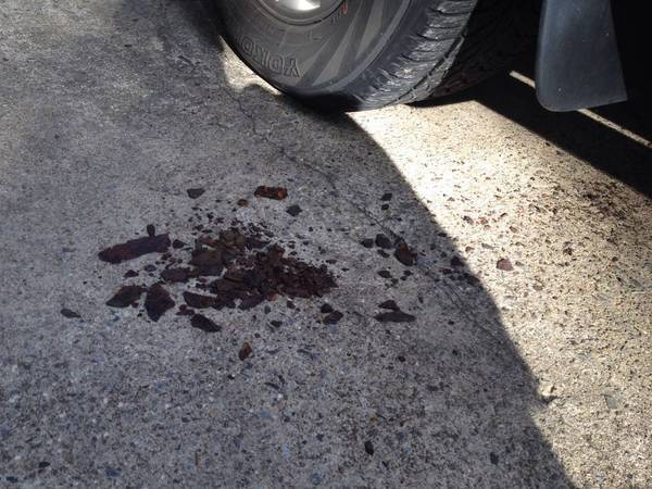

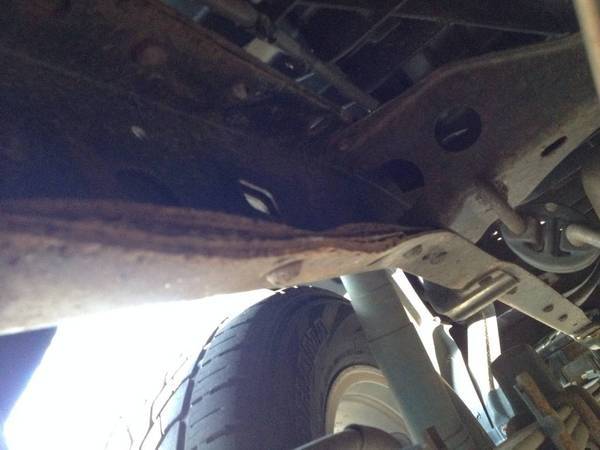

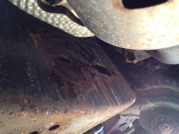

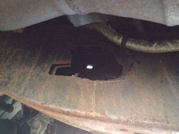

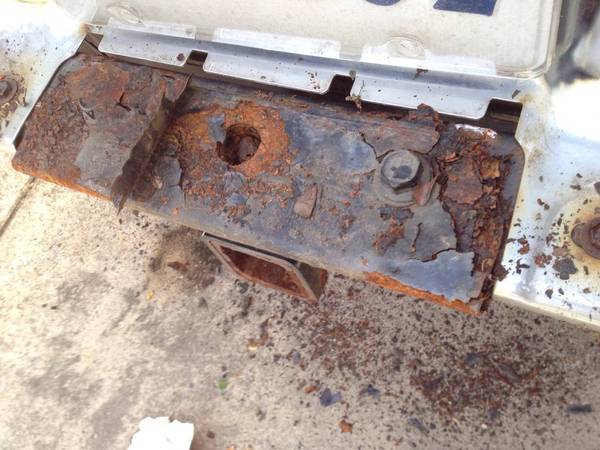

    I had posted them earlier in this thread, but for your viewing enjoyment--
    Drivers side (before):
    Drivers side(after):
    Passenger side(before):
    Passenger side(after):
    Pieces:
    Passenger side bed:
    Rear bumper:
