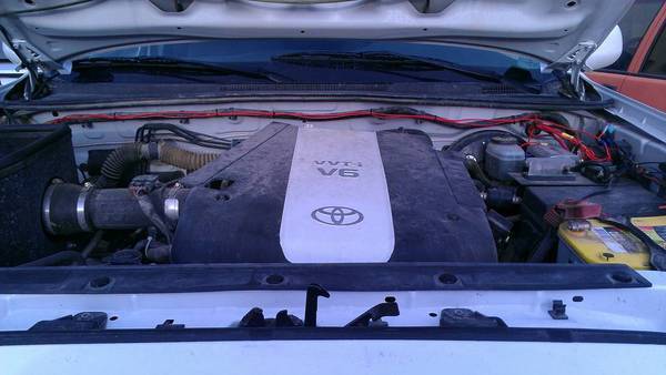

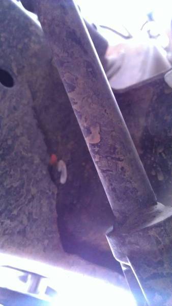

    This is my problem.........And no fix from Toyota...........
    Little bit of taco lean........only from the engine.......
    Well Fack.............Drivers side motor mount collapsed into the frame.
