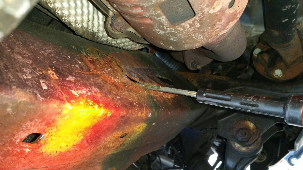

    So, does this look like I qualify?

    That's just minor surface rust , should just polish right out ...

    So I should widen her a bit?

    Has to be a clear hole. They are supposed to punch it but I had to do it myself and take it back before they would approve a replacement.

    I'd pull that entire lifted piece of metal off to fully expose the hole underneath. It probably won't take much effort.

    I tried before. Its held fast. but I'll give her a go again.

    Don't make it too big or they may not give you your truck back.

    That flake isn't load bearing an the hole underneath is about the size of a quarter to a fifty cent piece

    looks like a nice chunk.. rip it off and go drive the beach everyday
