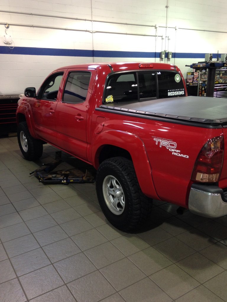

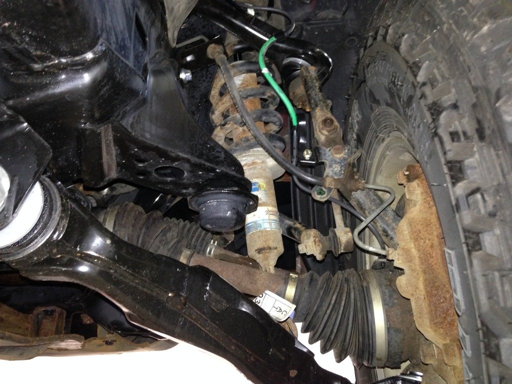

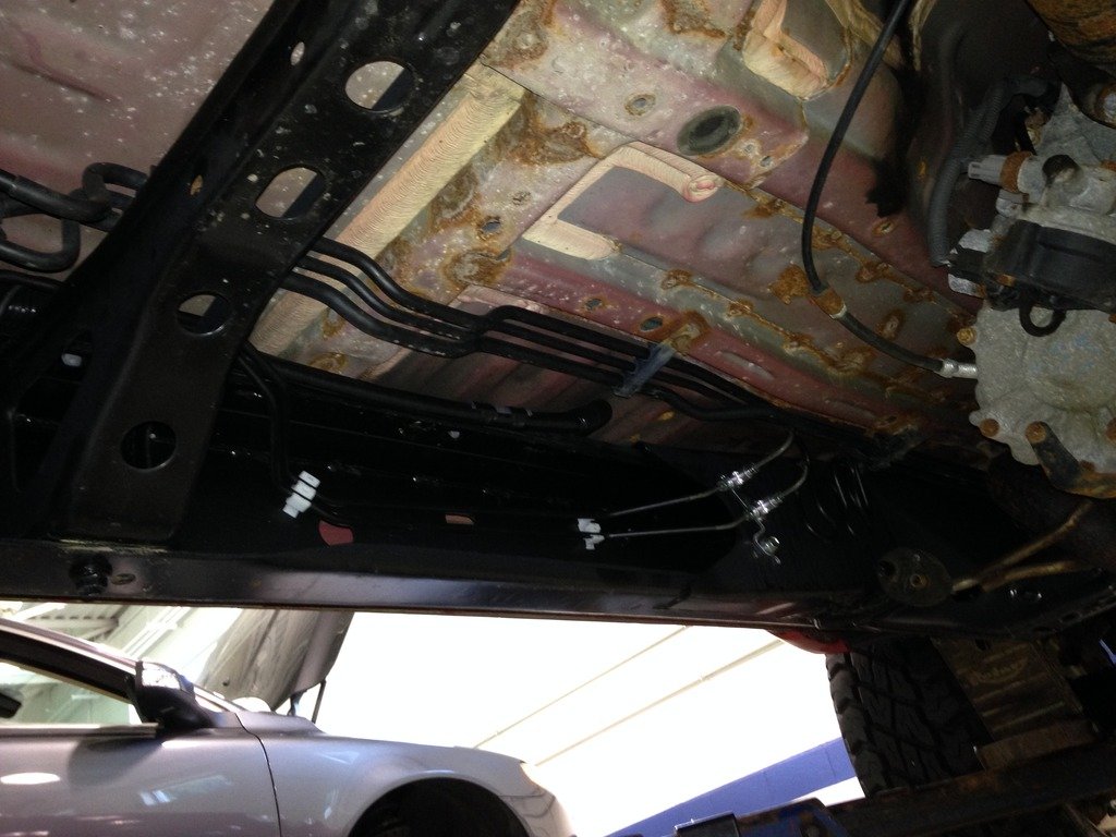

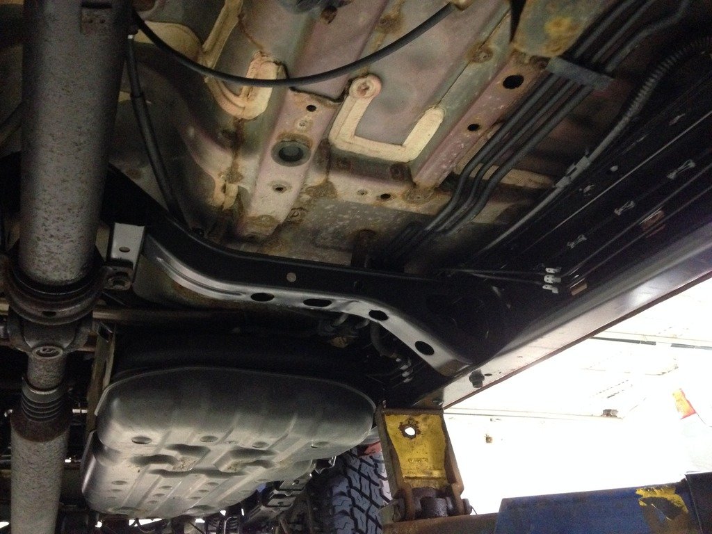

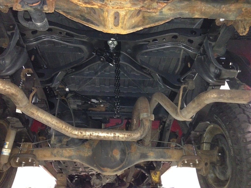

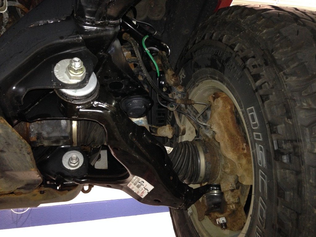

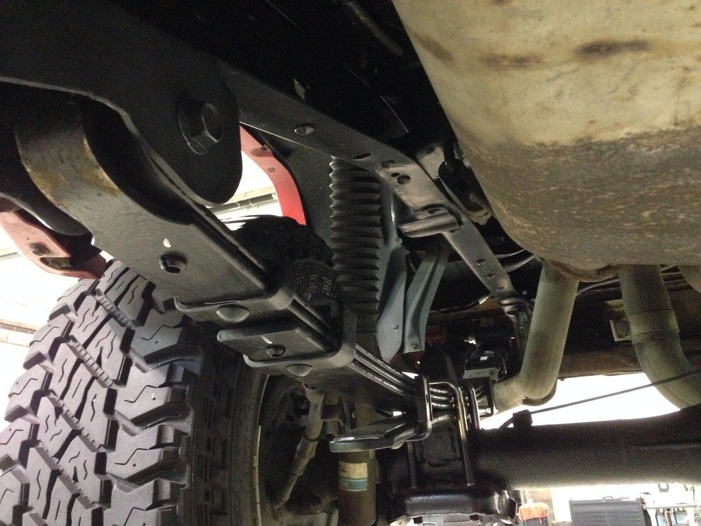

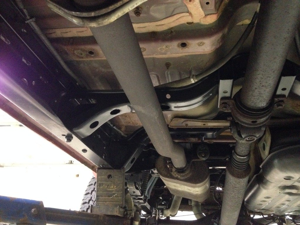

    Got it back from Toyota about 48 hours after I dropped it off. They did a really great job as well as replacing the UCAs for me, as I had them in the backseat. I can feel a lot more since it is so much tighter, but it is a great feeling driving it and not worrying. I will drive it for a few days and put it back on the lift to make sure everything is A ok.
    BF225A6C-B889-44EC-8D45-170EE3539474_zps_193274e238b024b78d5b8033a5ef2014782824cd.jpg
    E518A261-7BDD-4D2E-9EAB-299D16DC4233_zps_bb7a1647e18f69fc5b5fd138d618b228e8a572eb.jpg
    EF1009E6-337C-4217-8CCF-C09429A8D88C_zps_49261c9093d94d307e90cebe4b02f8c40e5f19f3.jpg
    1DCAAB75-F3C7-411A-A70E-4D74012B7819_zps_462b5746bb2ac9286f6bcd6dc82c4091cbe114f0.jpg
    DEF4DC50-93B9-4BFE-B240-21CDBFA34041_zps_e324c37778f61793ce9ca71fa8f8675d3124de99.jpg
    5423B555-E62E-4962-9B76-8205EA85B93F_zps_08c406a8bc809e68ab0940c84f744f5c394cded2.jpg
    D0729473-E5FD-4795-99A1-95DBB67A1B35_zps_56e131d5444e8f57f298384860c40356061bc6a4.jpg
    C77663D9-6833-4E01-AFA6-3C304D1F5087_zps_b67d8ef7cdca572ea646b5a3e17e135fad9ea1d2.jpg

    Wow man, looks great! Body looks clean too. Now take the opportunity and treat the rest of the rust and you'll get another twenty years of life from it.:thumbsup:

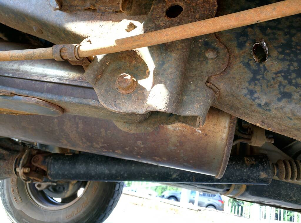

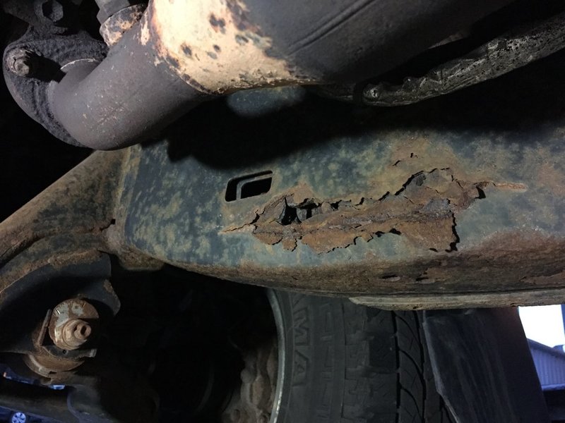

    Here's mine. Passenger side. Had it in to the local small shop, they called and told me about the 'crack' that's turned into this hole with a little poking. Took it in to the dealer this morning and asked what the process was when it failed (pretty sure it will). The adviser said $16k worth of work and a new frame, but I'd be on the hook for "$1,500-2,000 for stuff that breaks during like brake lines, control arms, etc." He also said they've only done 2 out of 30 inspected. Should I be worried that he doesn't know what he's talking about and they haven't done very many?

    If you Search these threads you will find that MANY pay $0 for the frame replacement. I suggest you get this re quoted at another dealer ....

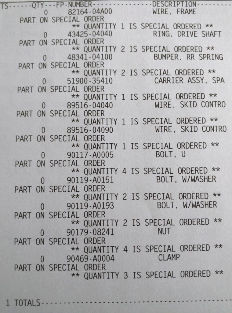

    That's BS about being on the hook for brake lines. Here are all the parts that my dealership ordered, all of which said Warranty on the Toyota paperwork.

    Your bill should be $0 after this if you choose. I had a ton of stuff replaced for free labor (shocks, struts, brakes etc) only paying for parts. If it was taken off to swap out the frame, it can be replaced labor free.
