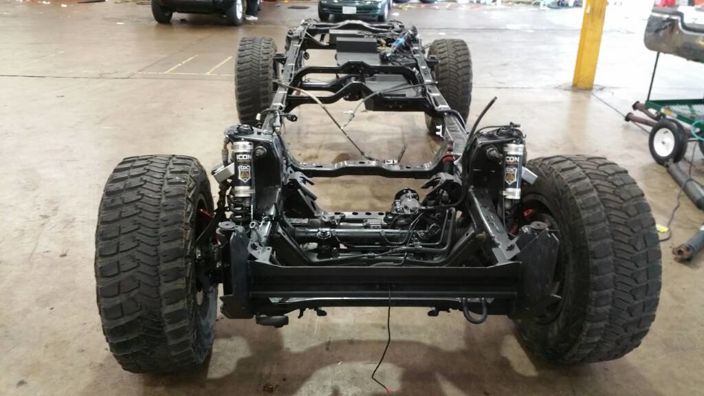

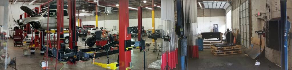

    My truck is in as we speak. Added new drive belt and center support bearing to the list of parts. Will post some pics later today.
