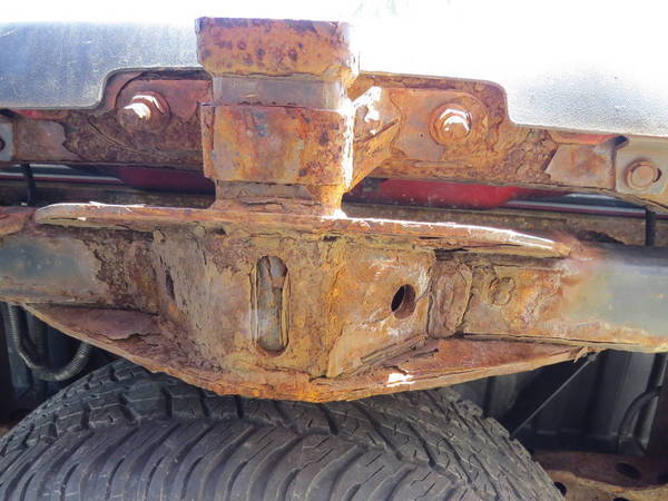

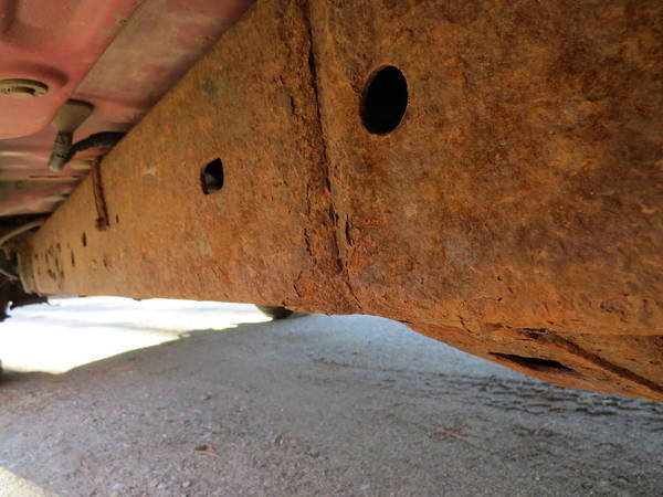

    See if you can post some pics up on here. Never looks good with this amount of rust pics on 30K+ trucks.

    I would take it in and have them document it...personally I think that Toyota will listen to them more with a witness report and photos versus just calling and telling them that you have holes.

    For your viewing pleasure
  8. Nov 22, 2013 at 9:39 AM
    #68
    justinfisch01
    justinfisch01 Well-Known Member
    Apr 17, 2012
    #77091
    52
    05 DC Tacoma
  9. Nov 22, 2013 at 10:49 AM
    #69
    justinfisch01
    Apr 17, 2012
    #77091
    52
    05 DC Tacoma

    The rust in that last pic is not perforating rust. Brush it and paint it. Should be a part of your maintenance program. Yearly.

    You are entiled to your opinion...plenty of other pics support my claim...I have holes in the frame if you bothered to read the thread. The rest are just supporting pics of how shifty the frame is....I never saw a scrape/wire brush/paint section in the manual....you have a page reference?

    Glad to see they took care of you. Looks like you drew the short straw for frames with that one.
