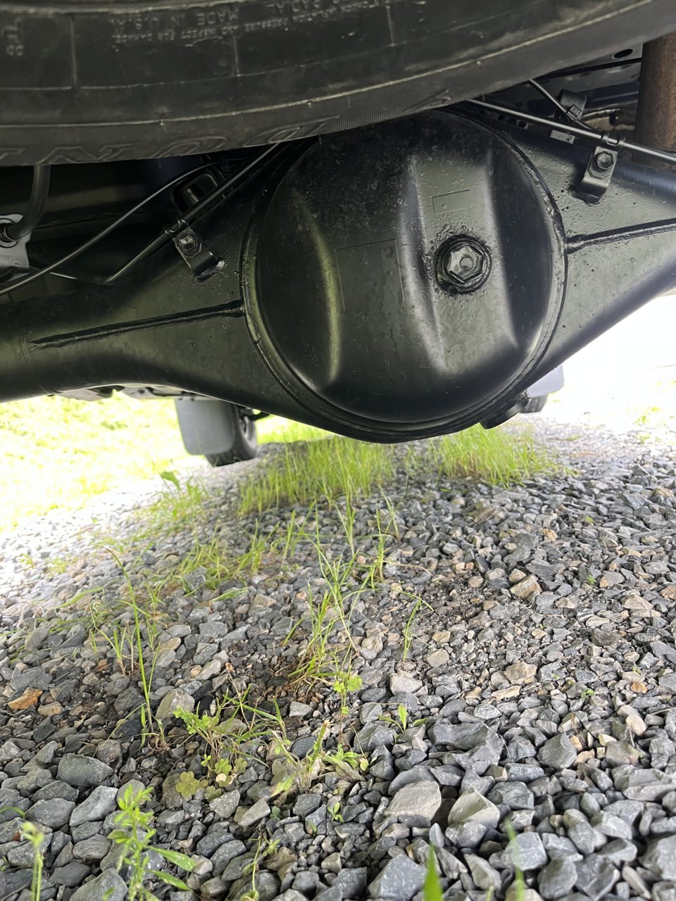

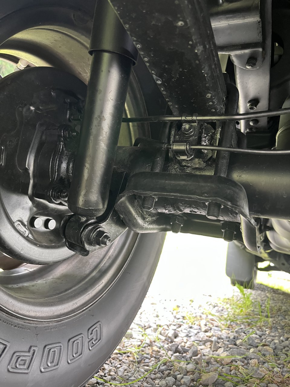

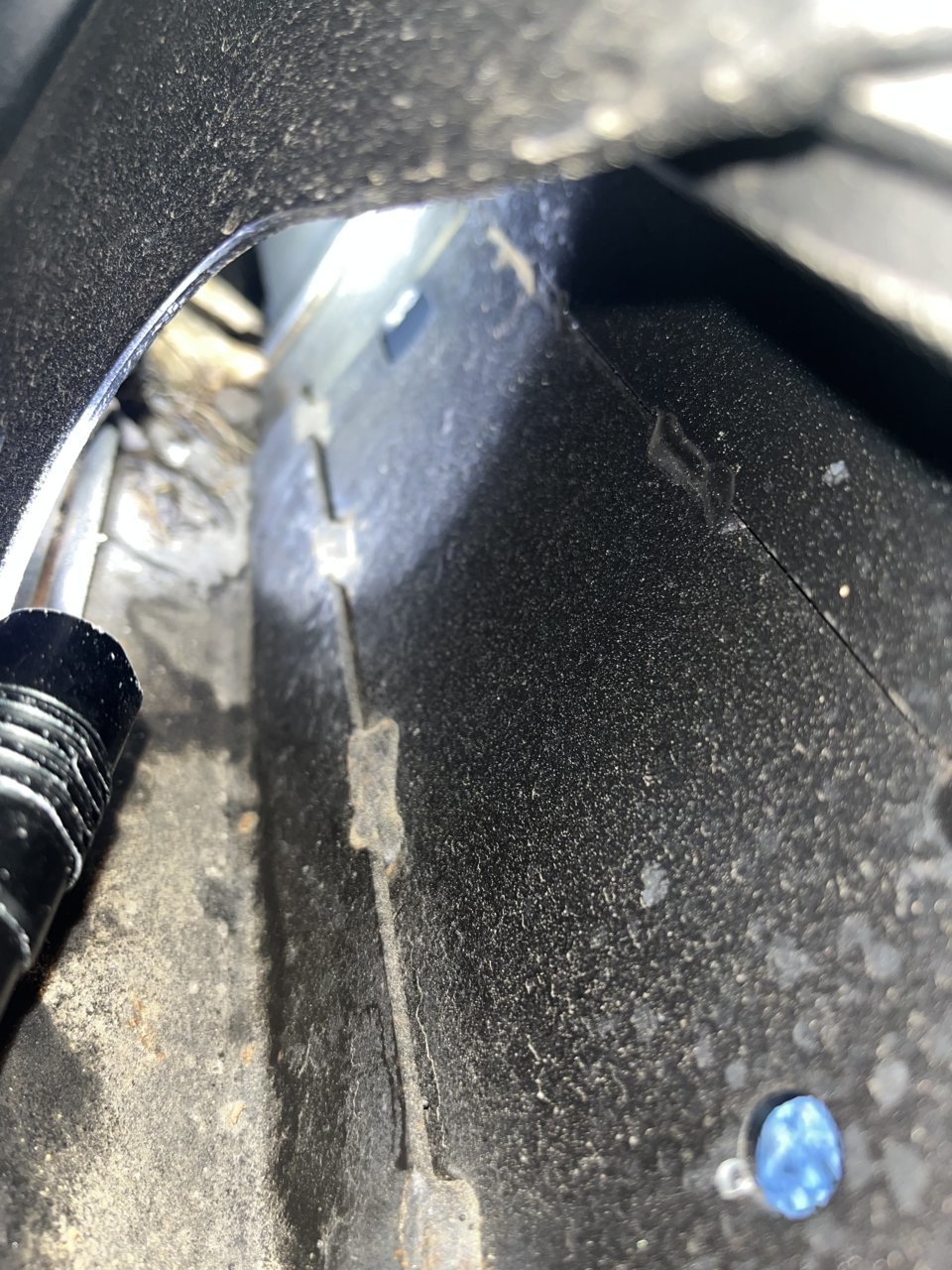

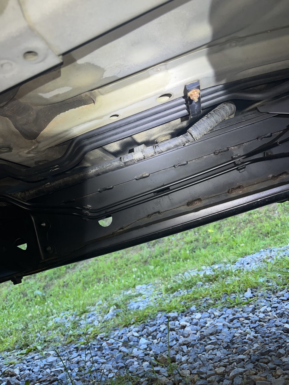

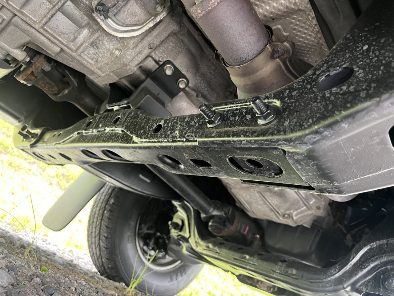

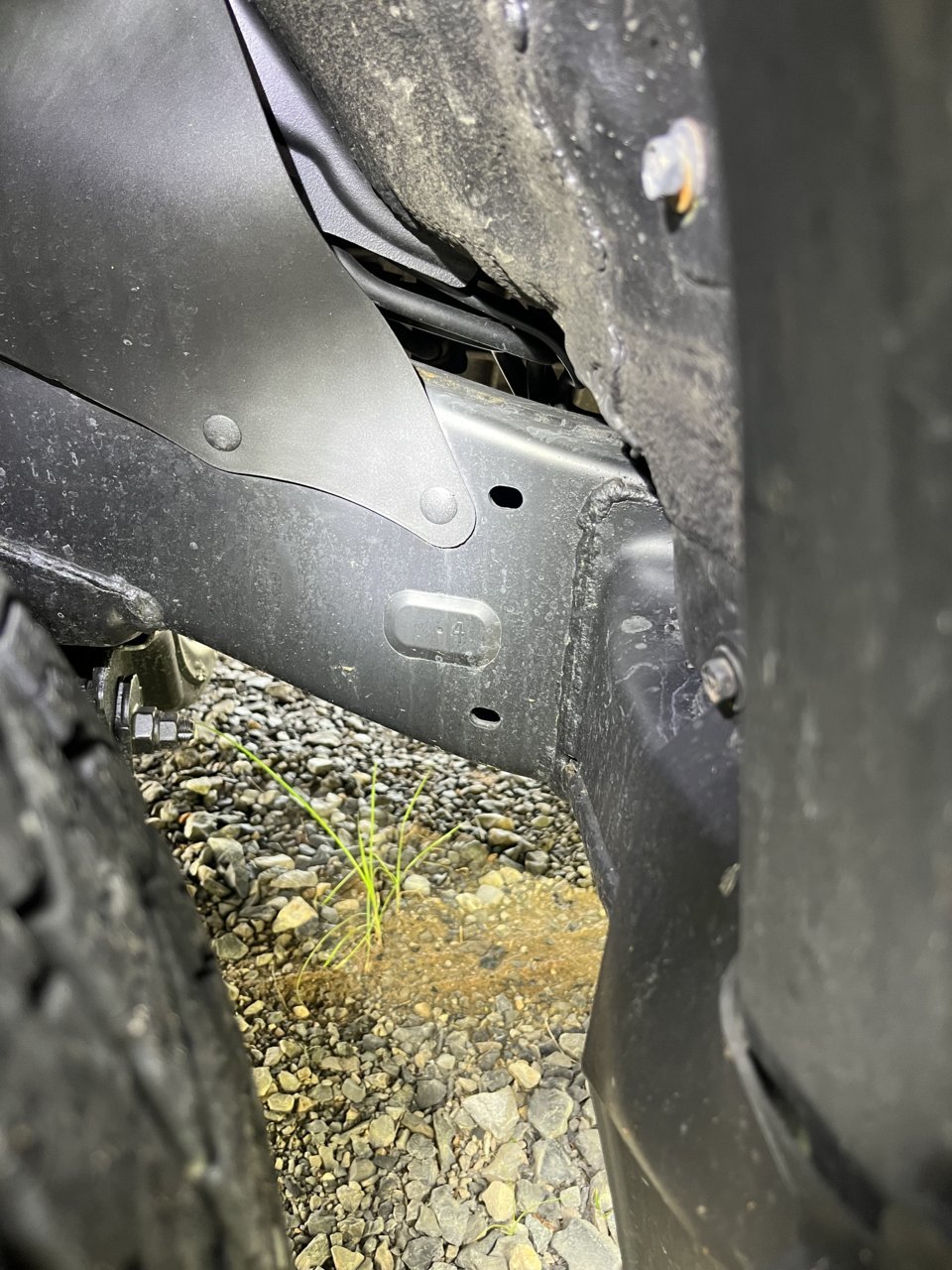

    Bought a 2012 2.7L 5 speed 4x4 about 4 weeks ago I inspected it very well I couldn’t tell if the frame had been painted or not because there is no overspray underneath the truck. If it is painted it was done with care should it worry me if it has been painted. I’ll upload some pics.

    It looks painted.

    @Fifthwind is that a bad thing if it is. To me it doesn’t look too bad.

    Looks pretty good, watch the welds, tough to get the oxidation out of the filler. Fluid film or similar would be good, make sure to use lots of dish soap and rinse before coating to get best effect.
