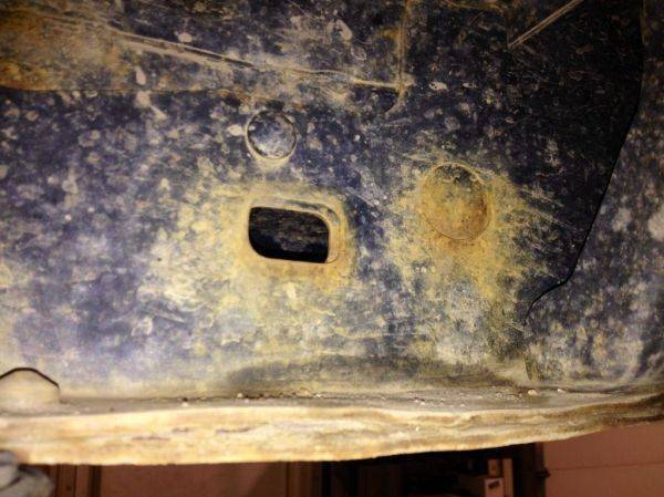

    05 DC Tacoma
    Frame beginning to warp/split

    My frame is doing that in some spots, although there isn't any rust in those spots either.

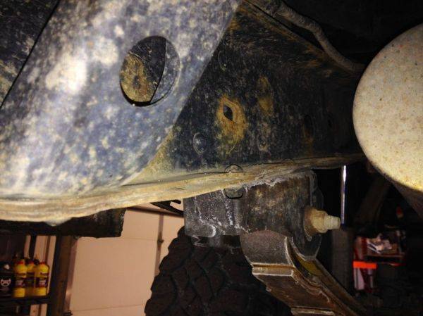

    52
    05 DC Tacoma
    Holes beginning to form on passenger side
