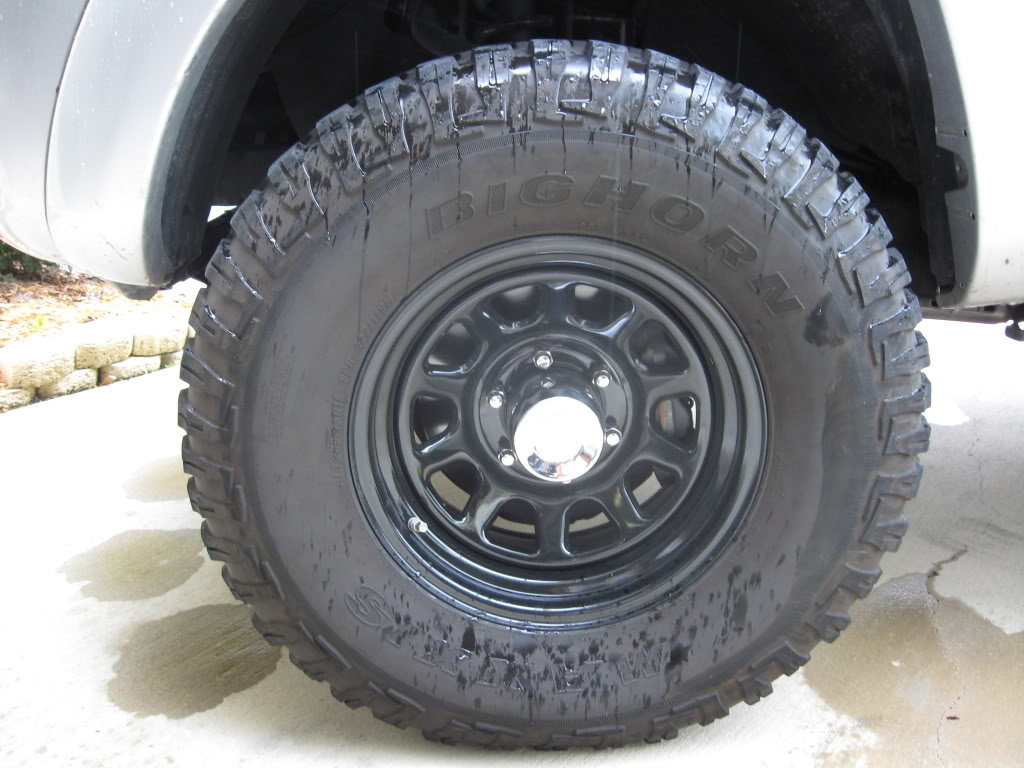

    -Nitto G2 265/70/17 -Level 8 MK6 Wheels -Katzkin Leather Black on Black -BHLM -Weathertech -Extang Solid Fold -Bedlight LEDs -TRD Skid
    Rockcrawler
    16x8
    4.5" BS
    Spacers
    285/75/16
    2.5" lift
    No aftermarket UCA
    Only slight grinding on the break caliper to resolve the rubbing issue with the new rims. I love em! Cheap and look great! :D

    Sweet ride you got there Rippin. Question, If you had gottin wheels with 4.0" back spacing would you have needed the spacers? Are your spacers 1/4"? Any alignment or balancing issues?
    Thanks for the reply.

    Thanks!! Might not have needed them if I went 4" BS but I remember it being hard to find the right rims that way. My spacers are 1/4". No issues. :cool:

    Thanks Rippin! I'm not against running spacers. I've read that some guys have troble with tire and wheel balancing with spacers. Did you experiance any problems with balancing. What brand of spacers are you running.

    NP! Didnt have any problems balancing and they are Spidertrax :cool:
