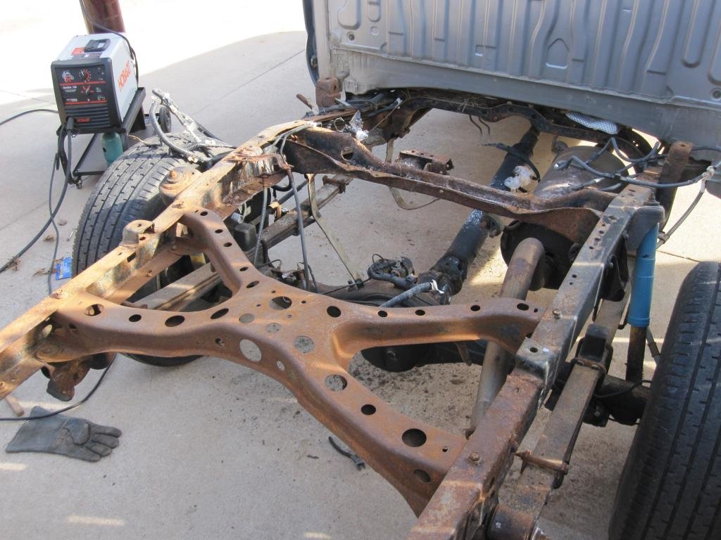

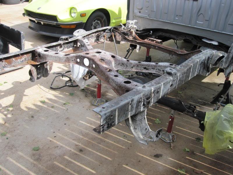

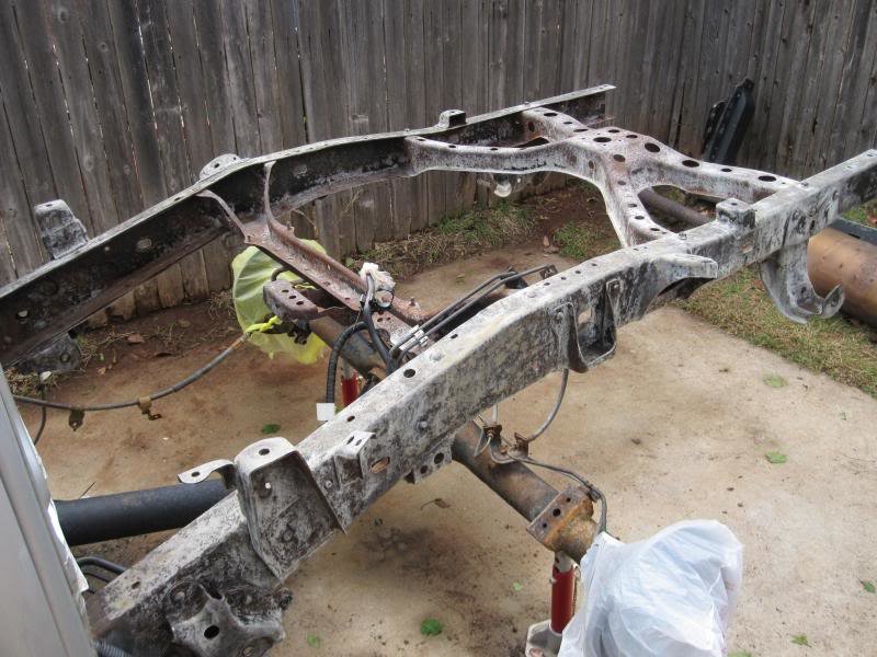

    Not much of an update but some progress of what ive been doing and where im at now.
    Sorry for my lack of detailed pics through out my project, i tend to forget when working on it.

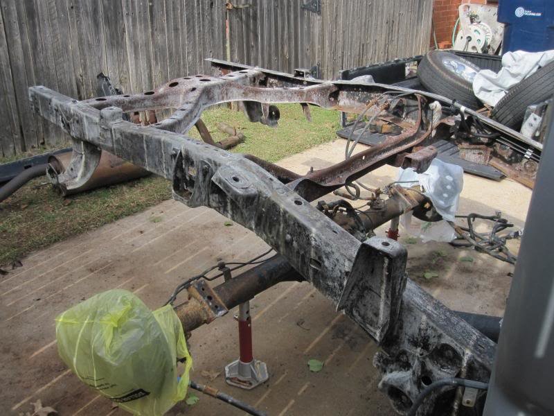

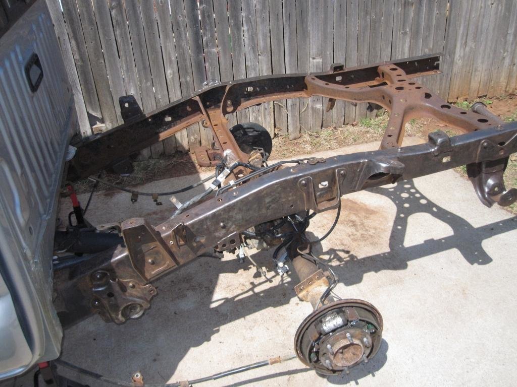

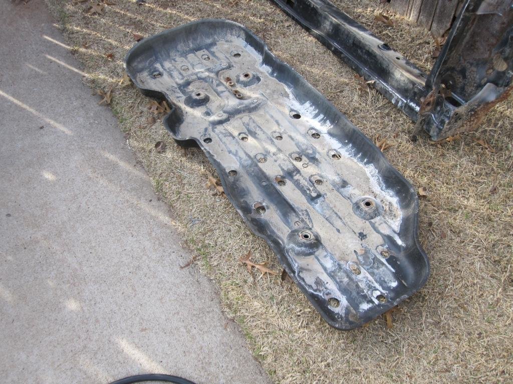

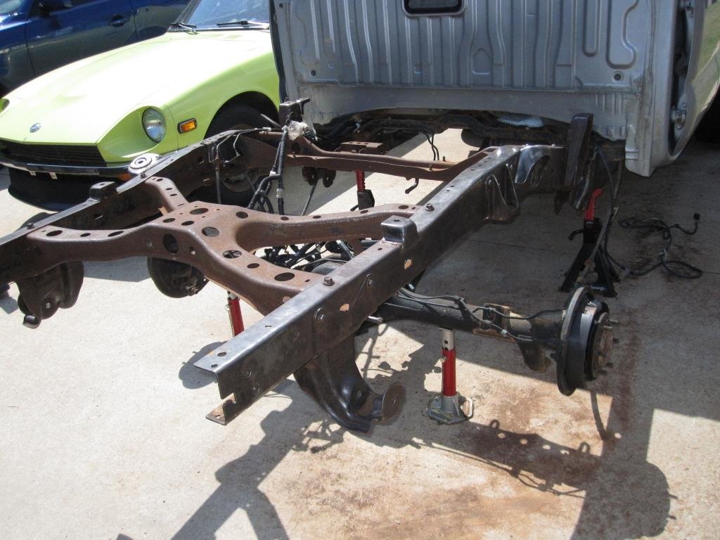

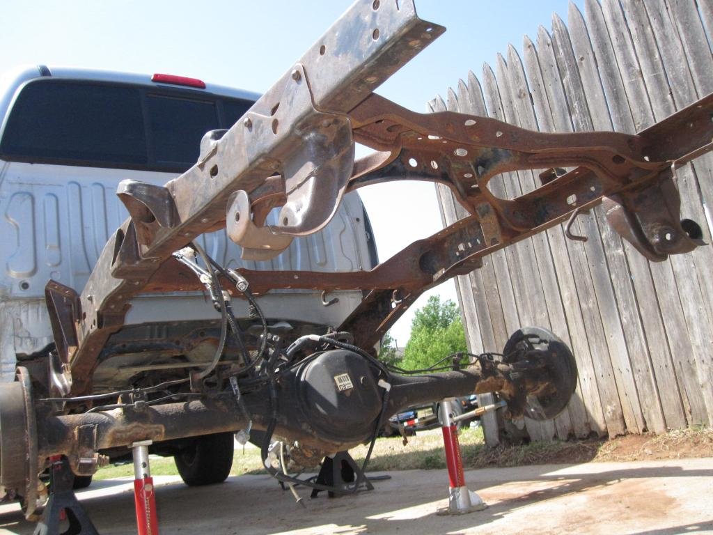

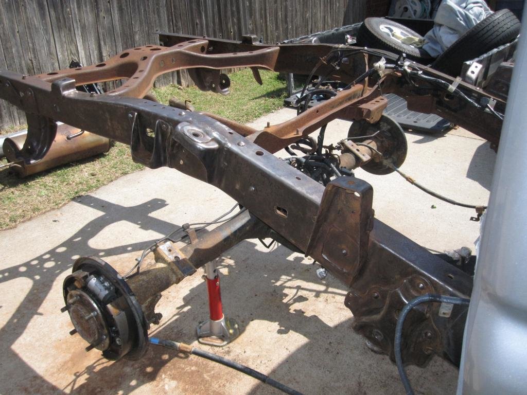

    Here are some pics from awhile back when i was taken apart the rest of the stuff from off the frame and did some rust chipping away.
    Wish i would had taken an up close photo of what the rust/coating/dirt mixture looked like, but didnt.

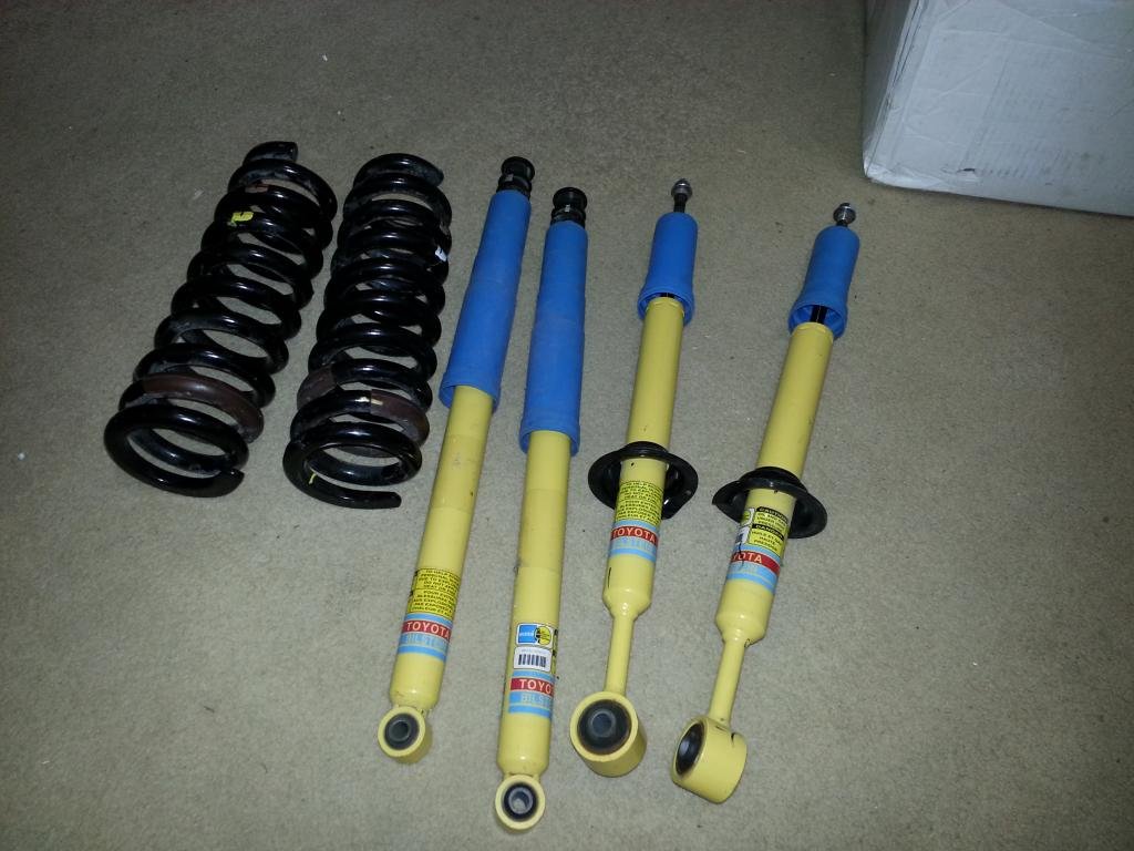

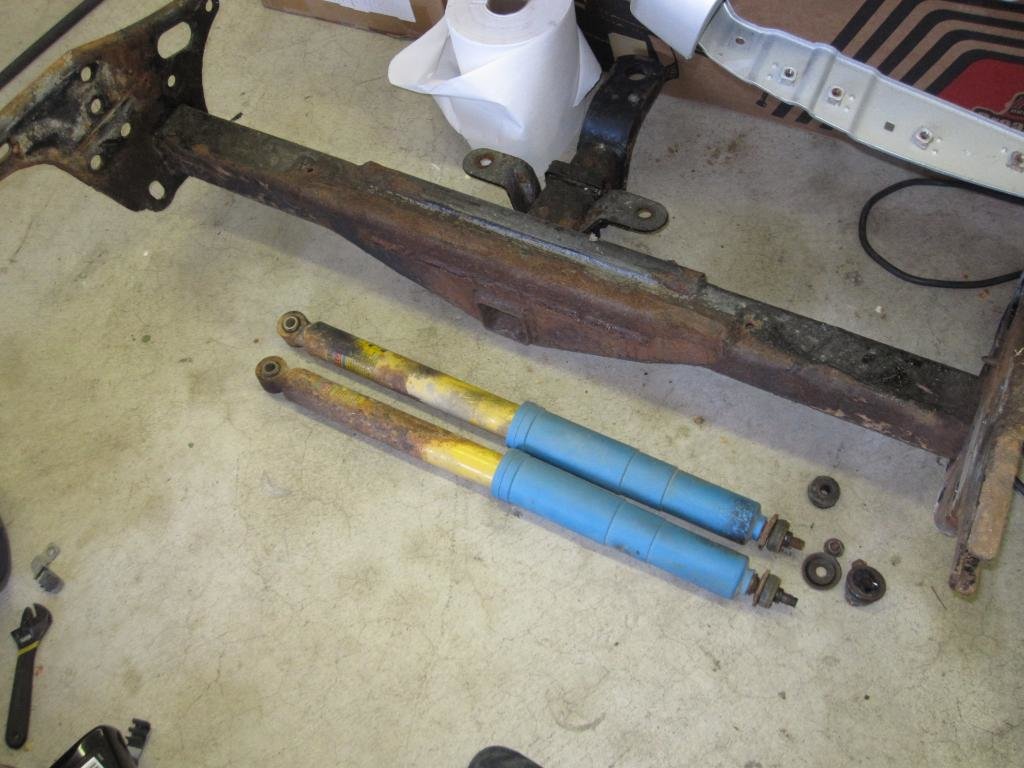

    Well here is a pic of my old rear shocks with the tow hitch. I had to cut the top of the shock to get it off since the nut was to corroded on the threads which is the reason whey i bought another pair.
    New used pair, came off a 2012 off road tacoma with about 500miles.

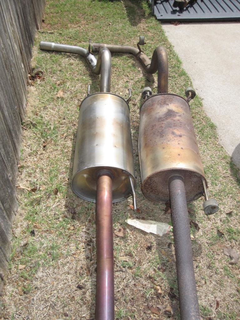

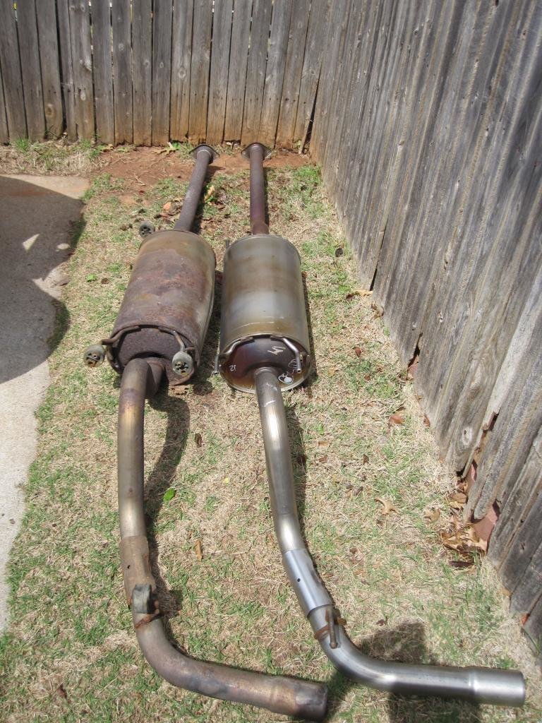

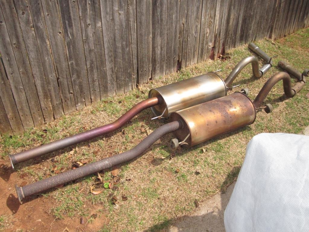

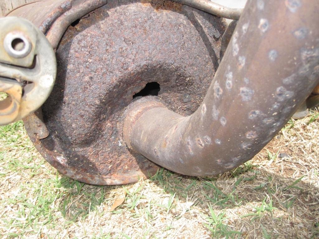

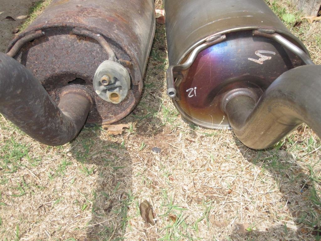

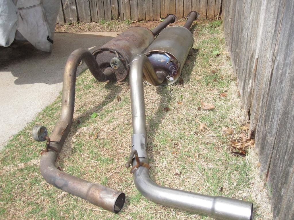

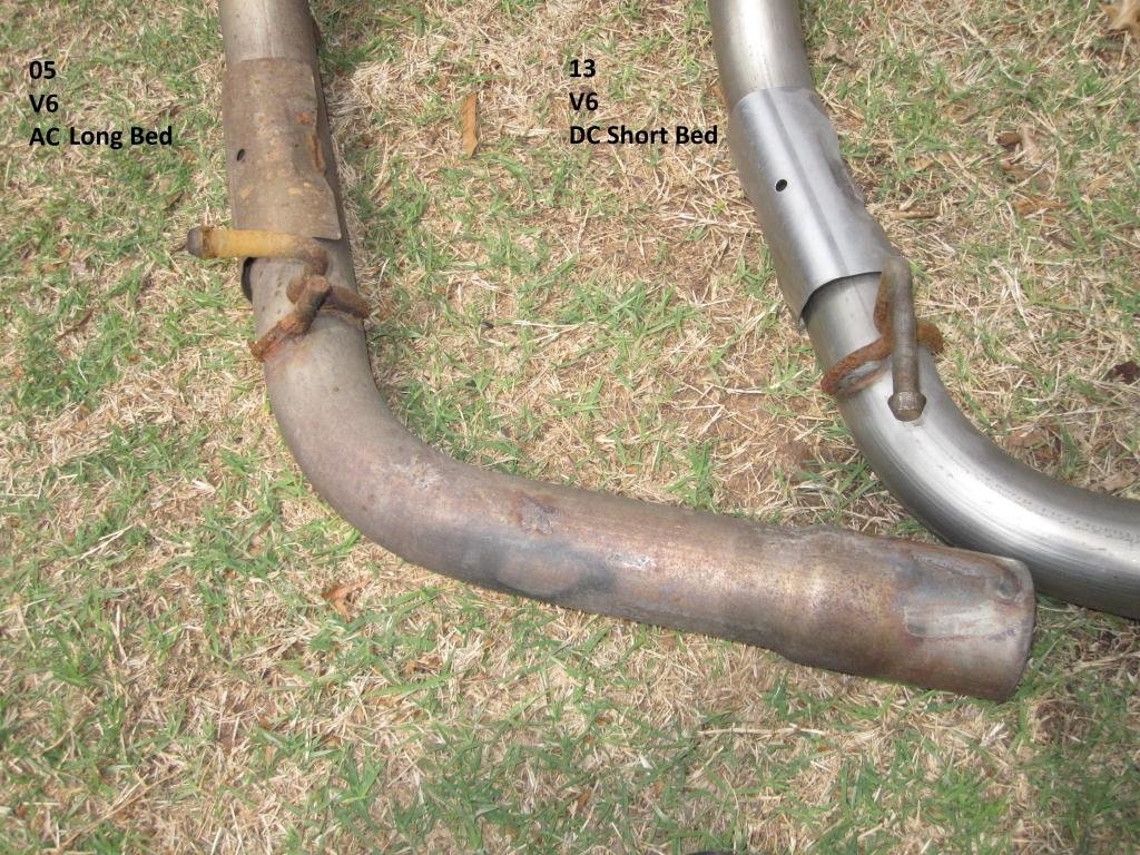

    Next i got my replacement muffler. Got this thing last Saturday. These are comparison pics compared to my old rusted muffler. The new used muffler came off a 2013 with 1k miles on it.
    So the only difference in the two is where the last rear hanger is angled. I put description in the pic, not sure if you guys can read it.

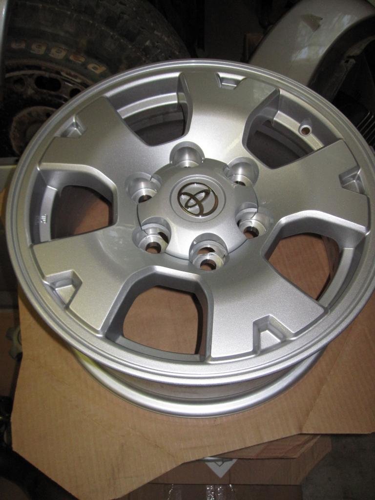

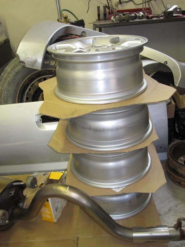

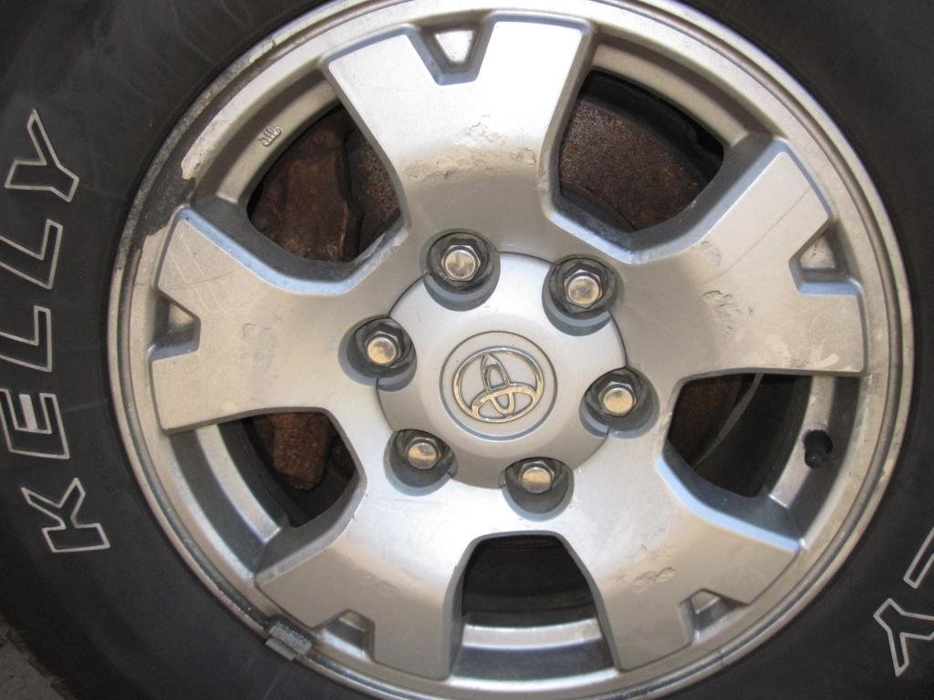

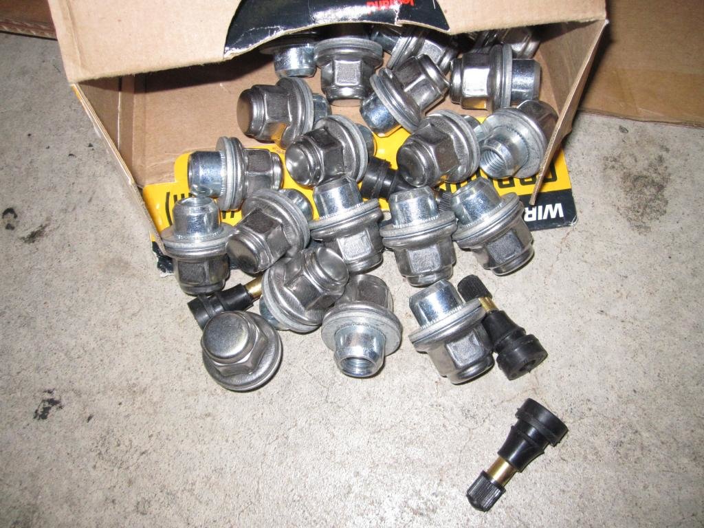

    I also purchased me a pair of new used off road wheels awhile back.

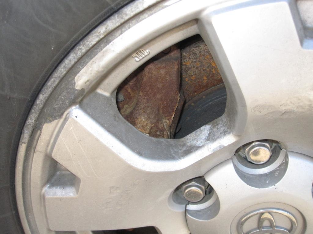

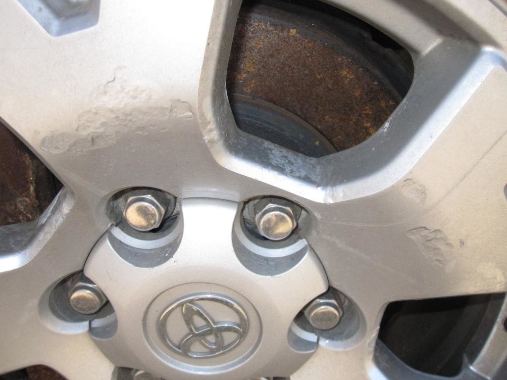

    Here are a pics of one of my old wheels. The rest look similar.
    Here are my replacement wheels. These came off a 2013 with hardly any miles on them. Owner said his wife took it straight to the tire shop to have the wheels replaced with aftermarket ones. He also gave me the lug nuts and brand new air inserts.

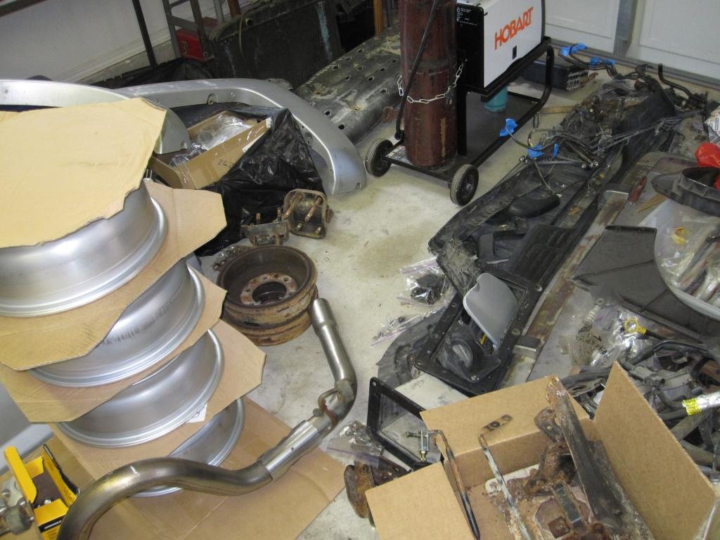

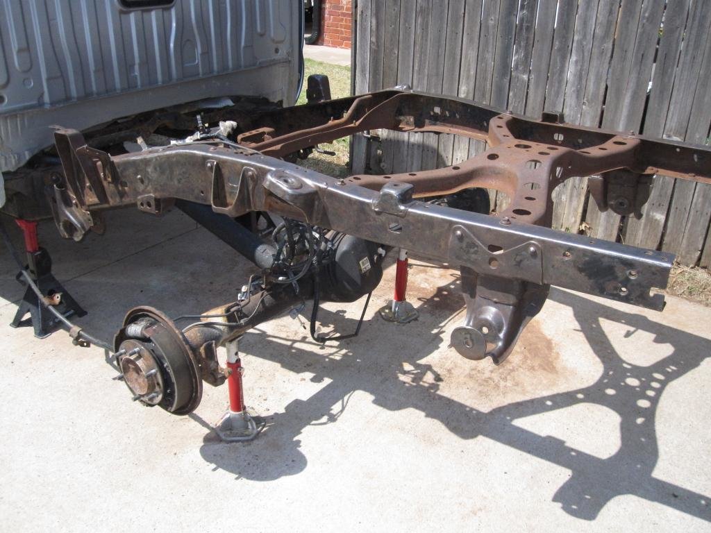

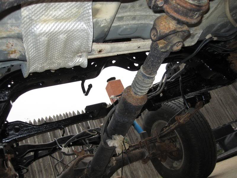

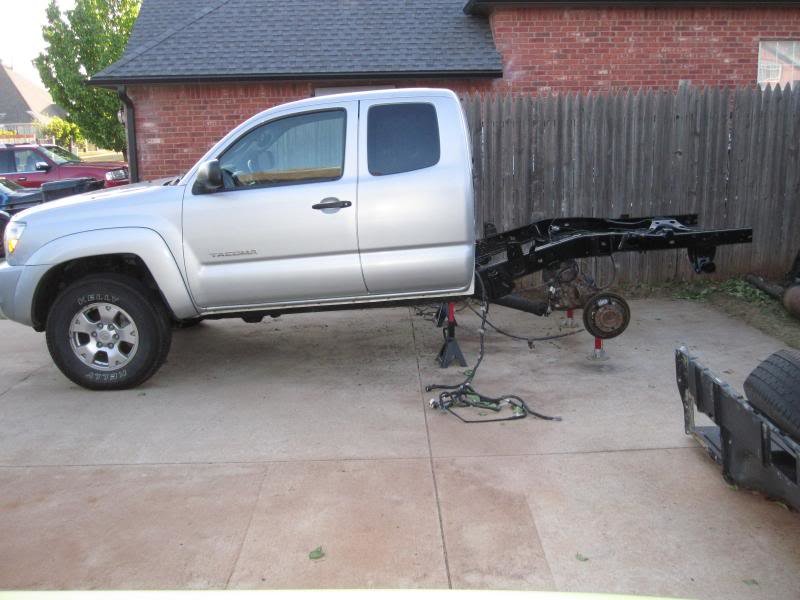

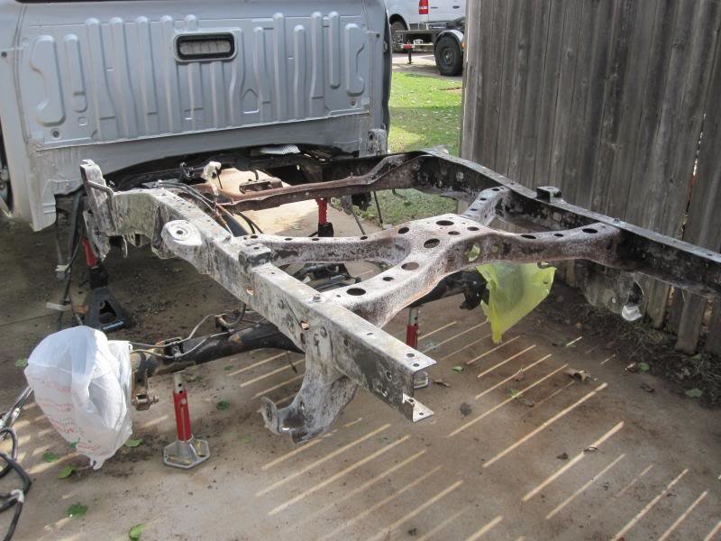

    Now here is what the truck looks like. I worked on it sunday quite a bit. Almost done with chipping away rust and wire wheeling it. For sure it will be coated this weekend unless something comes up changing my plans.
    Bunch of random parts. Cant wait to put my truck back together.

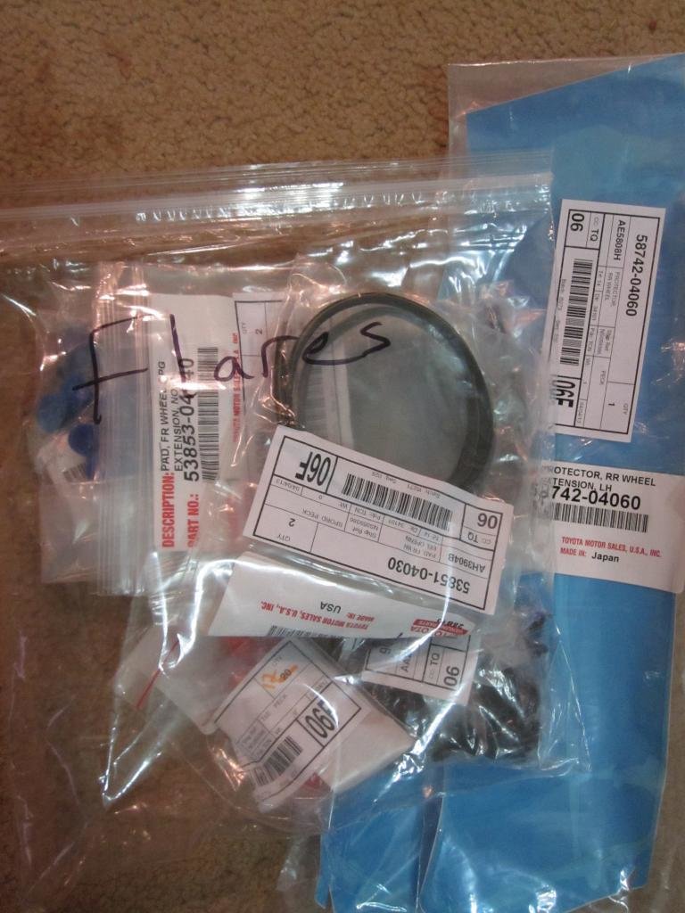

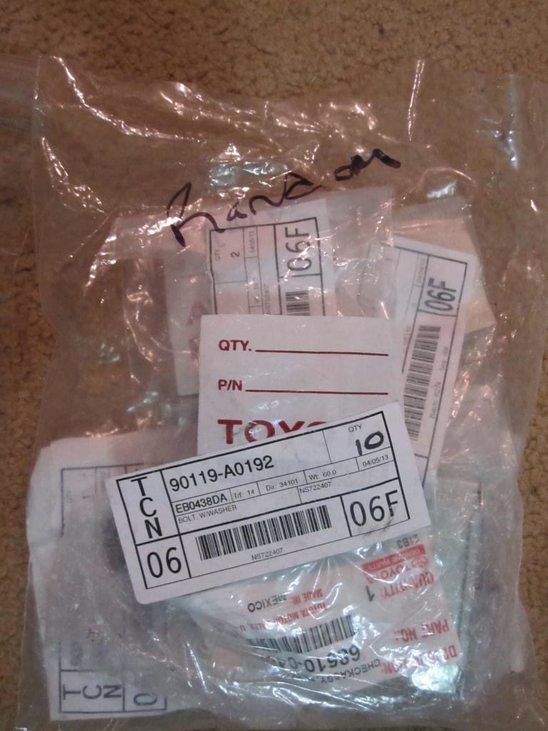

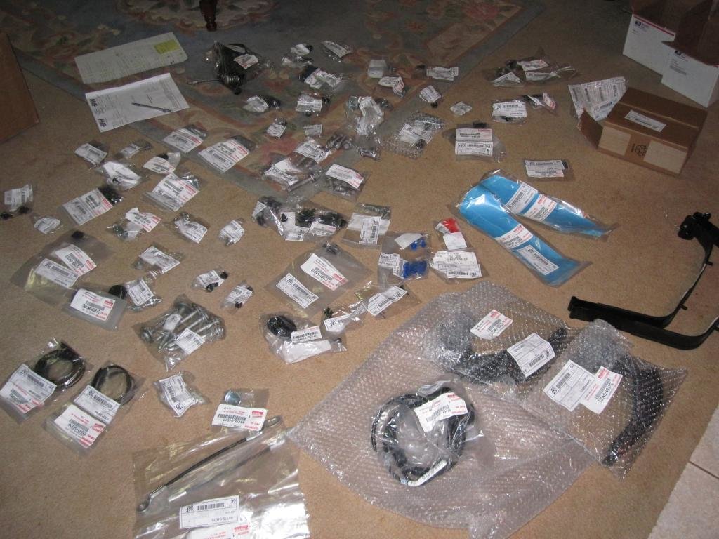

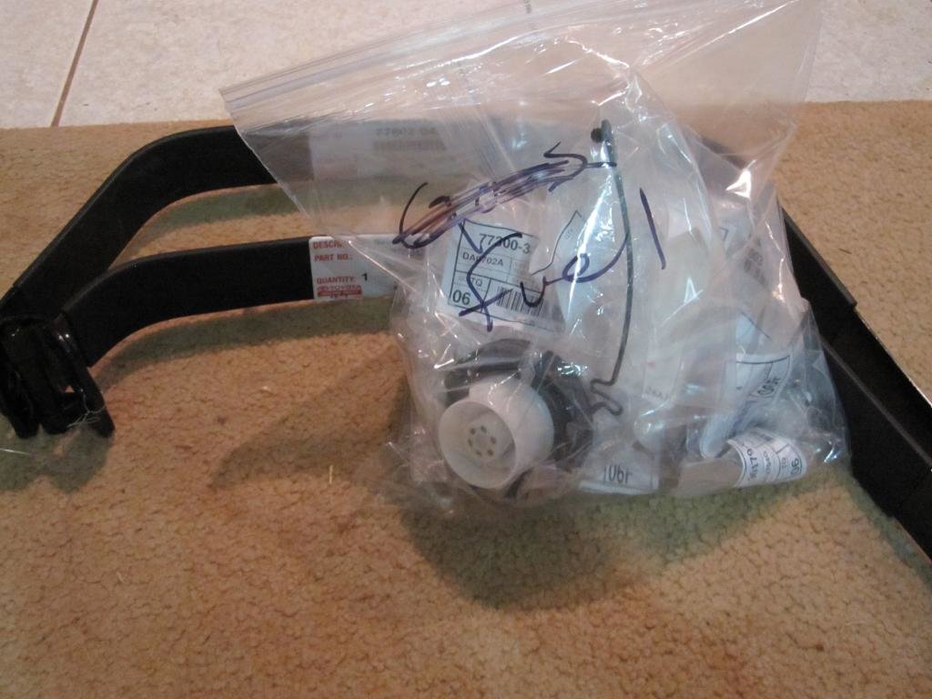

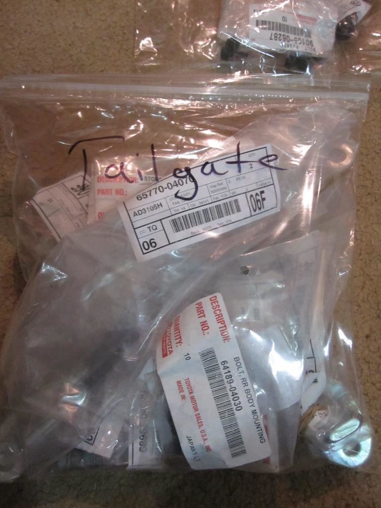

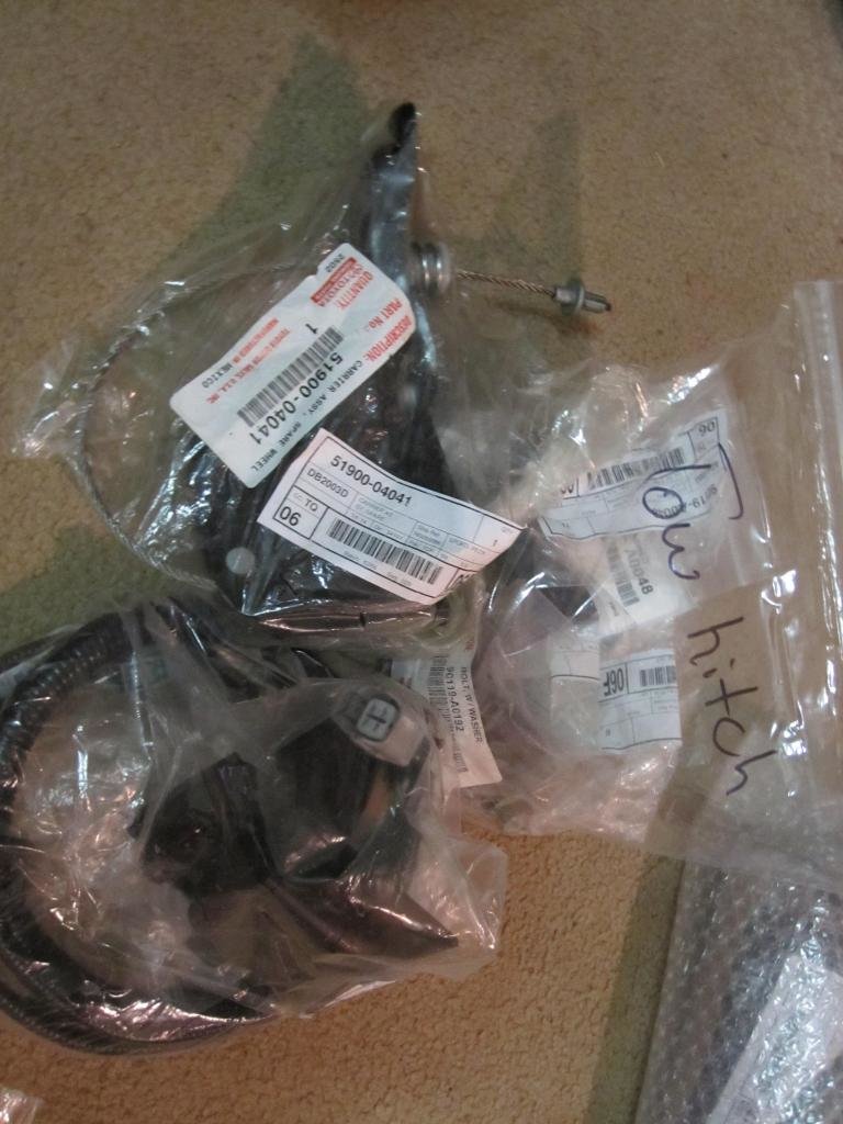

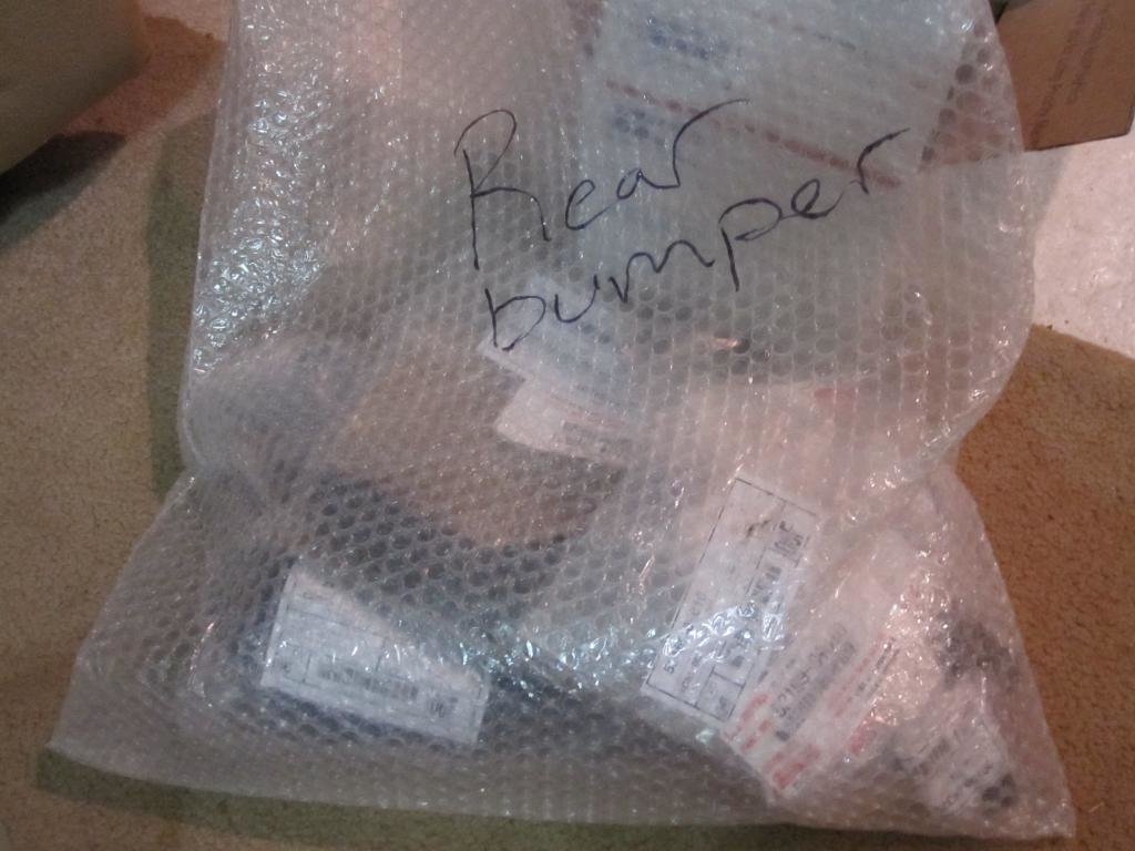

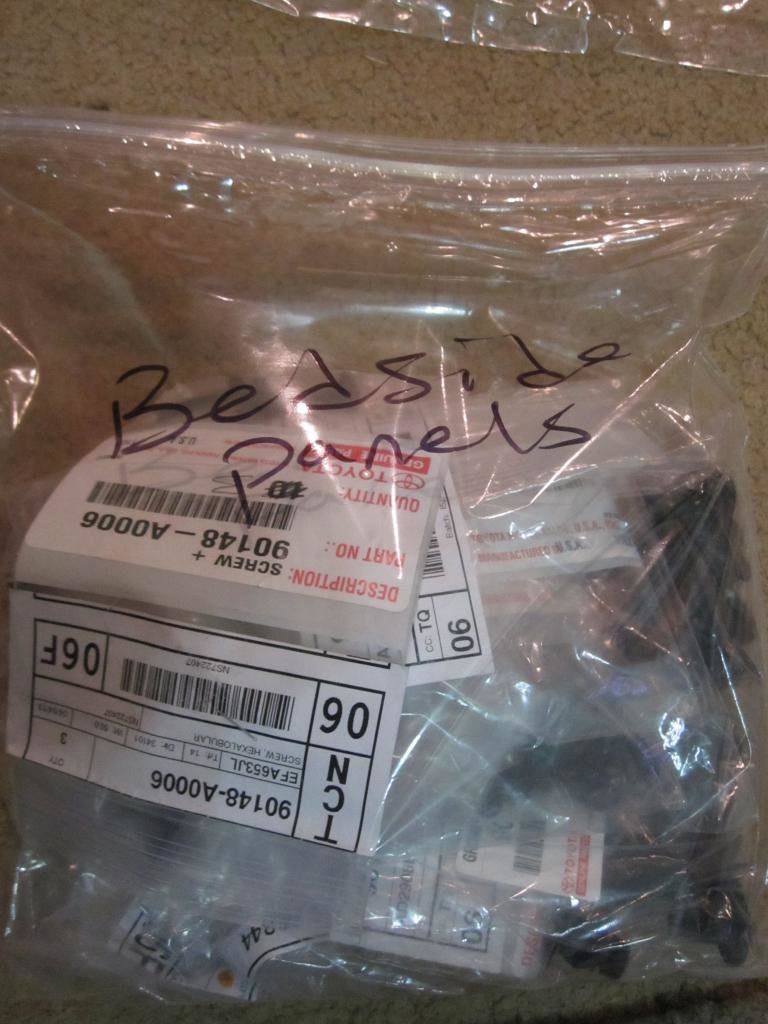

    My order from the dealer parts came in today. Ill take more detailed pictures when its time for assembly. Took me over an hour to organize and check the list. The dealer parts department made a few mistakes. Gave me two extra bolts pertaining to the rear bumper and hitch attachment that cost a lot more (didnt get charged for it) instead of 2 bolts i need for the hitch to frame attachment which were a lot less expensive too. Not a big deal, ill just use two good old bolts i have for it. not worth my time for a few bucks that costed them. The other mistake is the trd off road decal is not in the right color format for my silver streak mica truck. Debating if i should exchange it or use it.
    All organized and grouped together
    The wrong color decal for my truck color
    There are actually a few things i did not order that i need but its not to important right now. Can always order later when the truck is put together and driveable.

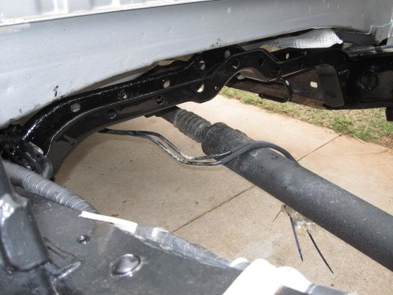

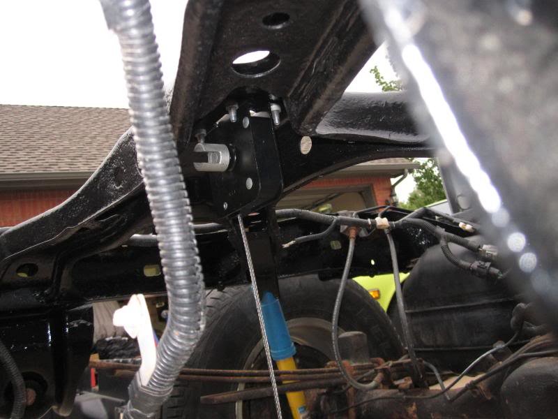

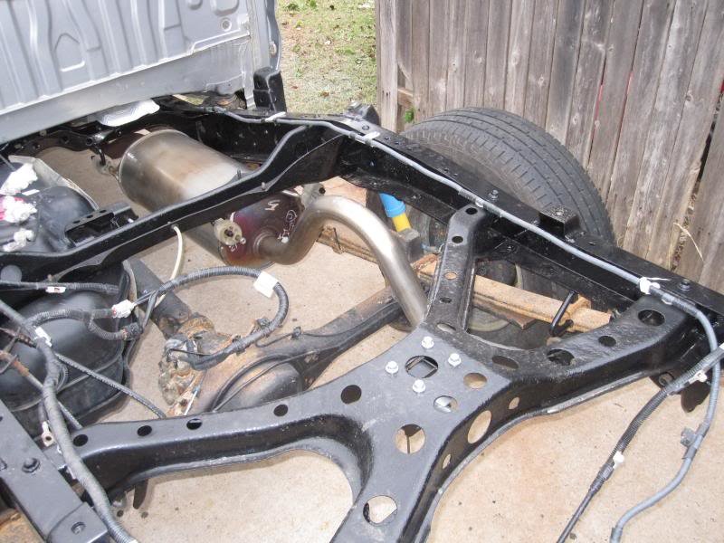

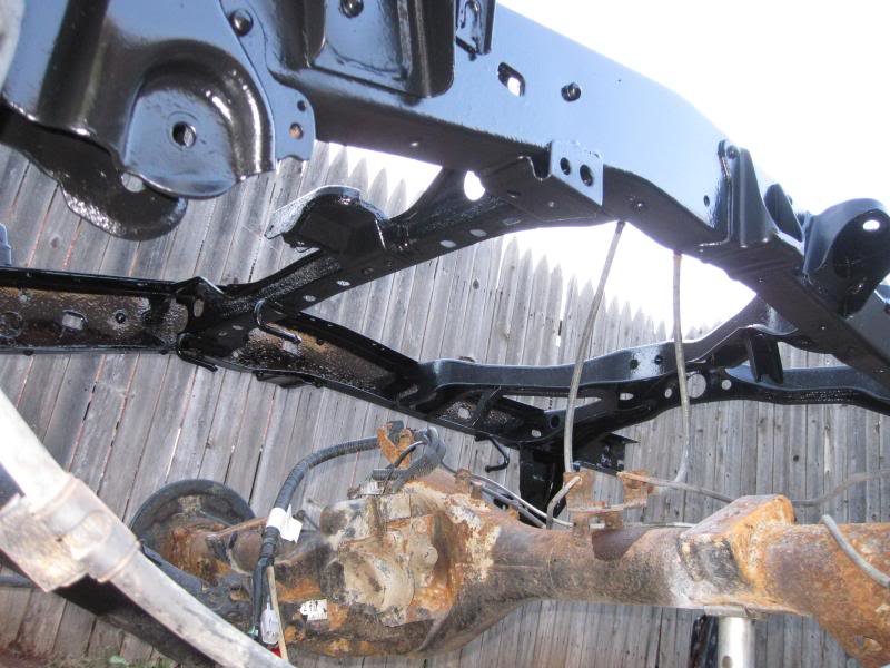

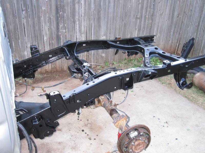

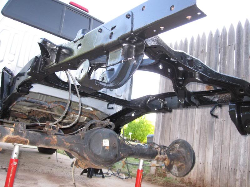

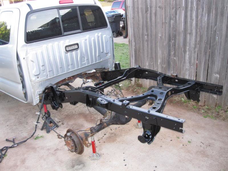

    Update!

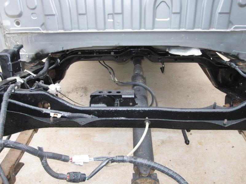

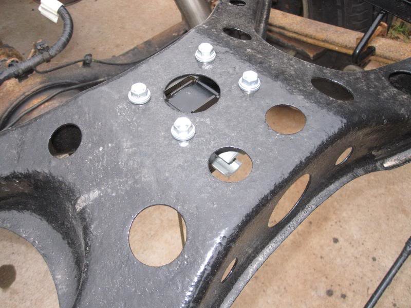

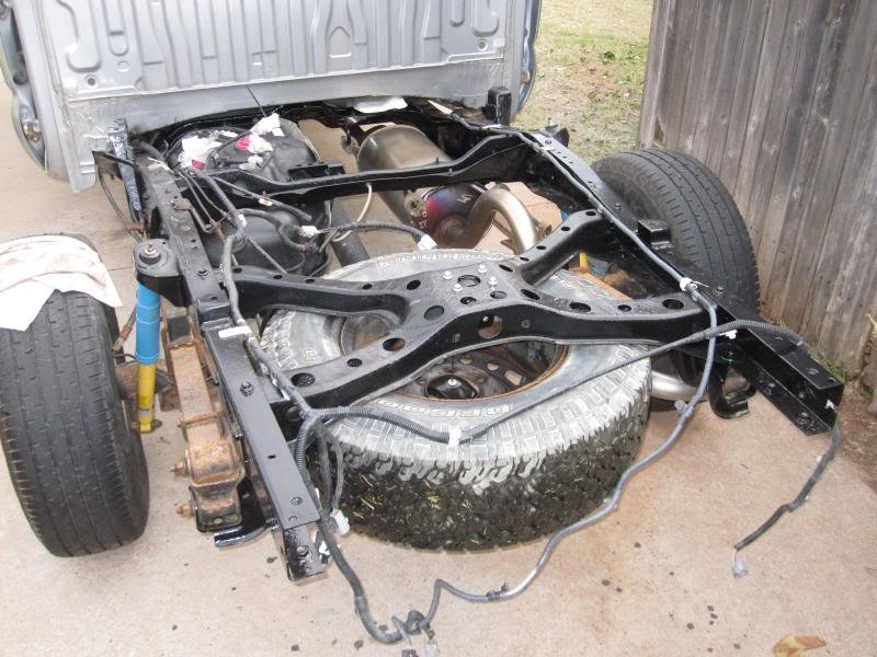

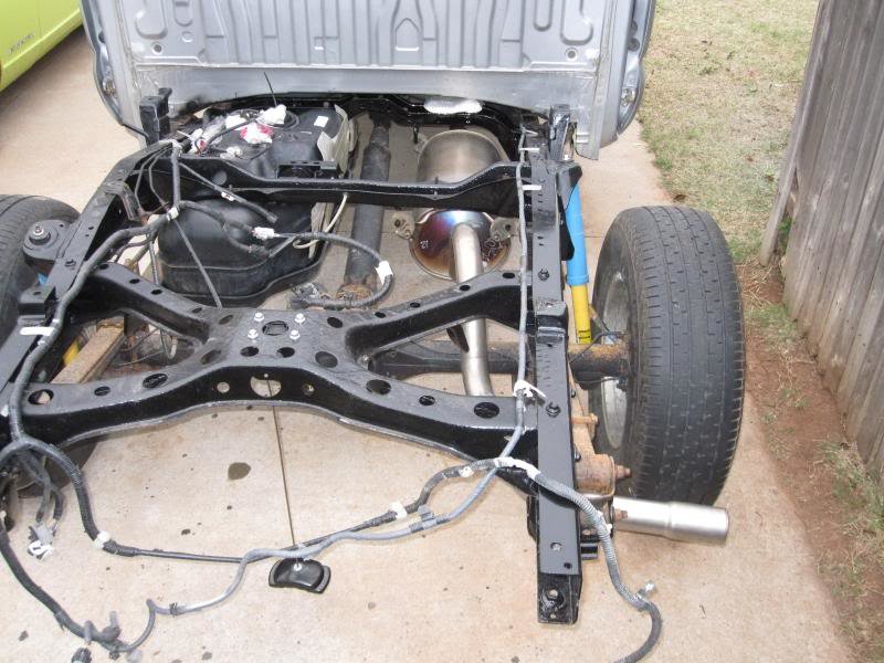

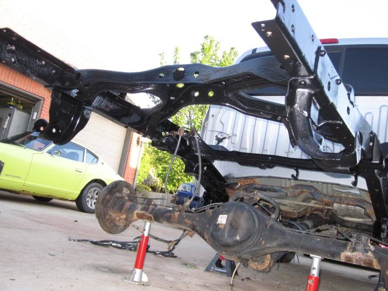

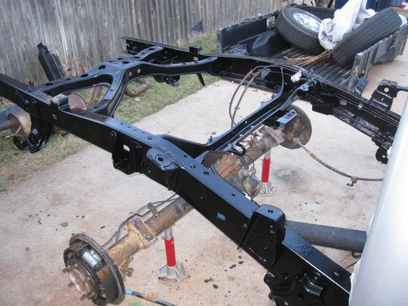

    Just finished up coating the rear part of my frame. Still have a few things to coat but this is pretty much it.
    These pictures show what prep and ready por15 looks like after being sprayed on, let set for 20-30 min and watered down. It leaves a zinc phosphate coating base for the por15 paint to help chemically bind to the rust and unrusted metal.
    After everything is bone dry, I coated with por15 rust preventive paint and then used por15 top coat in a spray can to protect the rust preventive coat form uv light. Its really just the sides of the frame beams that need it but i went ahead and top coated everything since it will be sitting like this for a week or so while i work on it.
    I should of used silver instead of black in some areas cause it contains metal filler that would of helped smooth out the pitted areas. Oh well still looks good.
    Thats it for now, Just waiting for it to cure so i can start putting stuff back on.

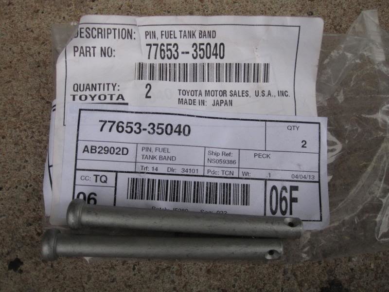

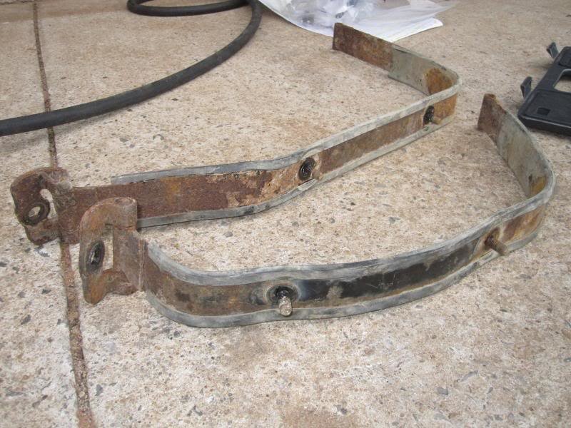

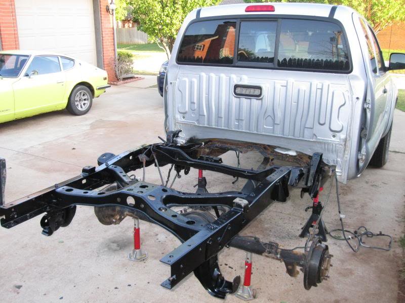

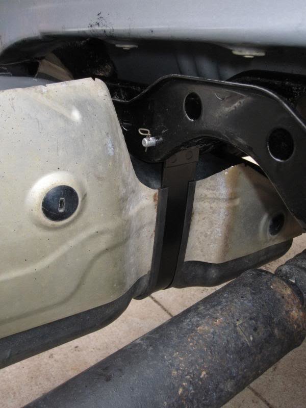

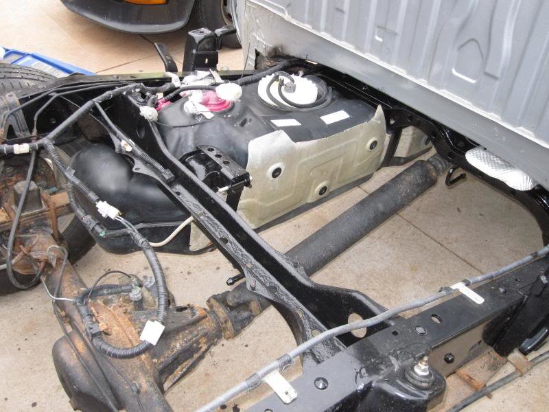

    Update

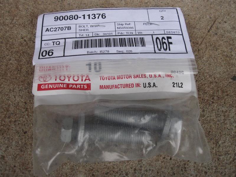

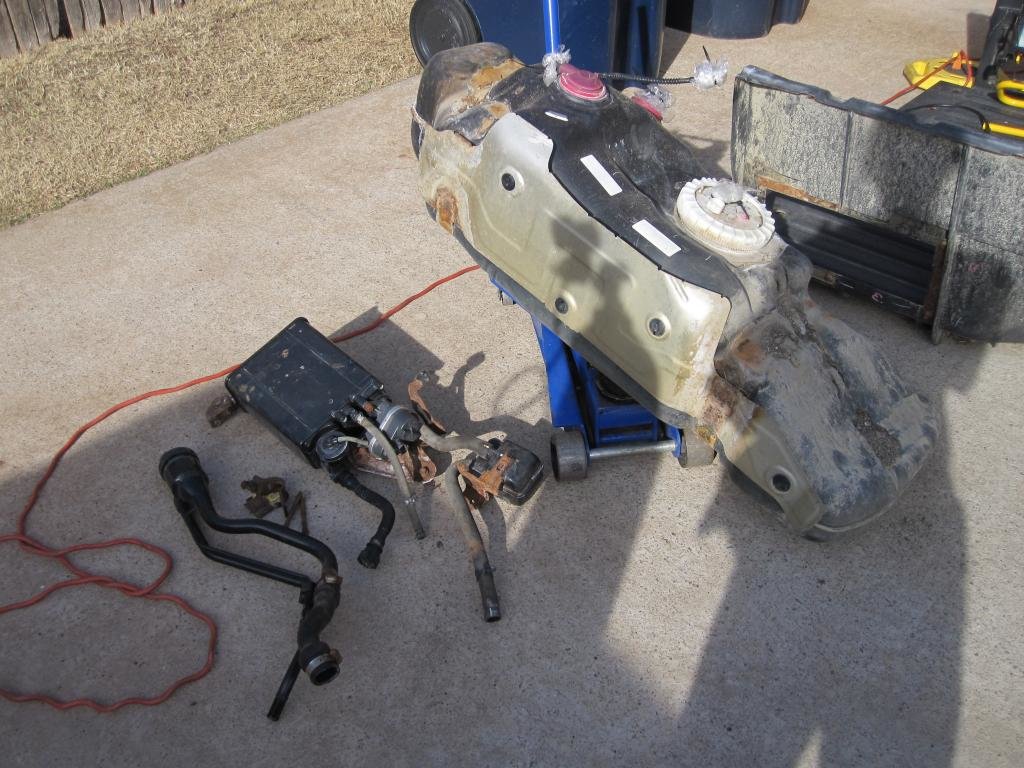

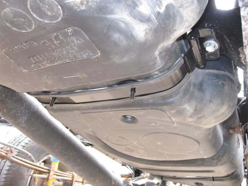

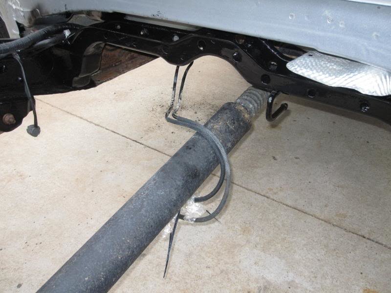

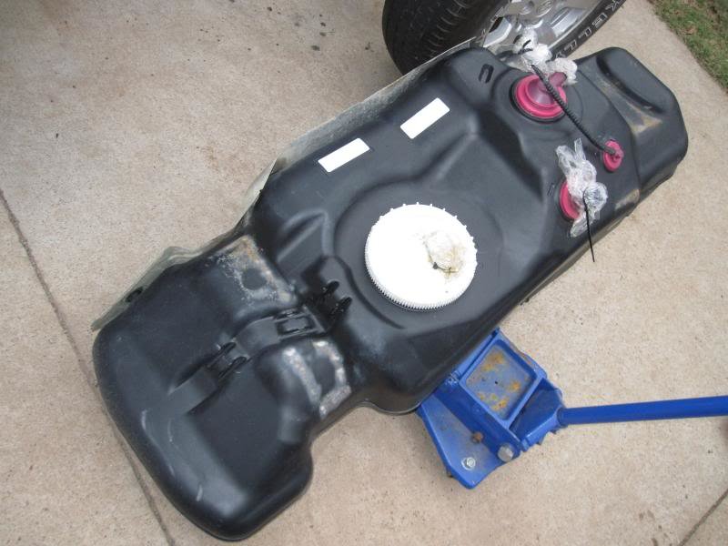

    Coated the cross member under the rear part of the cab.

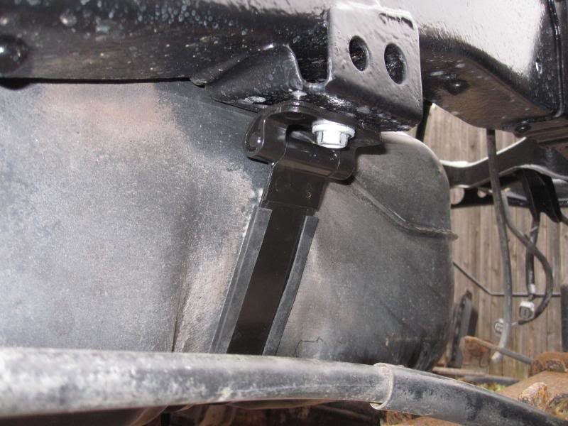

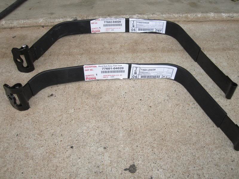

    Cleaned and put the fuel tank back on with new hardware.
    New straps
    old straps
    new bolts and pins

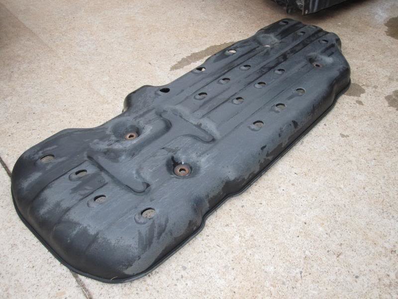

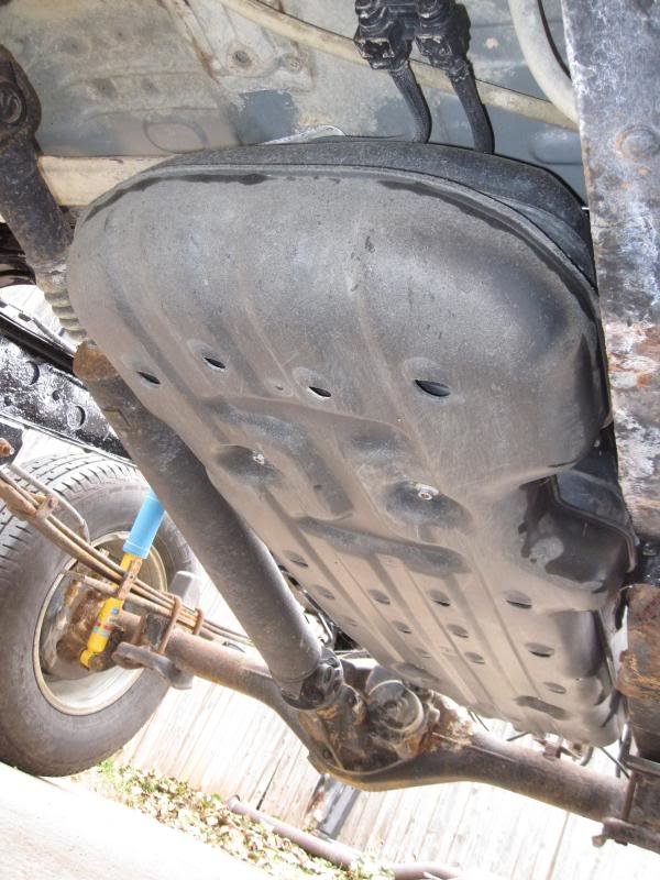

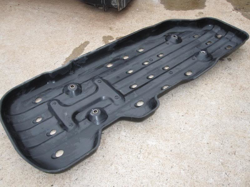

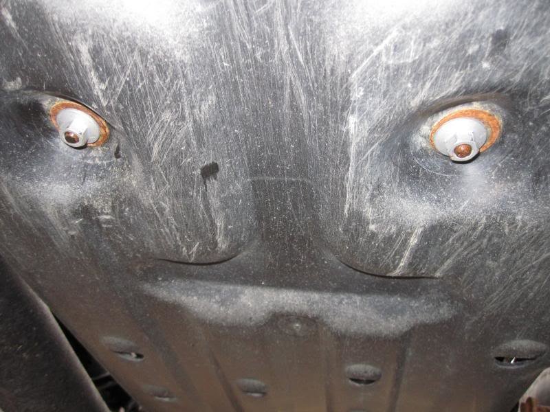

    Tank installed. In case any of you have to take the tank off and need to put it back on, make sure you installed the pin side first then the bolt side. I was at it for a little while and could not figure it out. I read the fsm and got it done within 5 min.

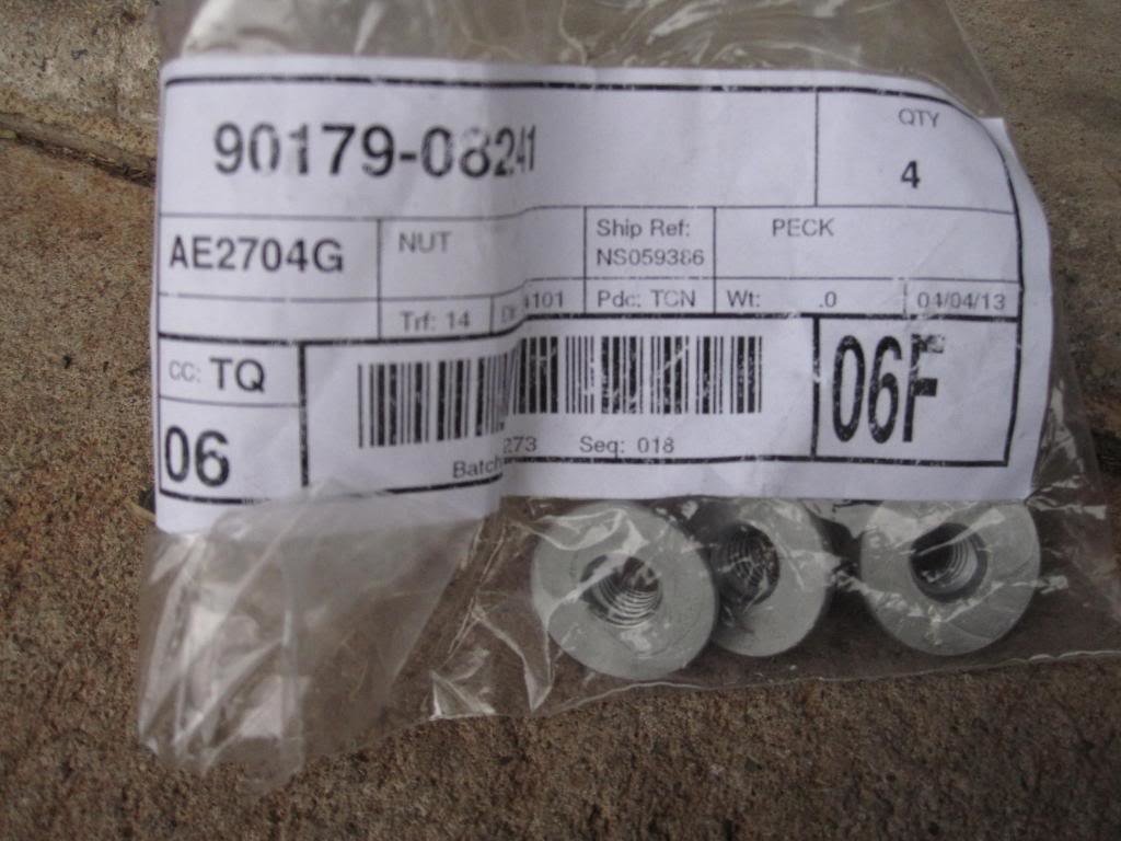

    Cleaned the tank under guard and new nuts for it.

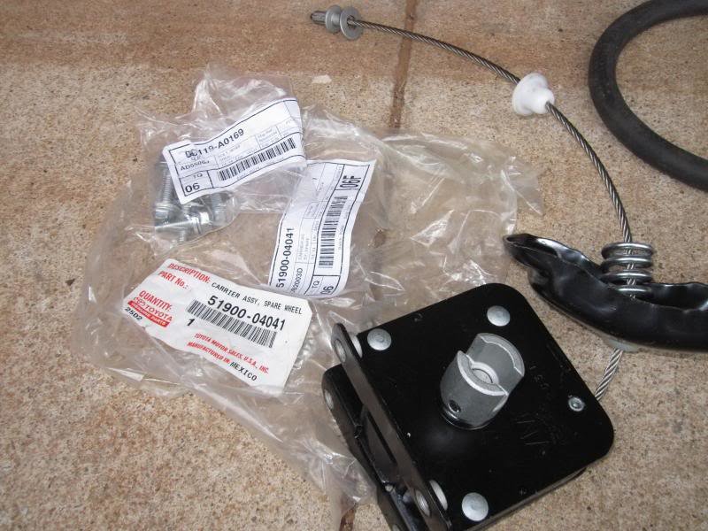

    Installed my new tire carrier
    New carrier with new bolts

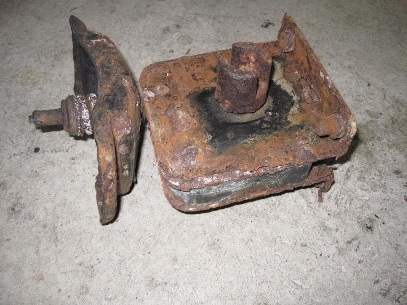

    Old carrier
