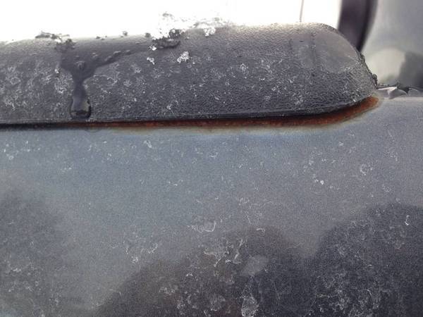

    Be careful putting a lot of weight on the bed rails. They're not strong at all. The composite bed comes up vertical and the steel bed wraps around inside. There isn't any reinforcing between the steel and the composite. This is the result of using a tire carrier on the bedside.

    So are you filling the bedsides with the caulking, or just putting a layer to prevent rust due to the plastic caps?

    Bed rail reinforcement by taking hollow plastic and turning it into a solid so it disperses weigh better.

    Okay, so the plastic bed rail was filled with caulking, making it solid? Not actually caulkimg the metal of the bedsides.

    Has anyone tried putting some kind of material (pond liner?) to soak up some dead space requiring less chalk? Or perhaps another idea? I'm getting a bed cap next week and this has me worries!!

    No idea how you would cut pond liner to work, but I'd love to see a different approach.
    You should be worried - that's a good deal of weight. Good luck.

    How long did your method it take to cure? Have you noticed any discolored run off from when it gets wet? Black drips?

    Dow 795 won't discolor or cause color drips. I've had black on my white fender in the sun and weather for years around my snorkel.

    Unabashed thread rivivalist? Filling the voids seems a good idea but it might do a better job of rust prevention if you go ahead and bond them to the metal and eliminate the movement that rubs the paint off. Do a prefill w/resin to create a uniform thickness and reduce shrinkage volume then squirt it with silicone or vhb and stick it on. Mask the bed wall before removing them(need to do that anyway if you repaint) and any squeeze out is easily removed.

    I'm getting ready to put a cap on and plan to use butal tape. That's what they use in RVs to seal and protect parts, and it won't ever get hard. It may not be the best for smaller point loads like a rack system, but for a cap, I'm thinking it will work well and keep water from splashing up and into the bed at those holes.
