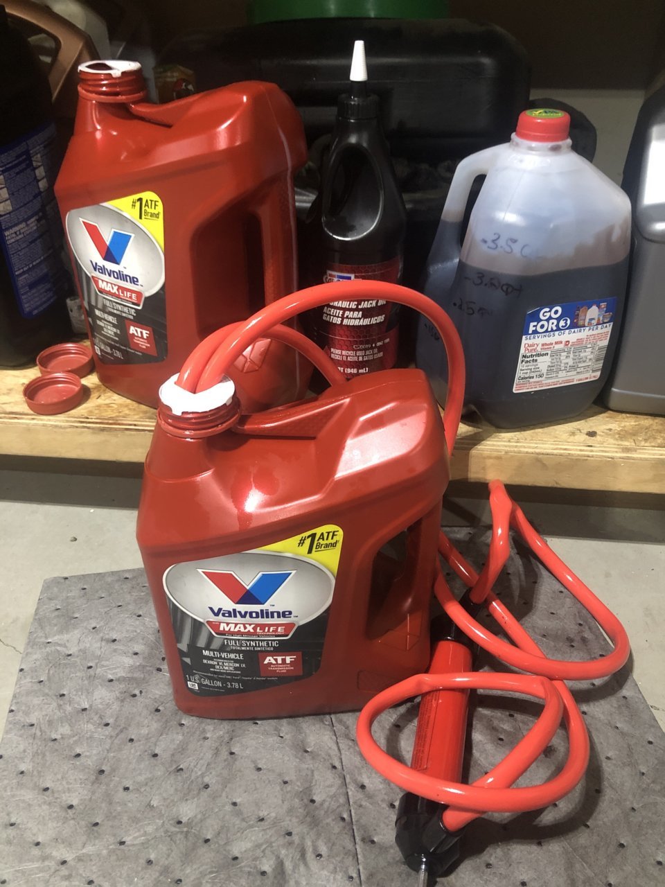

    I decided to drain transmission oil, i got about 3.2 quarts out of the transmission, I won't comment of condition of the oil because i don't know exactly what I'm looking for. But i decided to overfill the oil by about 1/2 quart. I got transmission up to about 100 degrees and took the check level plug out and no fluid came out. So i added about .7qt of fluid before i noticed a trickle coming out. I did this with the truck running, by the time the fluid started to come out the temp of trans was about 105 degrees.
    After filling the transmission with approximately 1.2 quarts more than i took out it doesn't make the same thump I was getting its almost gone after servicing the transmission with the amount of fluid i think it should have.

    I have two recommendations for you, go get a flush and get rid of that Toyota WS transmission fluid and put in Valvoline Maxx Life ATF. All 11 quarts that transmission takes, and then go get your carrier bearing replaced with either a direct fit unit built by Spicer, or put in some work and install one with a yellow Polyurethane bushing built by Inland Empire Driveline Service.

    I did fill the trans pan with max life atf after my first drain. I was going to do a drain and fill about every week for about a month. Until it comes out clean.
