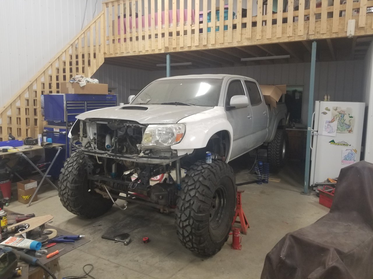

    Got the truck sitting at ride height and I'm going to try and lower it a couple inches. But need to do a little rework to retain the 7 inches of uptravel.

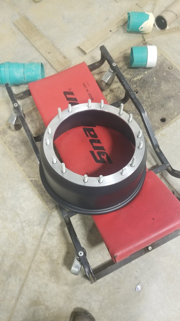

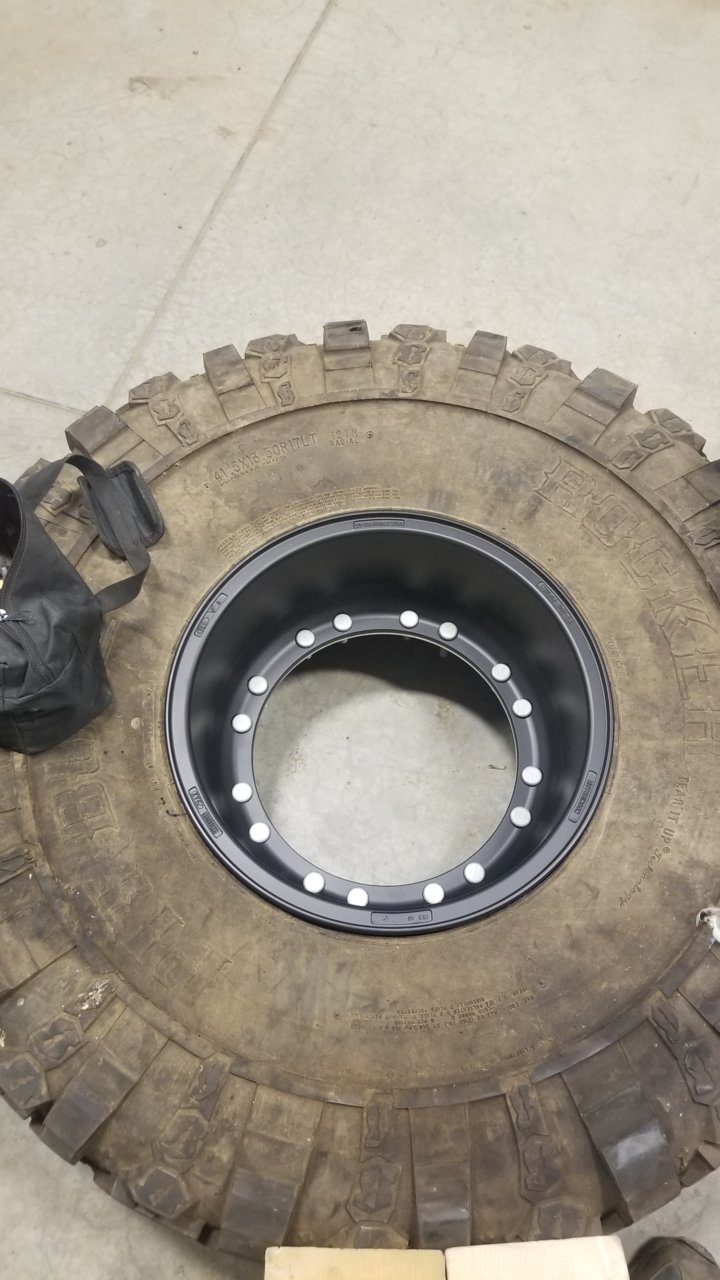

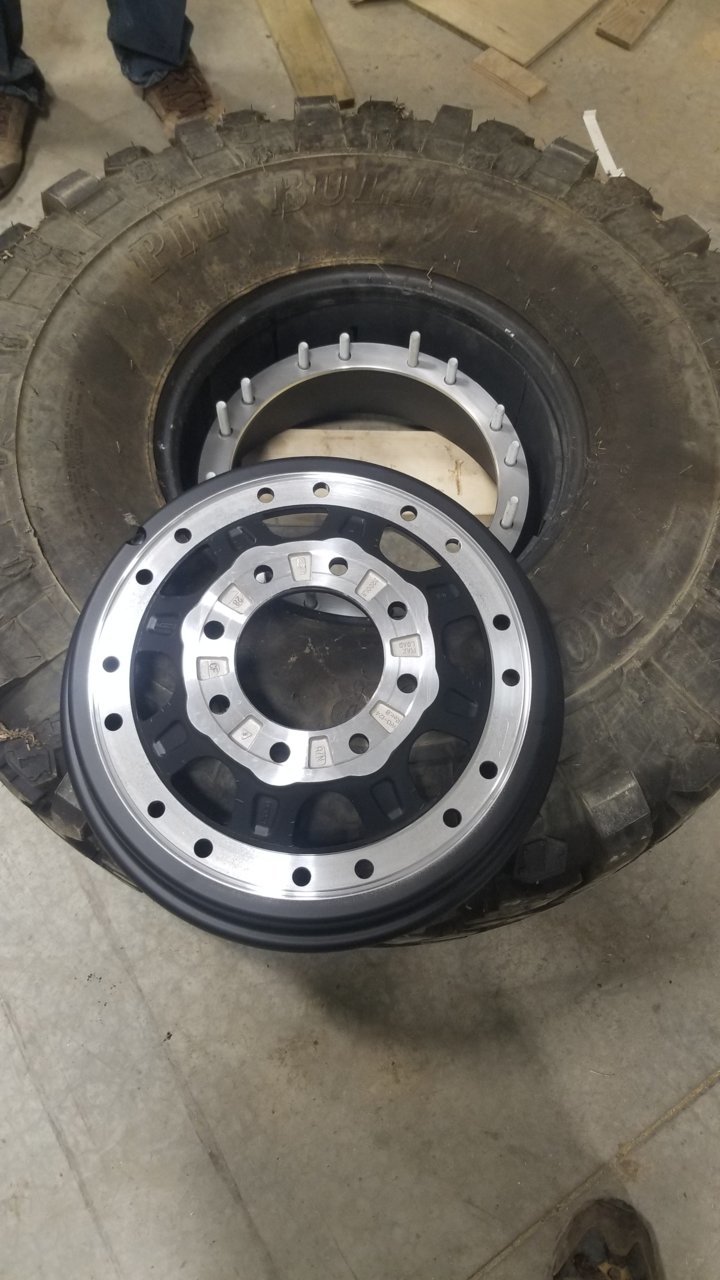

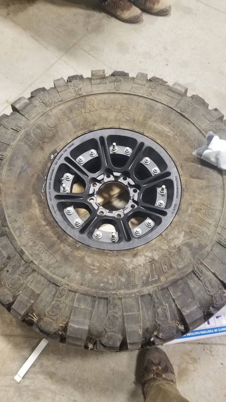

    Also as an added bonus got myself some Hutchinson beadlocks. These rims are awesome here is the build up pics took about 10 min to build up a tire and rim. Unfortunately I have to run 2 inch wheelspacers in the front to clear high steer. But it will be a half inch narrower in the front at 86".20181007_223006.jpg
