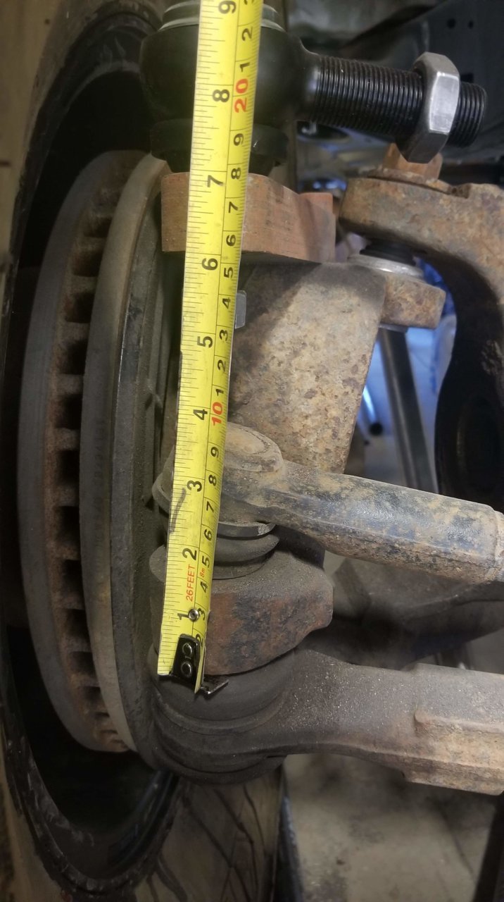

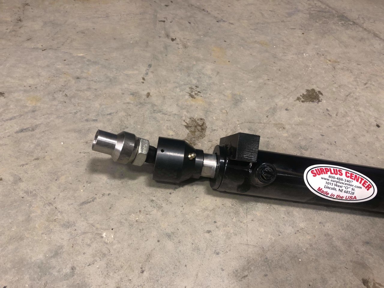

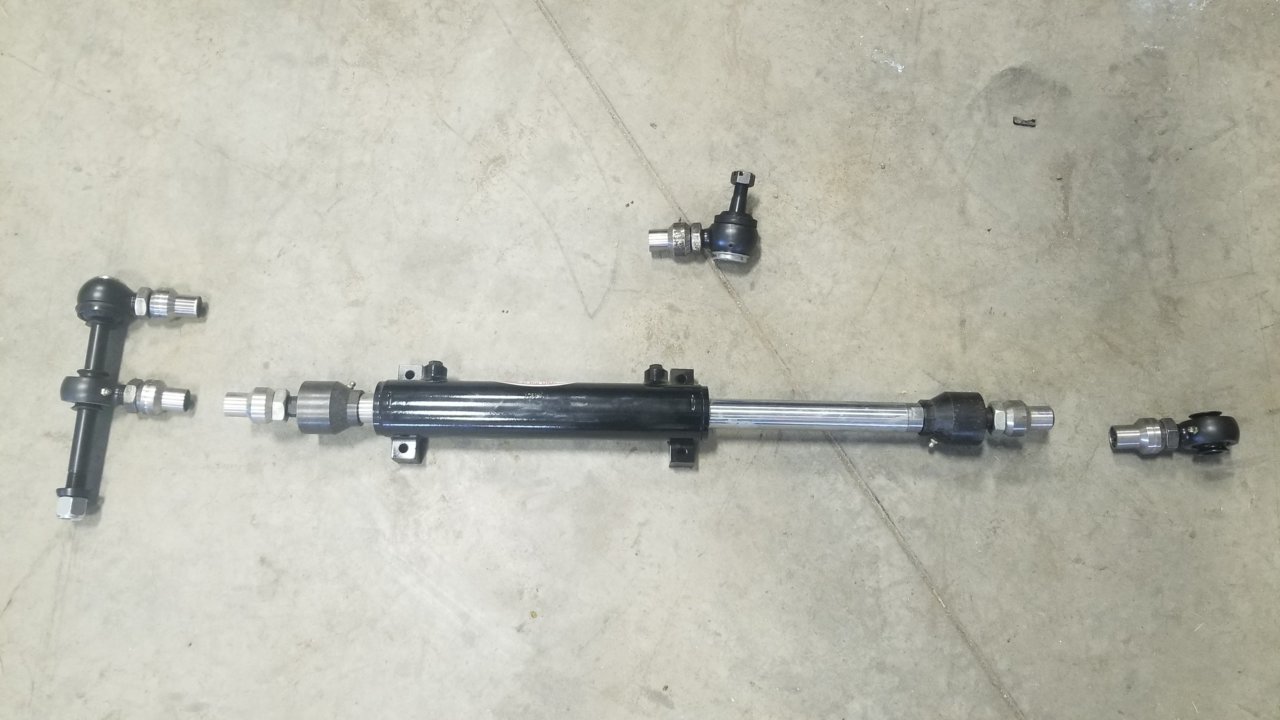

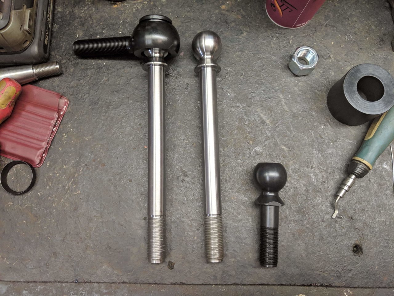

    Got my buddy at EMF Rod Ends to make me the custom tie rod end for my tie in steering. I got an extra one made while he was at it in the unlikely event I have a failure. It's 3/4" so lots of beef, here are some pics.

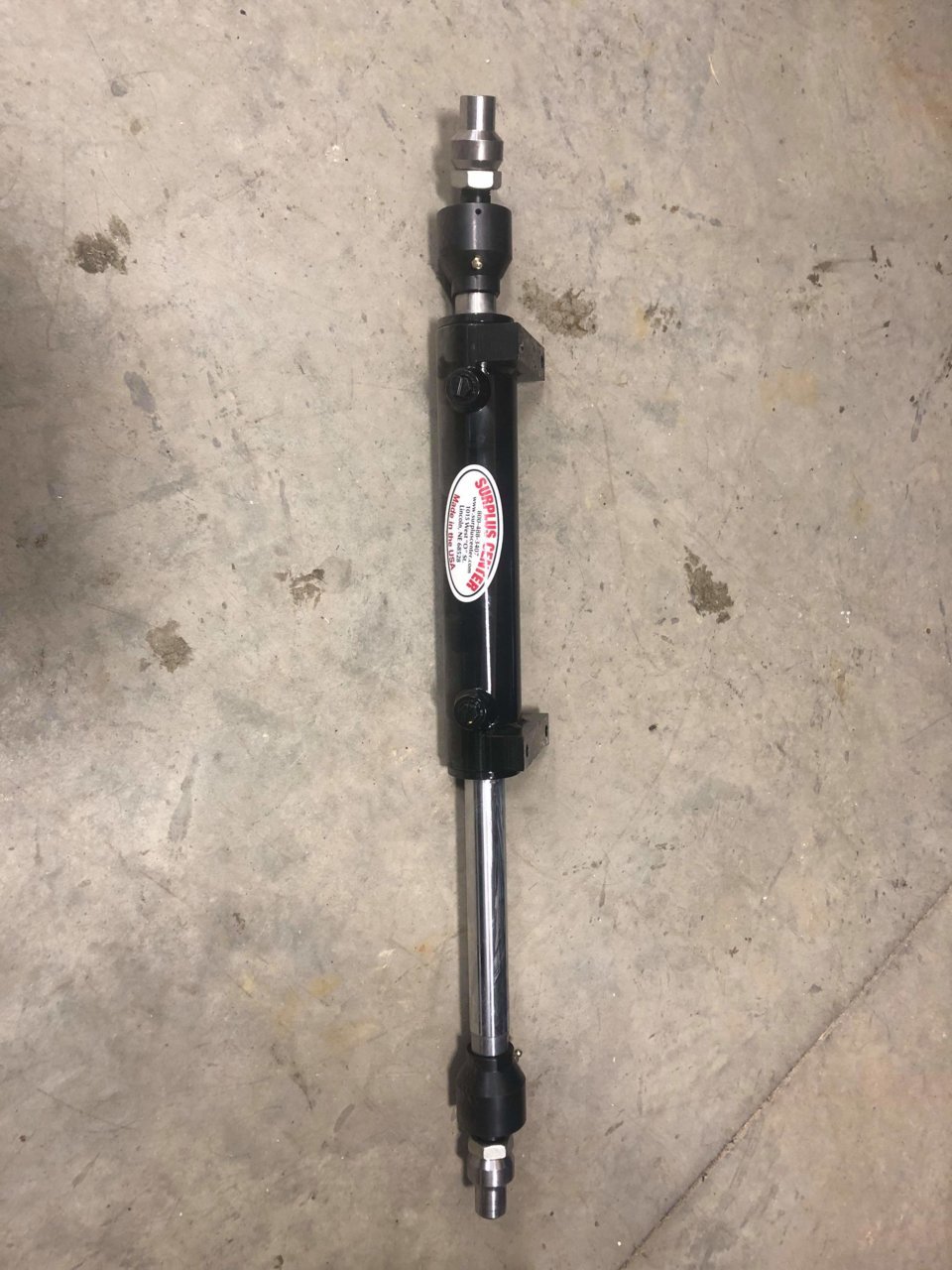

    Never did put up a picture of the ram I'm using. The weld in inserts are just going to be used for mock up. I'll get some tube threaded once everything is mocked up. Using EMF Rod Ends ball sockets, and I have a set of EMF small heims for the tie in ends.

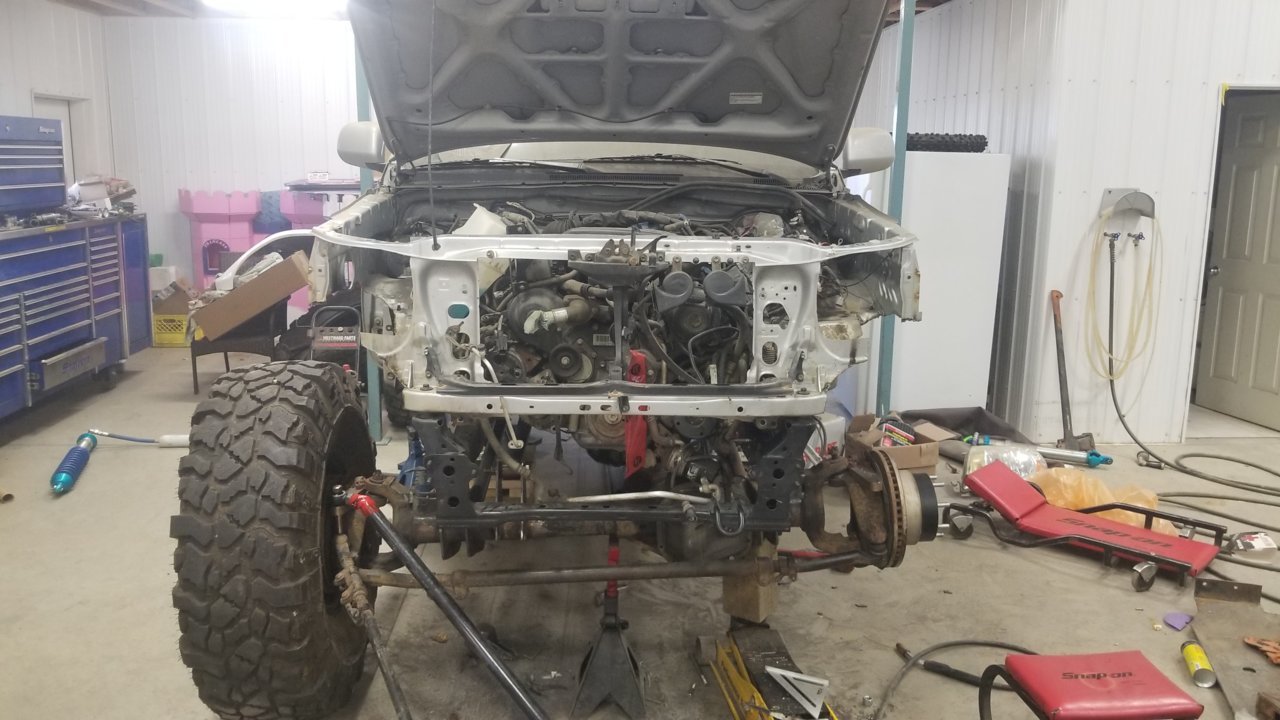

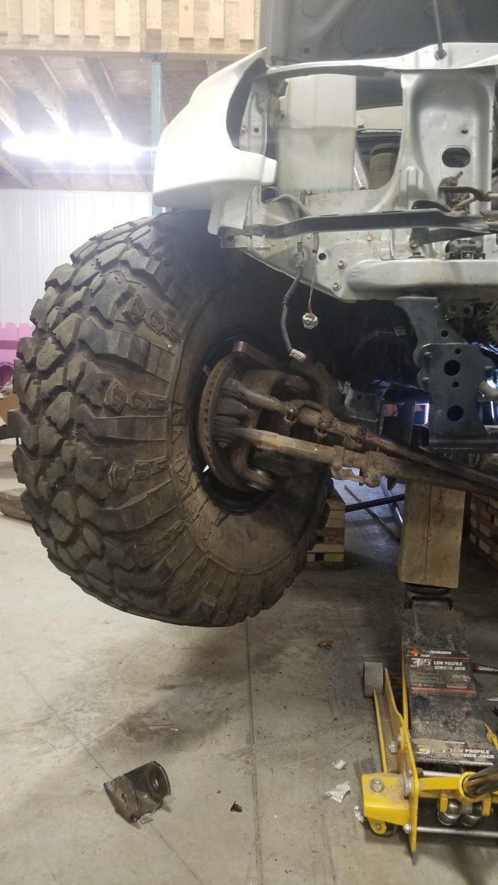

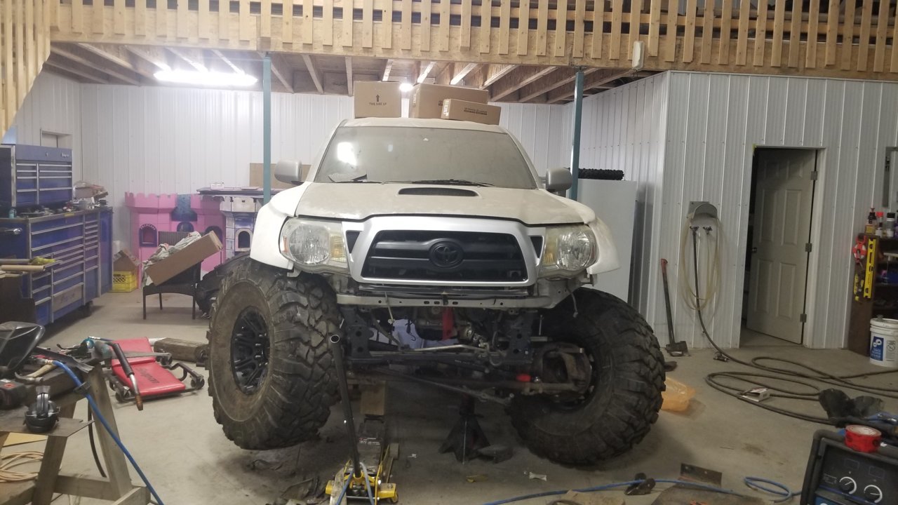

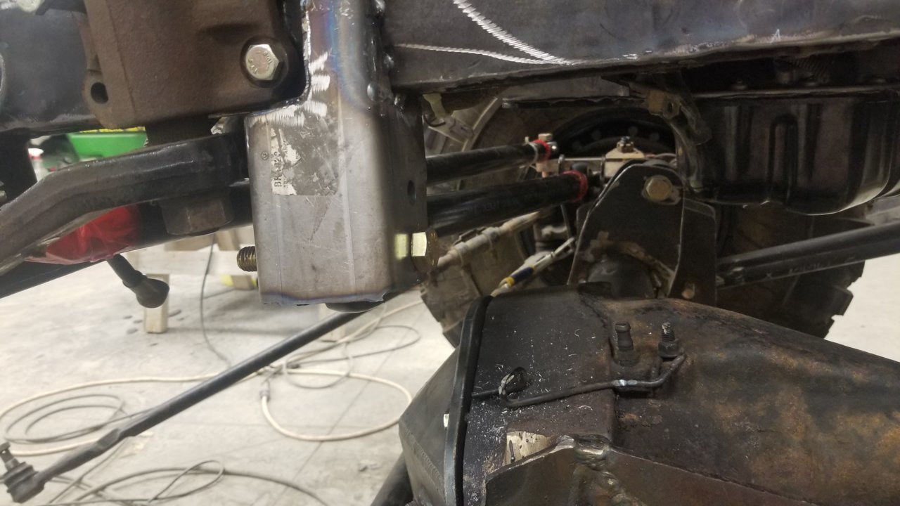

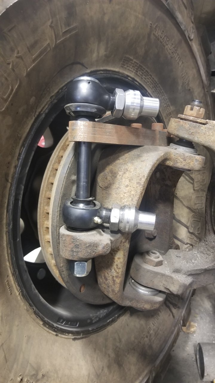

    Got all my steering parts together and made some solid progress on the truck. Here is how the steering is looking. Need to add tube and spacers on the tie in steering. The EMF stuff is so nice.

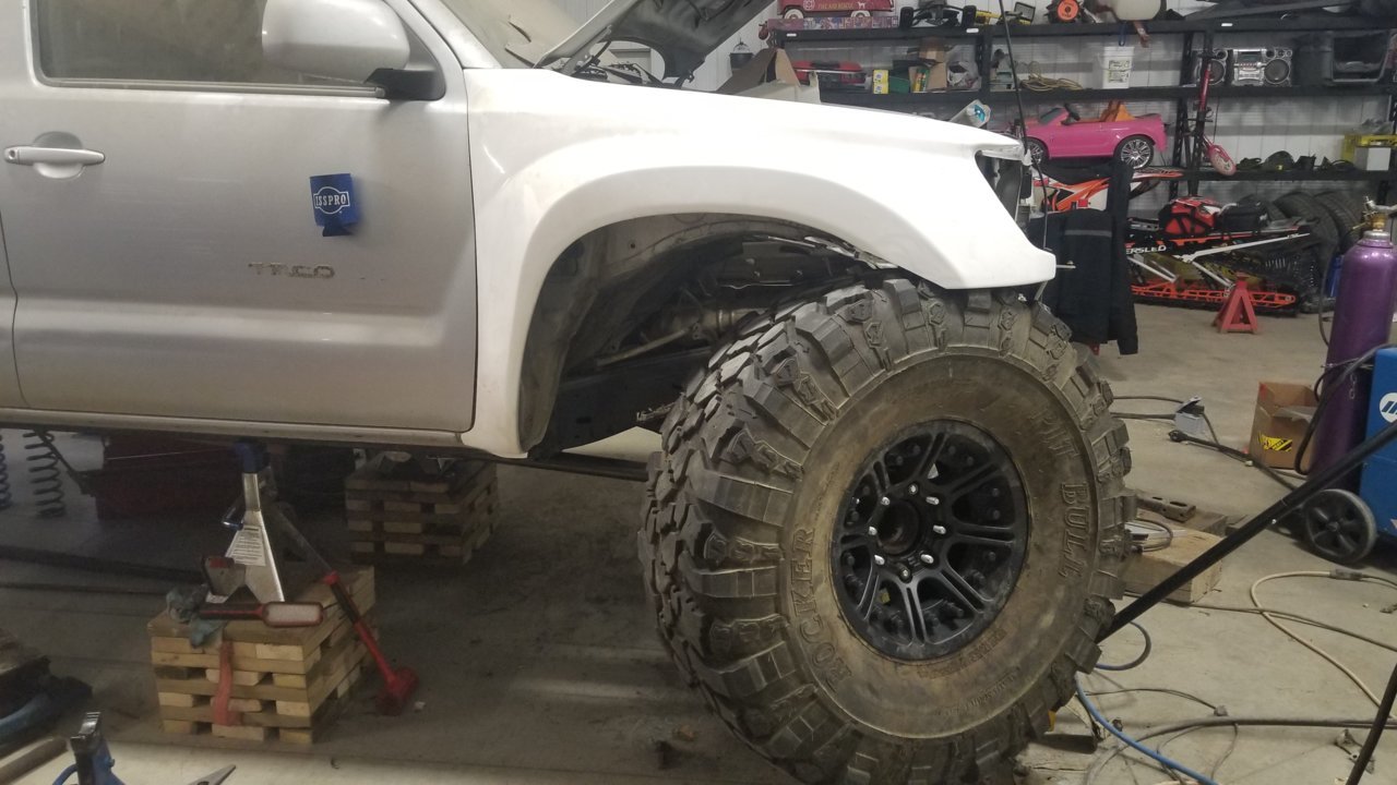

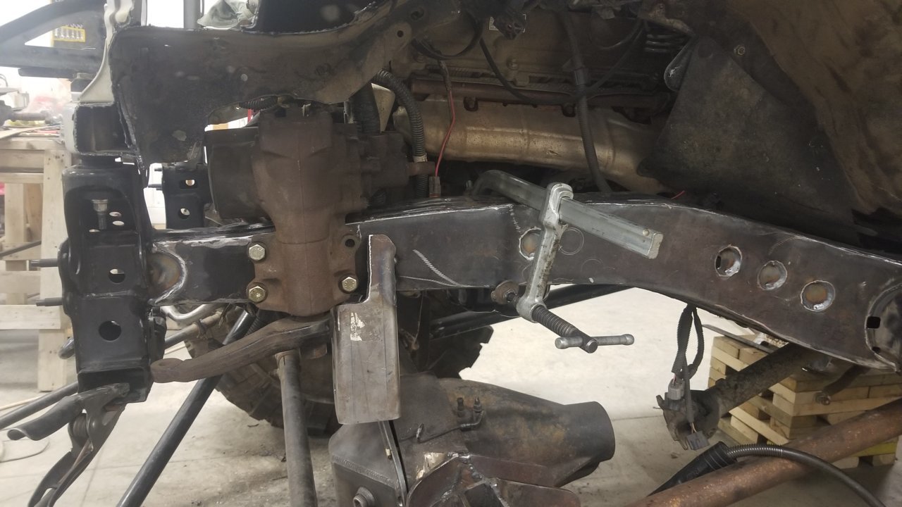

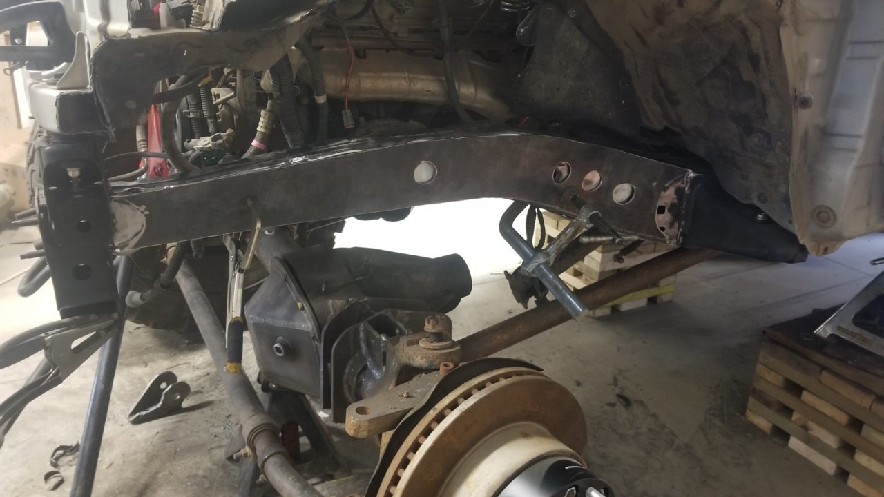

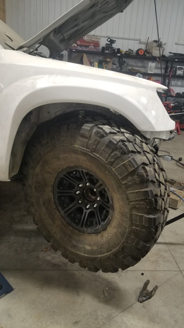

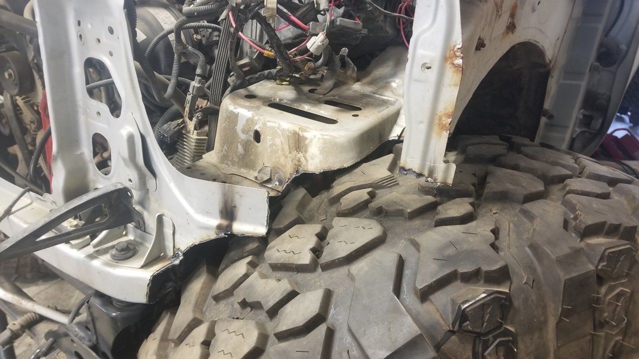

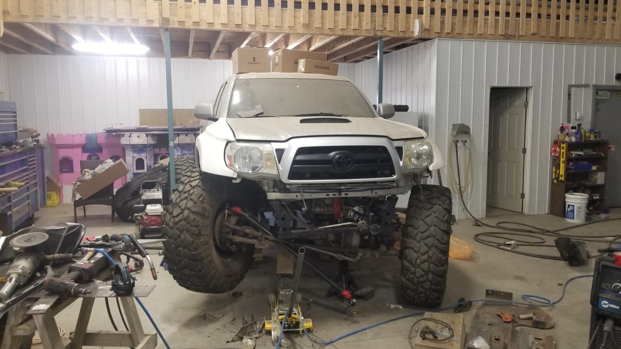

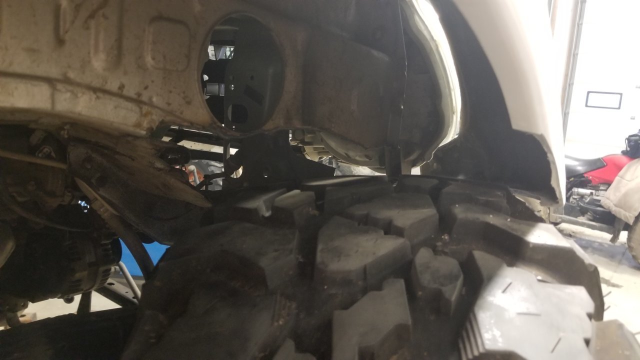

    Clearanced the front end a lot to get good stuff on the 42s. I didn't want to tub the firewall so ended up moving the axle forward to clear and cut till the headlights were getting close to the tires.

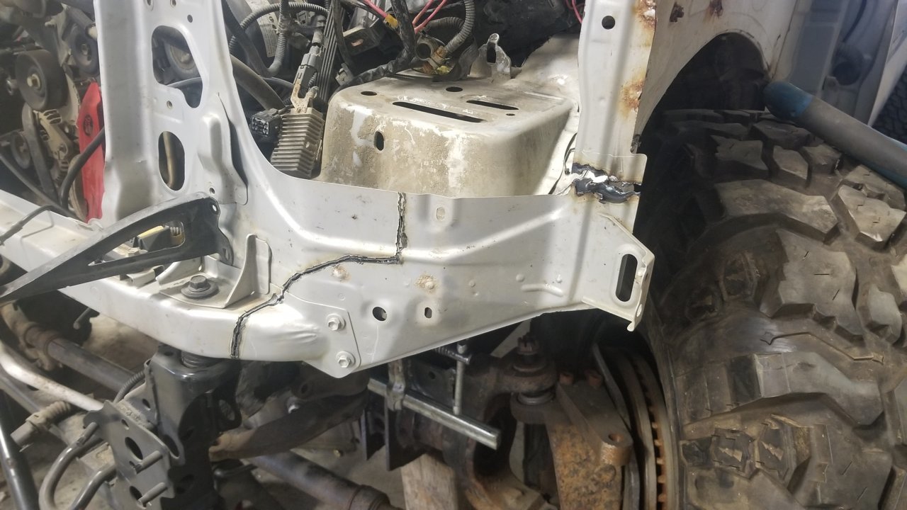

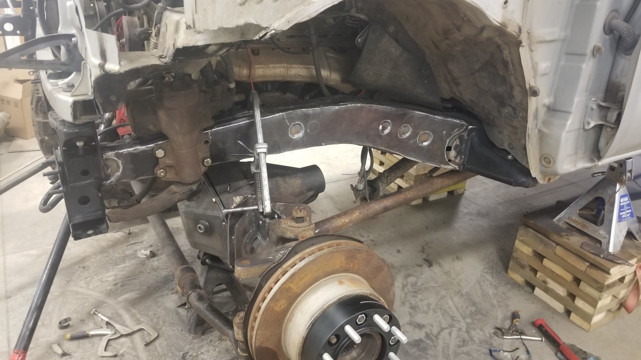

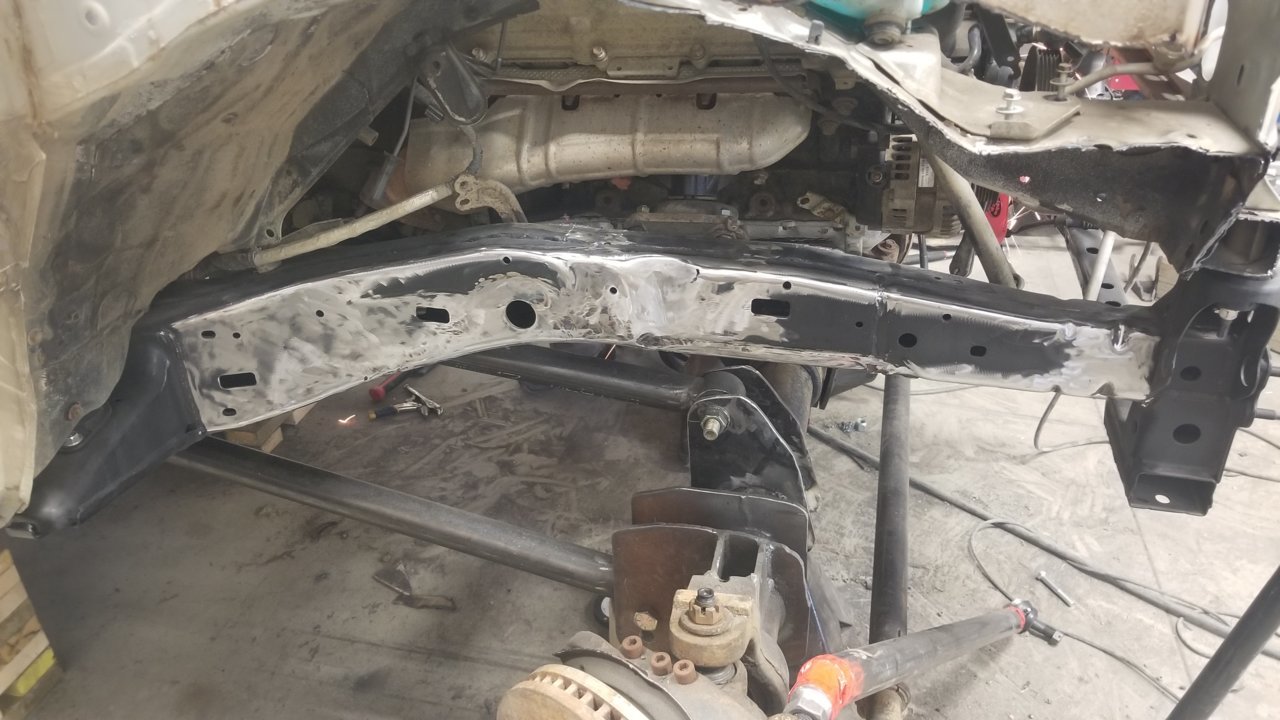

    Got some frame plating welded in and the steering box in place as well as the panhard bar frame mount tacked in and clearanced.

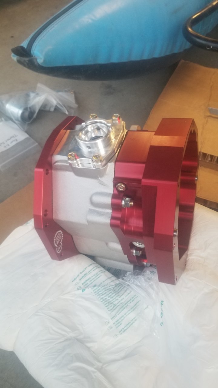

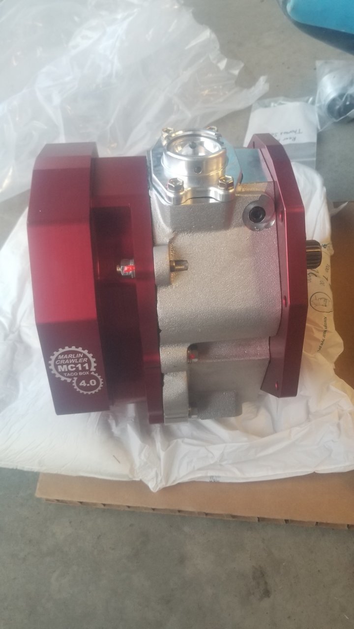

    Just a little update. I haven't done anything major to the project in a while. Been working lots and getting read for a trip to Africa. I did however receive my Crawlbox late summer. I'm hoping to have the truck completely finished by June might be earlier, depends on how much time I get between now and then. But here are some pics of the box. Was nice to finally get it. I spent a lot of the summer wheeling and road tripping around in my 4runner. I really need to get this truck done because I miss hitting the hard trails.
