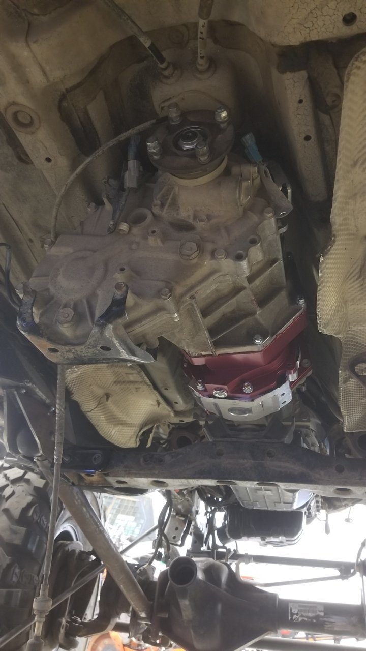

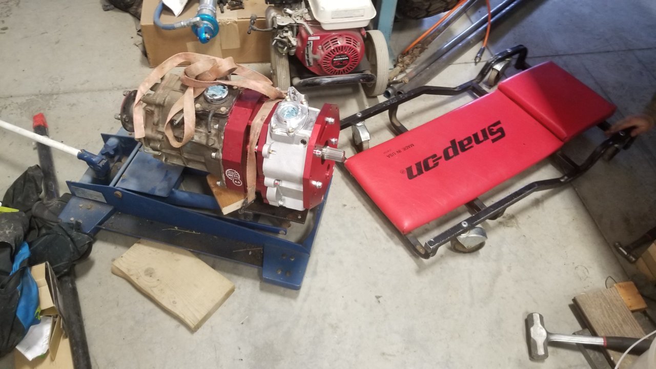

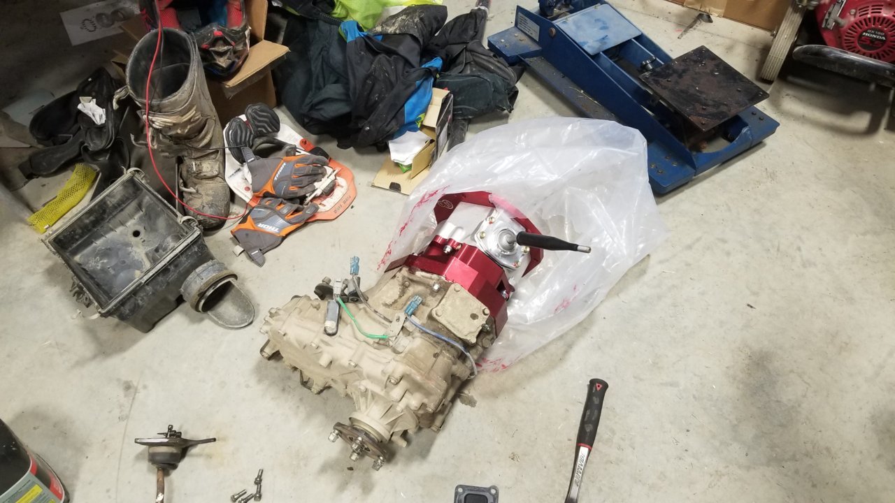

    Anyways got the dual case set up bolted together and installed in the truck, I'll be modifying the skid plate that came off my original Tacoma to work with this set up. Pretty pumped to see it getting closer and closer.

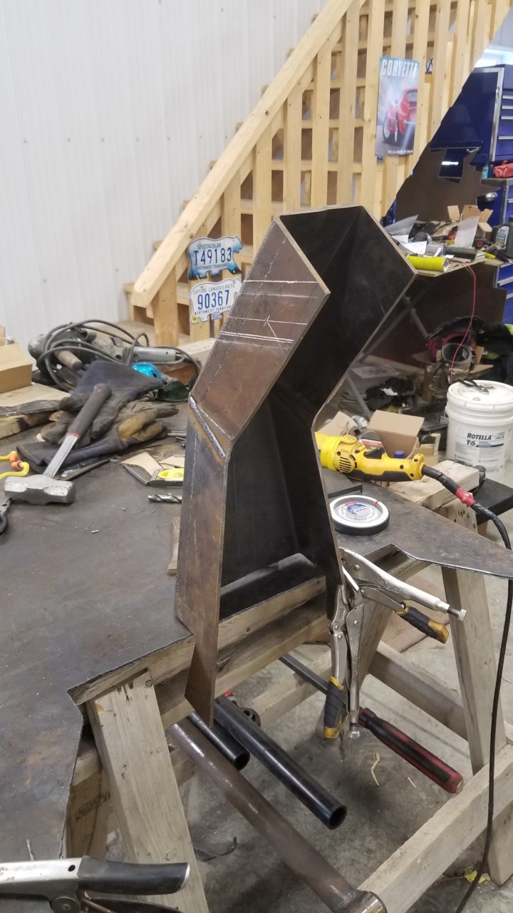

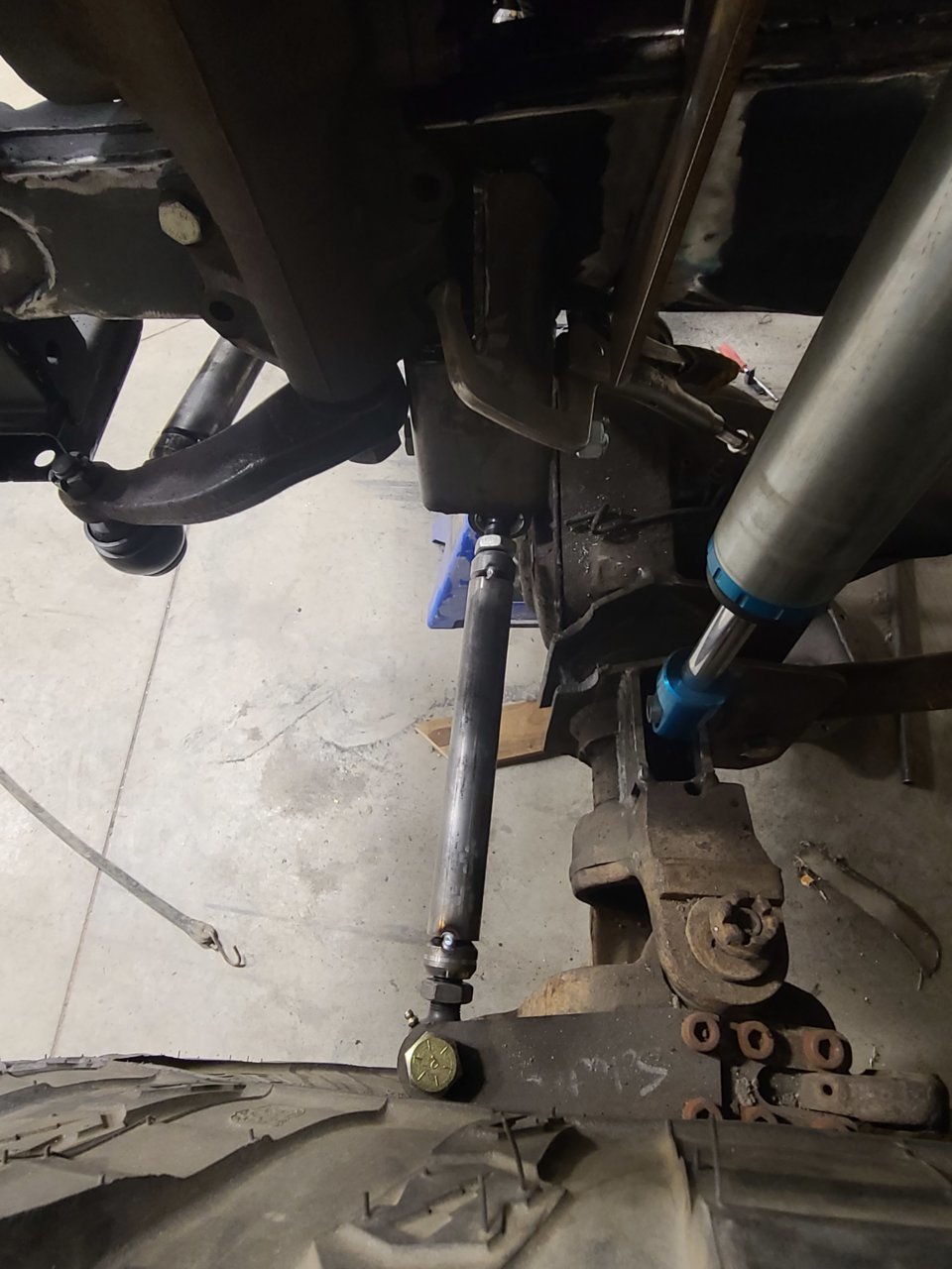

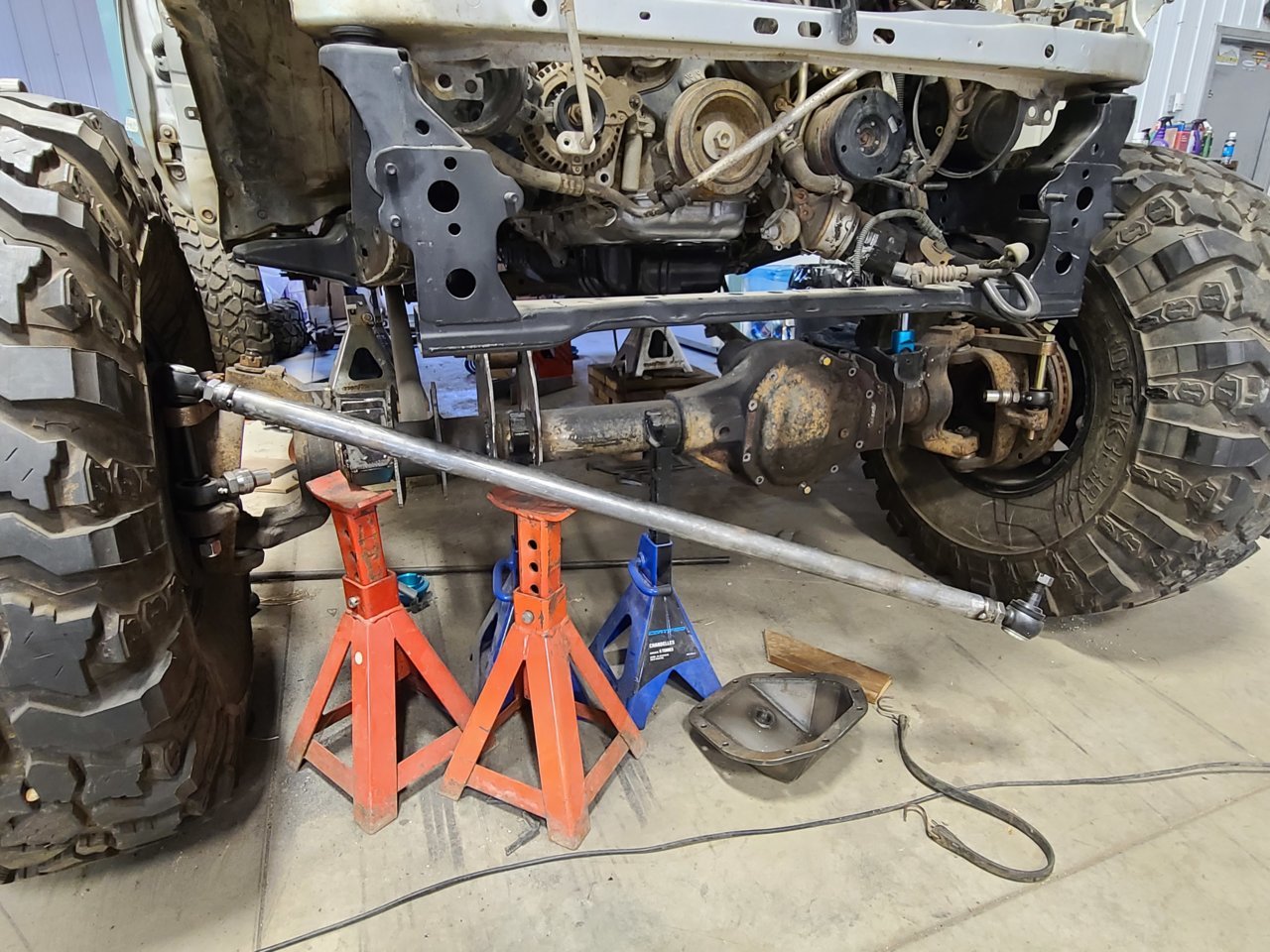

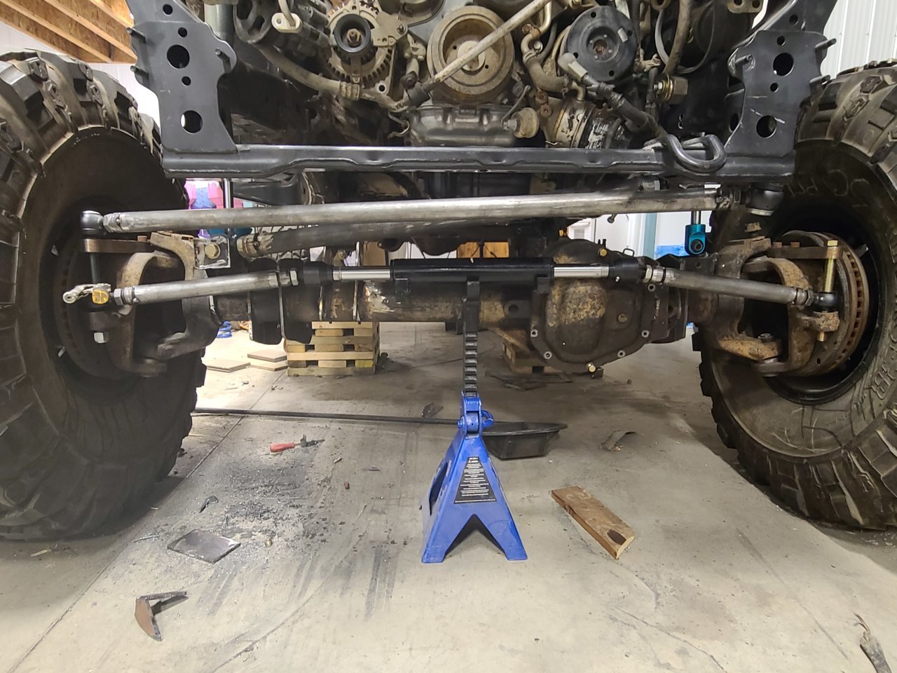

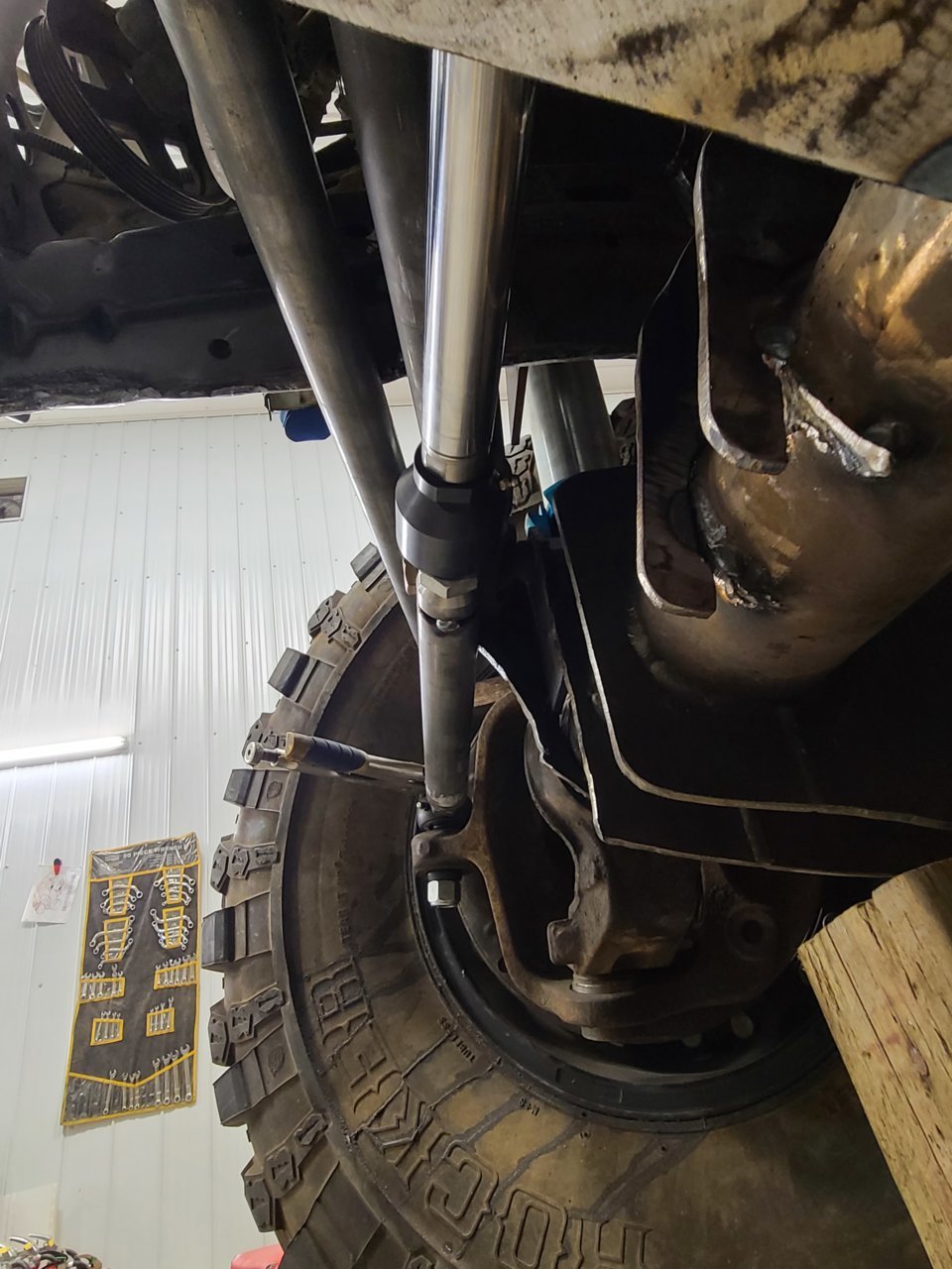

    Alright I made some serious progress on the Tacoma while in quarantine after I spent a month in the US. The front end is ready to be fully welded in and have the front axle assembled. So I ended up having to rework the panhard bar mount shown above.

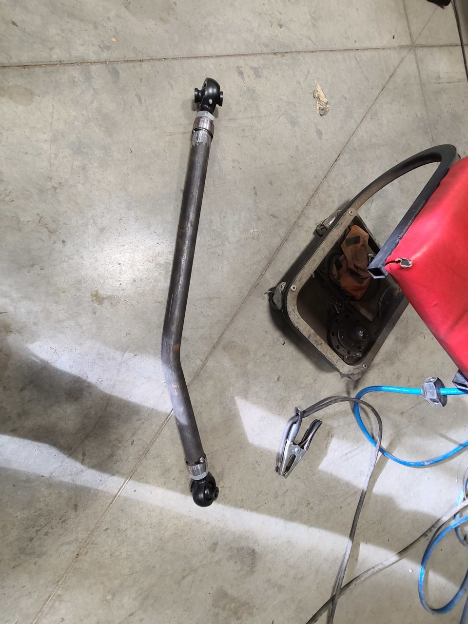

    Panhard bar is using EMF medium heims on both ends due to the angles it will see throughout suspension travel.

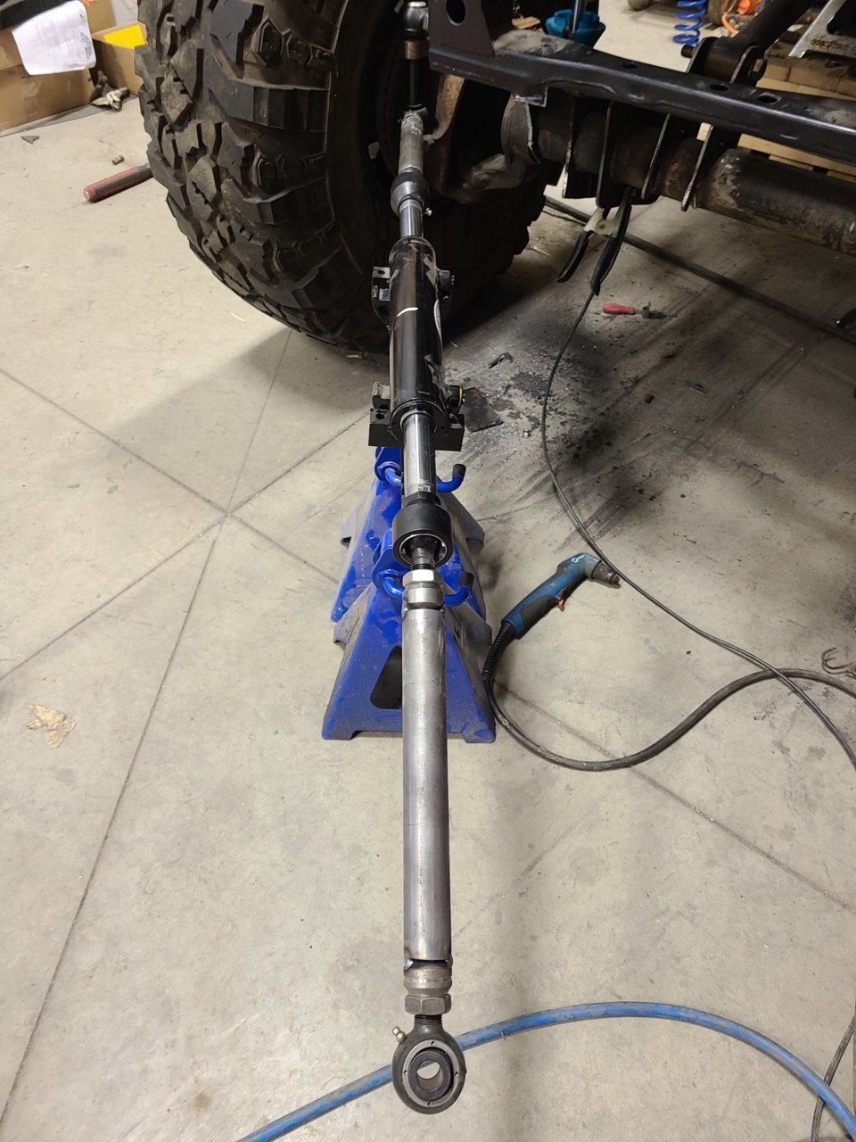

    Next was to measure up and cut the drag link. Uses a custom tie in TRE from EMF and a 1 ton Chevy TRE from EMF. The tube is DOM 0.25" wall.

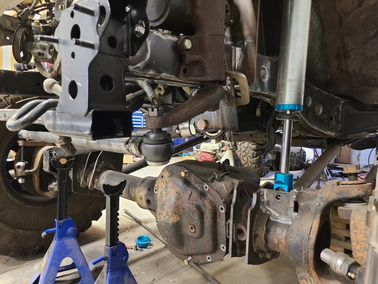

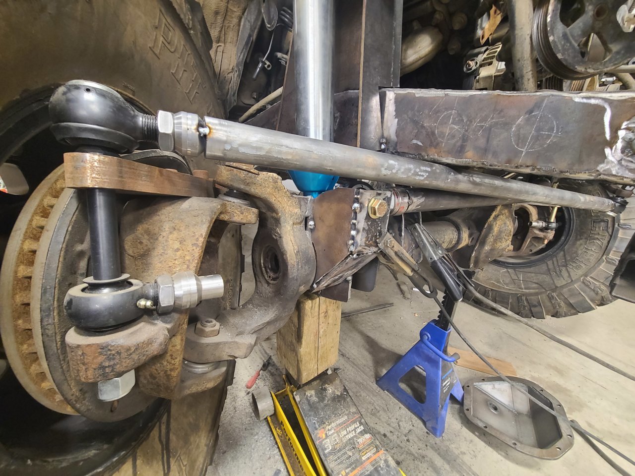

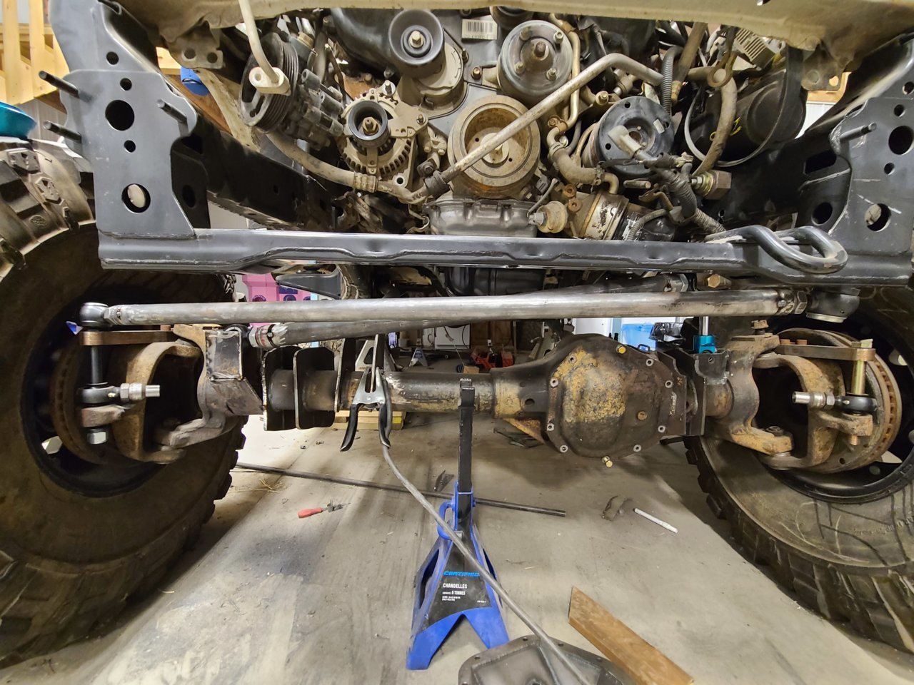

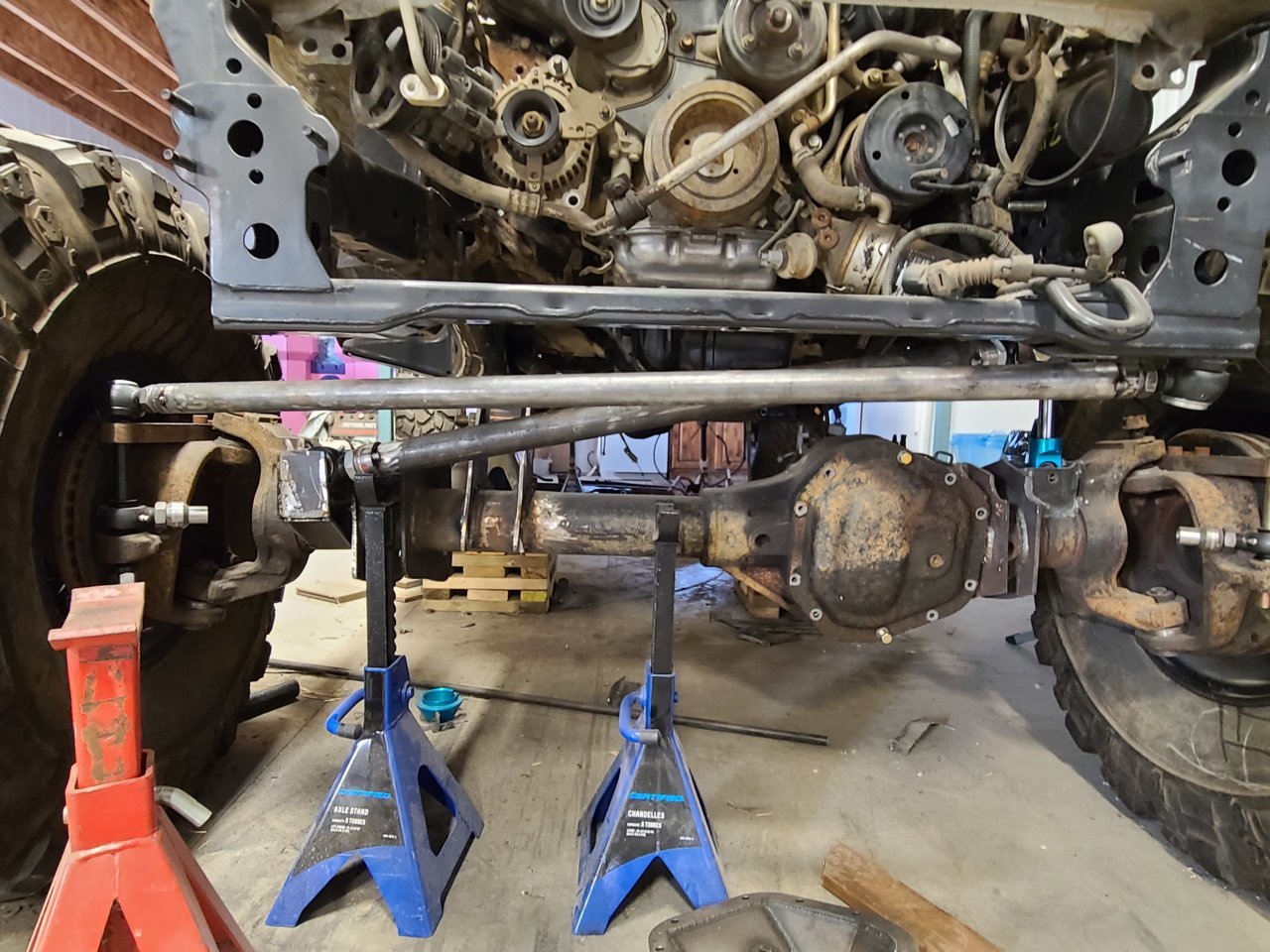

    Next was raising the panhard bar. The angle was pretty steep and when I cycled the suspension there was definitely some room for improvement on the angle. Part of everything was for sure tack, try, cut, improve, tack.
    Here is the original mount. Can see the sharp difference in angles between drag link and panhard.
    The revamped version. It's still not perfect put my lengths are deceptively long so bump steer on the road should be a minimum. If it's really bad I might be able to massage things a little but I won't gain much, I've got such tight clearances, but much better than the first mount.
    A little flex test to see how things are looking. On the plus side I no longer have to notch the frame.
    Hawk373 and 05Taco4x4 like this.

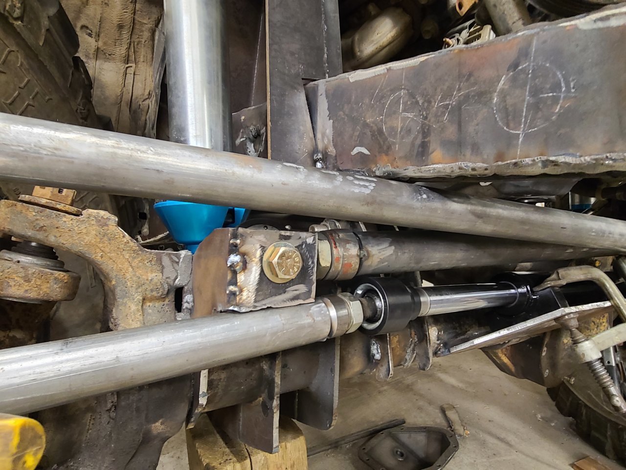

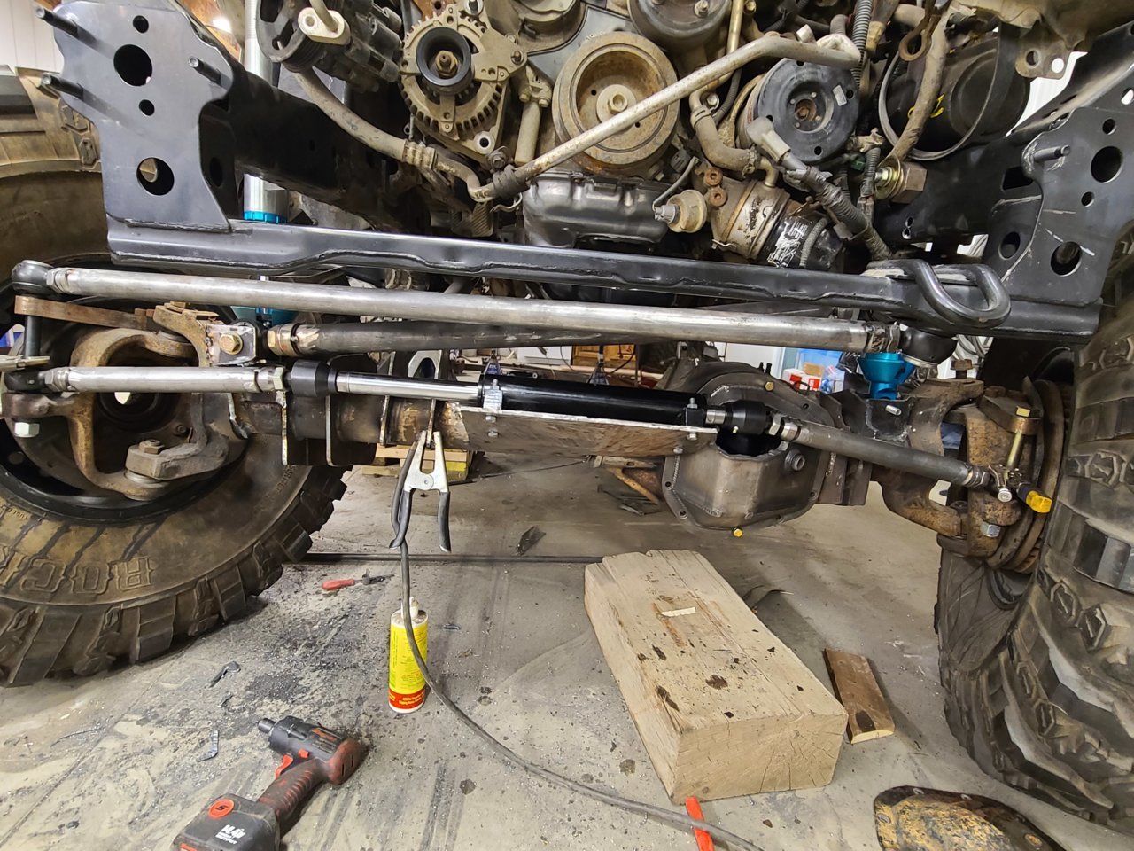

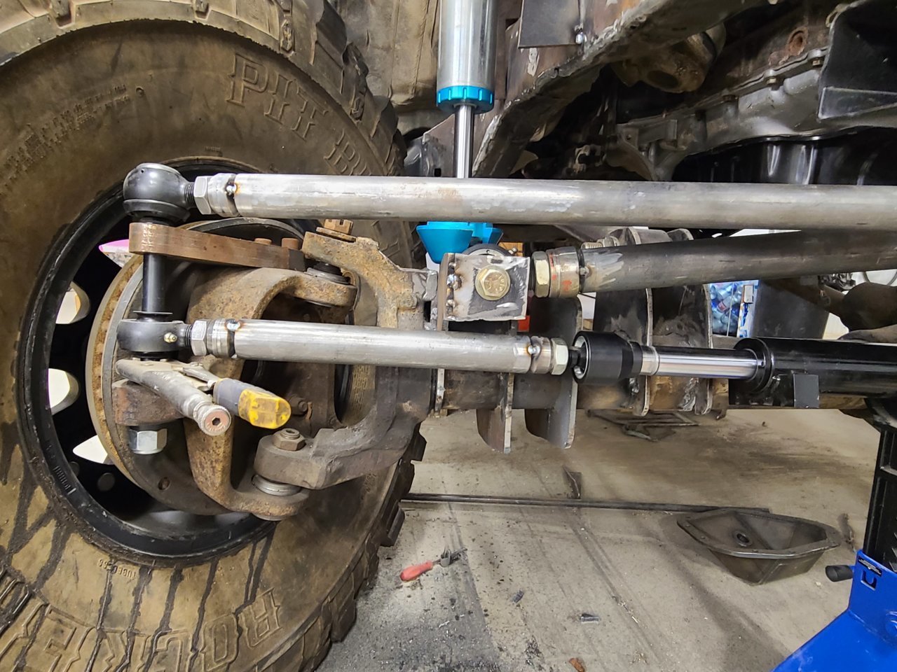

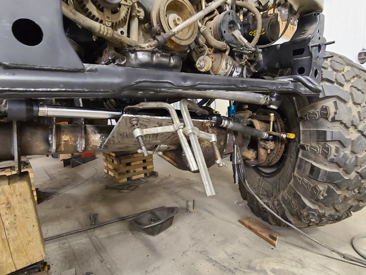

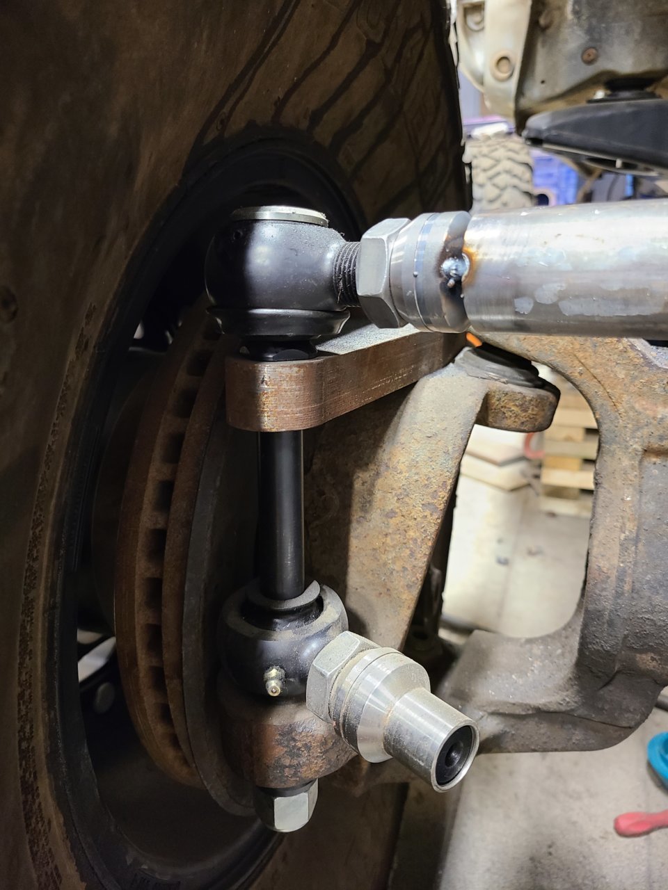

    Next up was the hydro assist with surplus center 1.25"x8" ram. Stayed smaller to keep up the ability to steer quickly and it is just an assist. If it sucks I'll get a 1.5" ram. Used EMF small heims and EMF ball sockets for the steering set up. I've been asked why a double ended ram for assist and the reason for it is to have balanced steering. A single action ram will steer faster one way than the other due to the differences in volume.
    Of course the panhard mount is in the way, so cut it for clearance.
    To get proper angles when using a double ended ram the tie rod arms need to be straight when full lock.
    Next up it was time to check some clearances with everything after cutting out a plate from 1/4" to mount the ram to. The clearances are super tight and I shaved a little more off the panhard mount.
    Hawk373 likes this.

    I used the stock diff cover for mock up because the ruffstuff cover made of 3/8" is huge and will obviously need modification to work. But since I set up with the stock cover I know I can get as close as possible and not hit the gears. More on the Ruffstuff cover later, you can see it laying on the floor in the picture.
    With everything looking good and the steering mount plate positioned, drilled some holes and bolted the ram in place. There will be a ton more bracing to go on this mount. Easier to do all that with the axle out from under the truck and after full flex testing.
    I got a little too greedy with the plasma cutter on the diff cover and welded the chunks removed back onto the cover under the ball socket later on. But I did have to cut a substantial size hole in the cover. Always fun when the bolt on custom parts have to be modified because the build is so ridiculous.
