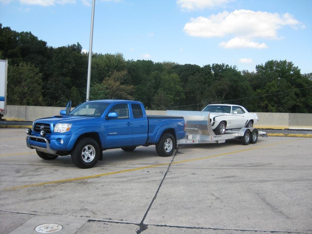

    You will be fine.........towed this around 6000 miles before switching to a Tundra. 5000 pounds and only suffered on very steep mountain passes (had to keep the go pedal to the floor). Factory tow package, air bags, 8 ply tires, electric trailer brakes, no sway control.
