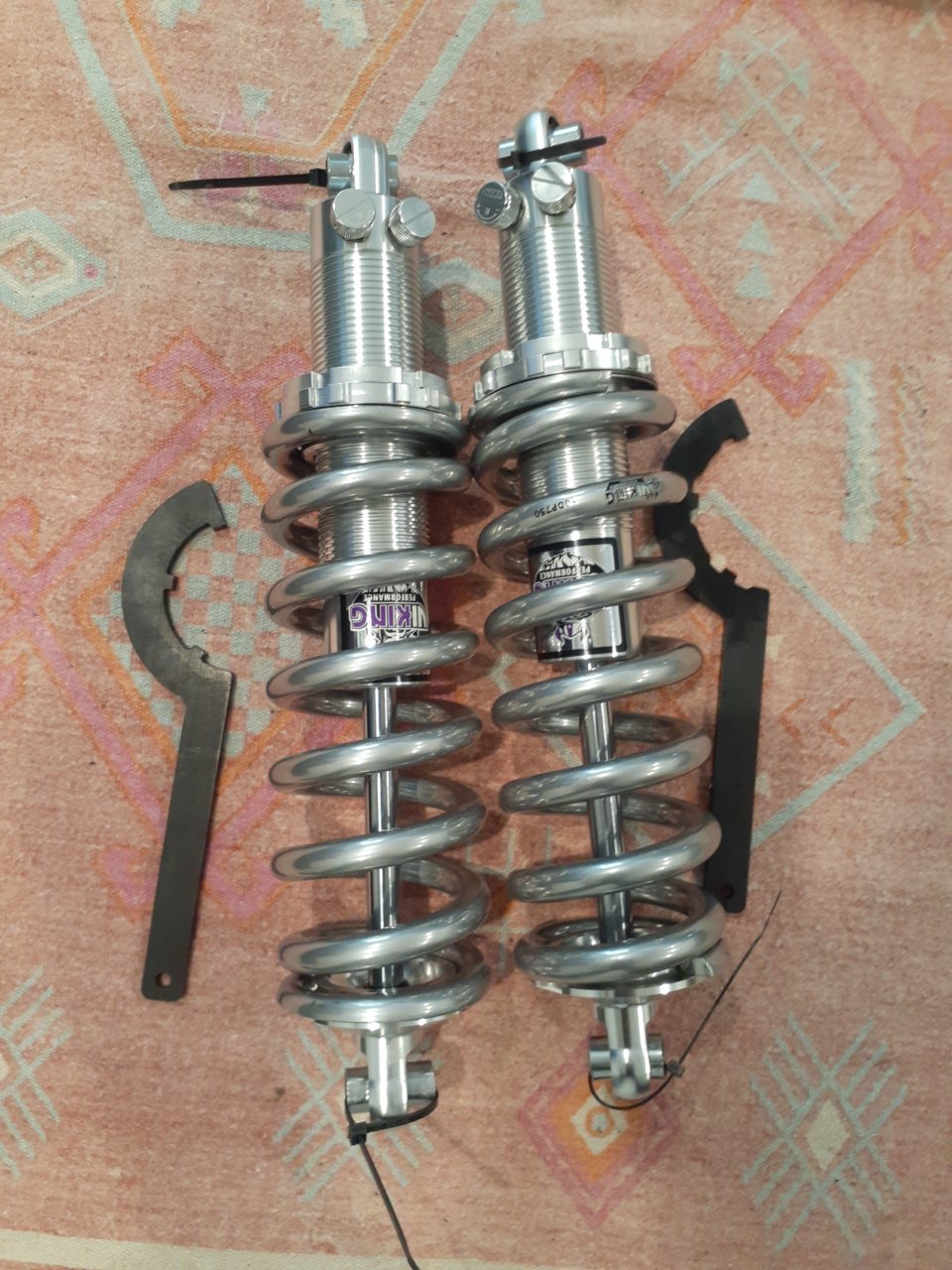

  17. May 10, 2023 at 8:02 AM
    #97
    Waasheem
    Waasheem The catholic radio bear
    Jun 26, 2019
    #297494
    2,792
    Waasheem
    2007 xrunner
    I’m thinking of going with these shocks too. What springs did you choose? Looks like you got the double adjustable? Any issues dealing with strictly street?
